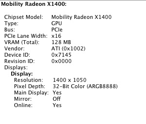

pavle Posted October 1, 2010 Share Posted October 1, 2010 put my edid in and installed all three its reading the x1400 but no qe do i have to enable somehow? This is what my graphics/display says Mobility Radeon X1400: Chipset Model: Mobility Radeon X1400 Type: GPU Bus: PCIe PCIe Lane Width: x16 VRAM (Total): 256 MB Vendor: ATI (0x1002) Device ID: 0x7145 Revision ID: 0x0000 Displays: Display: Resolution: 1280 x 800 Pixel Depth: 32-Bit Color (ARGB8888) Main Display: Yes Mirror: Off Online: Yes whether there is an update for this? tried everything and have no luck :-( Link to comment Share on other sites More sharing options...

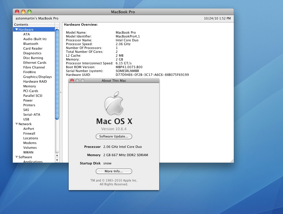

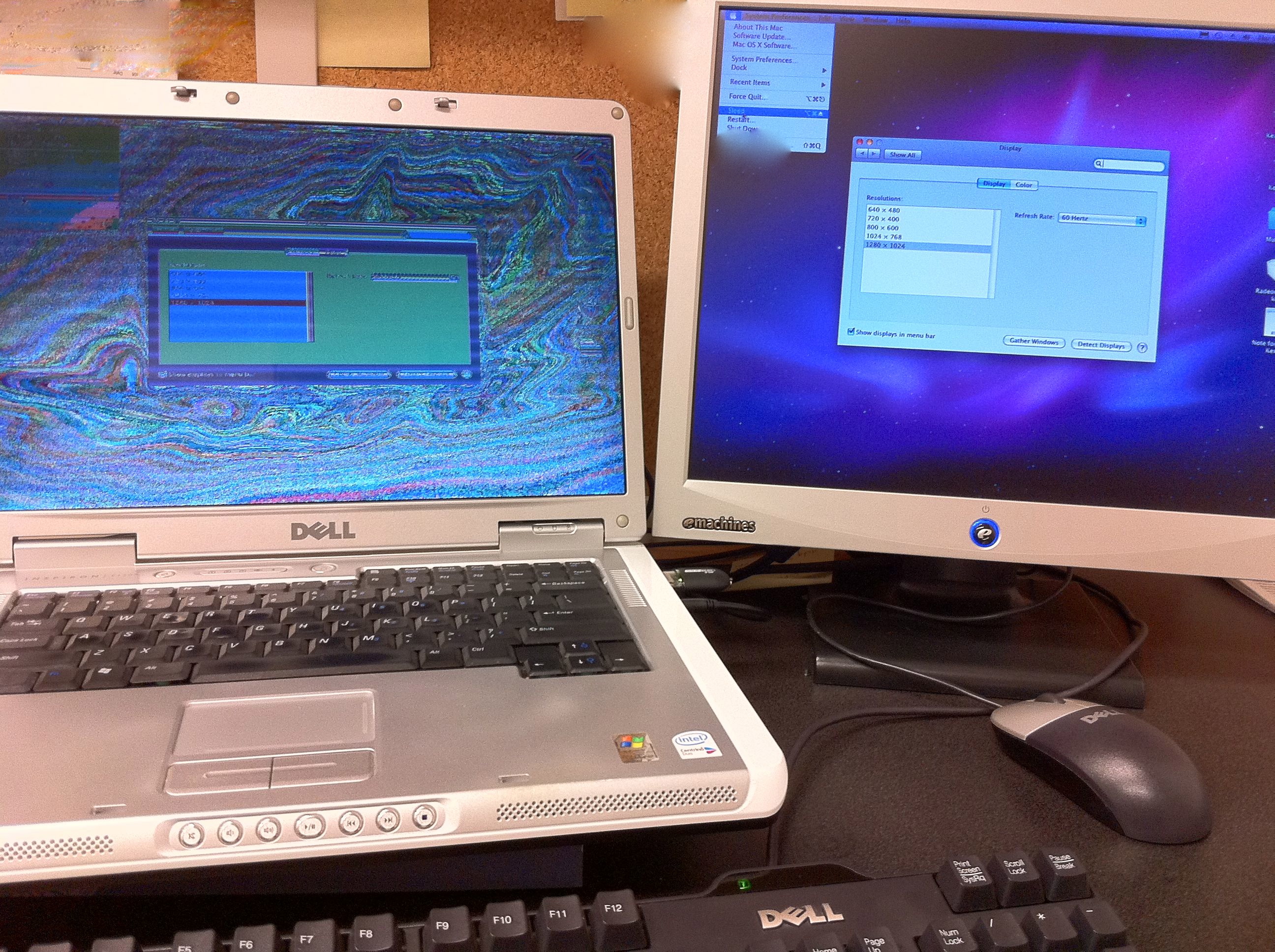

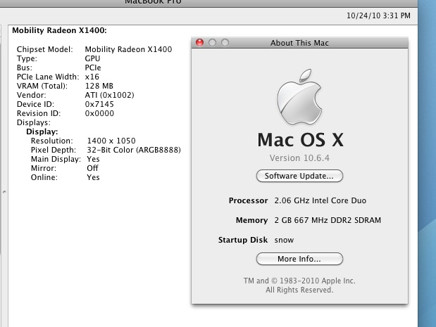

sens331 Posted October 24, 2010 Share Posted October 24, 2010 Hello everyone, I stumbled across the following forum post yesterday (http://www.insanelymac.com/forum/index.php?showtopic=192792) and, while it was for the x1350, I attempted the same steps applied to the x1400...and it worked! So this is what I did. I've tested this with 10.5.7 iAtkos and iDeneb versions. My laptop is an Acer 5672. 1. Download the ATI_Kexts.zip file from here or the aforementioned forum post and extract it. 2. Using any text editor, edit the info.plist file from ATIRadeonX1000.kext and change the following string: from 0x71961002 to 0x71451002 (because the dev id for the Mobility x1400 is 7145. It's 7196 for the x1350. 3. Download a freeware program called softMCCS. This is used to extract your EDID information for placement inside the RadeonHD.kext info.plist. 4. Once downloaded, launch softMCCS and go to file->save EDID as->choose file type "viewsonic EDID file"->save your edid.dat. 5. Open this edid.dat file with any text editor, and remove all the white space from the beginning of the file, and remove the headers and columns (so essentially, you're left with rows and columns of xx data). Now format all of these xx data bits into groups of 8 followed by a space, so you basically have 32 chunks of xxxxxxxx data (xxxxxxxx xxxxxxxx etc...). See the attached files for my modified versions. Heck, these files might even work for you. 6. Now that we've got our modified .dat file, copy and paste all of the 32 chunks, and paste them into the RadeonHD.kext info.plist file, under the section <key>EDID</key><data> 7. Install either flavour of OSX (might work with other versions but I haven't tested this yet). Using the free program KextHelper, first install your modified ATIRadeonX1000.kext, repair disk permissions using Disk Utility, and reboot. 8. Again using KextHelper, then install your modified RadeonHD.kext, repair disk permissions, and reboot. If you get a kernel panic, reboot using -v -f commands. 9. If all boots well, you should now be able to change your screen resolution to 1280 x 800 with QE/CI. The only problem I have now is mouse tearing. But I'm sure that's an easy fix. I just haven't looked into it. Let me know how it goes for you! UPDATE: I've created a PDF guide with images for the above steps. Let me know what you think! LENOVEO T60 10.6.4 it doesn't work on my lenovo T60 x1400 . QE/CI does't work.I have tried all the kexit above but still does't work Link to comment Share on other sites More sharing options...

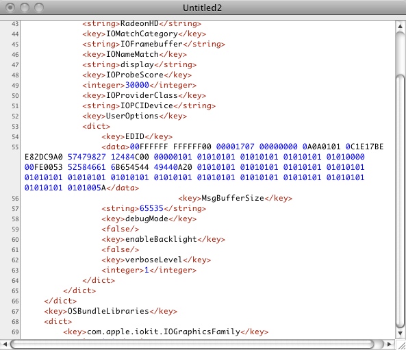

BryanP Posted November 12, 2010 Share Posted November 12, 2010 Here my Kextpackage for 10.6.3. Thanks very much for this. I was able to use your ATIRadeonX1000.kext as it was and the RadeonHD.kext modified with my EDID and it worked like a charm. I may or may not also have a ATISupport kext installed - not sure whether it was necessary or not. Either way, I have 1680x1050 with QE/CI. However, I am trying to get the system running with an external display for an extended desktop. Currently, if I startup the OS with an external monitor plugged into the VGA out, I get a blurred image on my laptop screen and a normal looking screen on the external monitor (see attached picture - you can see that the laptop display replicates the external, but stretched and wildly distorted). If I startup without the monitor attached and plug it in after the system boots, I am unable to detect the attached display. Anyone have ideas? Link to comment Share on other sites More sharing options...

BryanP Posted December 2, 2010 Share Posted December 2, 2010 You should be able to use this kext package here. Modify the RadeonHD kext with your EDID, and leave the ATIRadeonX1000 kext as it is. Original Snowleopard ATIRadeonX1000.kext - only added the correct DEV_ID. RadeonHD from Madchicken in Corp. with Dong (Thanks to you!!!) with added my EDID. Without the edited EDID - i loose my curser. You can extract the EDID with SwitchResX DDC block report generated by SwitchResX version 4.1.1 for display Unbekannter Bildschirm 00FFFFFF FFFFFF00 00001707 00000000 0A0A0101 0C1E17BE E82DC9A0 57479827 12484C00 00000101 01010101 01010101 01010101 01010000 00FE0053 52584661 6B654544 49440A20 01010101 01010101 01010101 01010101 01010101 01010101 01010101 01010101 01010101 01010101 01010101 01010101 01010101 0101005A Here my Kextpackage for 10.6.3. Link to comment Share on other sites More sharing options...
