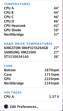

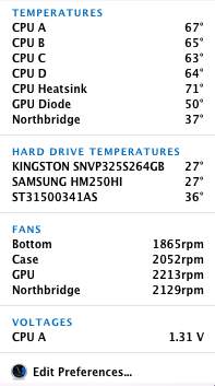

I am just wondering why that iStat picture shows your Vcore as 1.32 V, that seems like a really high voltage for running at stock speed. With that kind of voltage I can raise FSB of my Q9550 from 333 MHz to 470. Maybe you have a chip with really high VID, worst I ever saw was 1.295 but even that would show Vcore as something like 1.26 after vdrop. If you really are using so high Vcore then temps might be a bit high, maybe you could check temps on Windows running Everest or CoreTemp.
edit.
Just saw your edit and if understood correctly that 1.32 V is under load ? If so then that's really high, I'm currently running my cpu at 4.25 GHz and on load my Vcore voltage is only 1.31 V.
Idle:
On load, running Prime95 small FFT's:
I'm actually overclocked (but not as much as my sig shows - I added more RAM - filled the slots, and we all know what that does to core2 quads).
Anyhow, I just clocked back down to stock settings with 1.13vcore and I now have a delta between my heatsink and cores of 20C (reporting 57C for 3/4 cores and 37C for cpu at idle). It's clear that the Tjmax is 10 or 15C lower, and I'm just trying to find out how to change it in the kext. Even if I'm wrong, couldn't someone else want to do this?
Also, I had the vdroop fix enabled in bios when I took that screenshot.

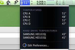

for a lot of you who are wondering about low cpu temps, iStat is showing the cpu diode temp or the "around-cpu" temperature, not the cpu core temp which is about 10° more.
Are you sure? I thought CPU core temp and diode temp were the same thing.
I believe the low temps are because of wrong tjmax calculation by FakeSMCIntelThermal plugin. You can override the calculated value by changing the TJMax key which is 0 by default.

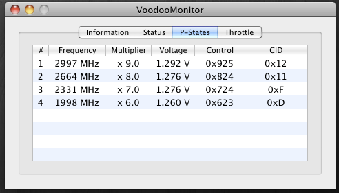

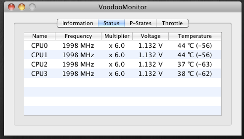

my Q6600 runs 3.0ghz and istat indicates it should be in speedstep (indicated 1.12v!) but cpu-x still reads 3ghz :D
voodoomonitor tells me i'm running 1998 (333x6) speedstep mode @1.13 but cpu-x or sysctl | hw.cpufrequency give me 3ghz actual speed ! :)
don't know really at what speed and voltage i'm running in fact :P

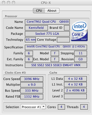

However, i've oc my Q6600 @3,0ghz , iStat indicates 1,12v which would mean it triggered speedstep but it didn't
- temps don't change; @1,12 and running a gentle 1998 temps should go down
- speed is still 3,0ghz (cpu-x and terminal sysctl | hw.cpufrequency check confirm this)
- so voodoomonitor must be wrong, see attached, weird
my conclusion : speedspeed isn't working and i'm running 3ghz, standard vcore (about 1,28v or so).
Any other software with which i could check my cpu voltage ??
CPU-x and sysctl hw.cpufrequency always show the max frequency, even if speedstep is working and current frequency is lower.
