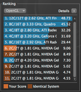

OK so I did a Cinebench OpenGL test as requested by Iaosta, got a terrible OpenGL score (1.54), decided to try it with the NVidia web drivers, got 3.01, AND GPU POWER STATE SWITCHING STARTED TO WORK! It won't work with OS-X drivers, but suddenly it works with NVidia web drivers! What the hell?!?!
EDIT: It wasn't the NVidia web drivers. It was my EXTERNAL MONITOR. It will not clock down if an external monitor is attached. I disconnected it to do the benchmark. This is something I tested before, however at that time something else must also have been wrong... Oh well works now.
Immo

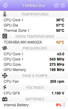

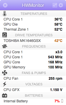

NVIDIA AGPM Switching states depends upon the power source - Battery/Power Adapter ?
In short AGPM switching occurs only in Battery and not in Power Adapter  :|
GPU on Battery switches between 168,100 (Core/Memory) - 275,199 - 475,399 .
Cinebench 11.5 reaches upto 9.06 FPS :dev: .
GPU on Power Adapter stays constant at 275,199.
Cinebench 11.5 reaches upto 4.74 FPS.
AGPM switching to lower state on Battery makes sense, in fact the temperature are lower at lowest state using Nvidia Web Driver (343.01.01f03) , but not switching on Power Adapter is totally weird  like is this the case with Actual Mac’s too ? In that case why wouldn’t some one use their GPU at maximum performance at full power !  Well if it only concerns our 8xxx M cards, it might be because apple mandatorily stopped our cards from using maximum power due to bad die bug ; yet again then why it switches in Battery  :wallbash:

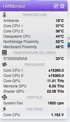

well, I'm on yosemite..What do you think is the betterAGPM kexts and fakesmc to have states working, I've patched the yosemite one and seems to work but in verbose I read bug in process ...I read this thing every time I modify a plist...what is? I've also patched bluetooth to have on/off working from the bar...I've always hated bluetooth couldn't switch..I've patched yosemite one with correct id for our device.
this is
And I don't understand what is the Iasta Patch...is a different fakesmc? is on AGPM ? can you upload the correct kext and an example of how to patch like IndianDragon does? Thanks a lot
IOBluetoothFamily.kext.zip
when I mod AGPM I see a lot of this message in verbose, always identical
11/11/14 12:14:34,000 kernel[0]: BUG in process suhelperd[175]: over-released legacy external boost assertions (1 total, 1 external, 0 legacy-external)
when I mod IOBluetoothfamily very less...but then bluetooth works with on/off switch....what it means?
In HWmonitor I see this  :no: with original AGPM

Added  device id by replacing GFX0, removed IGPU section.
Two states when on power, Three states when on battery as as experimented and concluded few posts above by me and immo.
I'm using latest FakeSMC of Kozlek (HW Sensors) Branch.
and latest Nvidia web driver - http://www.nvidia.com/download/driverResults.aspx/80070/en-us
Note two graphics control kexts loaded are  :
com.apple.driver.AGPM (100.14.37) <114 89 72 71 12 5 4 3>
com.apple.AppleGraphicsDeviceControl (3.7.21) <7 6 5 4 3 1>
Attached  :
AppleGraphicsPowerManagement.kext  (V:100.14.37)
attachicon.gifAppleGraphicsPowerManagement.kext.zip
Changing the device id to your GPU device id should be enough for most of you here.

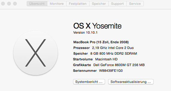

@Indiandragon: Could you explain with a little more detail?  replacing GFX0 in what? Changing the device ID in what?
He is referring to the MacBookPro5,1 section of the AppleGraphicsPowerManagement.kext Info.plist which he replaced with the customized power management
details specific to his NVidia GeForce 8600M GT 256 MB (Vendor: NVIDIA (0x10de)/Device ID: 0x0407) while entirely removing the previously present GFX0 section.
