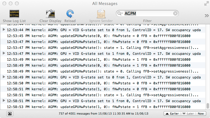

indiandragon Posted June 15, 2013 Share Posted June 15, 2013 AppleGraphicsPowerManagement [Version : 100.12.87] : [How to] Guys, this is how I got the latest AGPM kext working. I did this during 10.8.3 update and it's works fine after 10.8.4 update also. I can confirm the G states are working properly on my 8600m GT and might work on 8400m also. I'm using MacbookPro 5,1 SMBIOS, so my AGPM edit is - <key>MacBookPro5,1</key> <dict> <key>LogControl</key> <integer>1</integer> <key>Vendor10deDevice0407</key> <dict> <key>BoostPState</key> <array> <integer>0</integer> <integer>1</integer> <integer>2</integer> <integer>3</integer> </array> <key>BoostTime</key> <array> <integer>3</integer> <integer>3</integer> <integer>3</integer> <integer>3</integer> </array> <key>Heuristic</key> <dict> <key>ID</key> <integer>0</integer> <key>IdleInterval</key> <integer>250</integer> <key>SensorOption</key> <integer>1</integer> <key>SensorSampleRate</key> <integer>4</integer> <key>TargetCount</key> <integer>1</integer> <key>Threshold_High</key> <array> <integer>57</integer> <integer>70</integer> <integer>88</integer> <integer>100</integer> </array> <key>Threshold_Low</key> <array> <integer>0</integer> <integer>68</integer> <integer>75</integer> <integer>100</integer> </array> </dict> <key>control-id</key> <integer>17</integer> </dict> </dict> Console Output : Attached : Modded AppleGraphicsPowerManagement.kext [Version: 100.12.87] for MacBookPro 5,1(8600m) AppleGraphicsPowerManagement.kext.zip 4 Link to comment Share on other sites More sharing options...
DarwinX Posted June 15, 2013 Share Posted June 15, 2013 AppleGraphicsPowerManagement [Version : 100.12.87] : [How to] Guys, this is how I got the latest AGPM kext working. I did this during 10.8.3 update and it's works fine after 10.8.4 update also. I can confirm the G states are working properly on my 8600m GT and might work on 8400m also. I'm using MacbookPro 5,1 SMBIOS, so my AGPM edit is Until now, I had forgotten and couldn't recall the originator of said AGPM patch. As the author appears to be the indiandragon, I must fully accredit him for its origination. On a side note, patching the AGPM kext thusly versus completely deleting it does allow for smother graphics and slightly lower GPU temperatures. Link to comment Share on other sites More sharing options...
CryzHiss Posted June 17, 2013 Share Posted June 17, 2013 AppleGraphicsPowerManagement [Version : 100.12.87] : [How to] Guys, this is how I got the latest AGPM kext working. I did this during 10.8.3 update and it's works fine after 10.8.4 update also. I can confirm the G states are working properly on my 8600m GT and might work on 8400m also. ---shortened--- AGPM_8600m.png Attached : Modded AppleGraphicsPowerManagement.kext [Version: 100.12.87] for MacBookPro 5,1(8600m) Wow, thank you! I think this fixed the kernel panic I got when reading specific info about my GPU (like in System Profiler or iStat Menus) since I installed ML. I'm not going to revert the changes and check, so either way, I'm blaming you . Thanks again! Link to comment Share on other sites More sharing options...

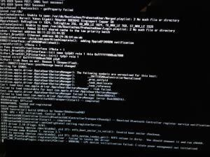

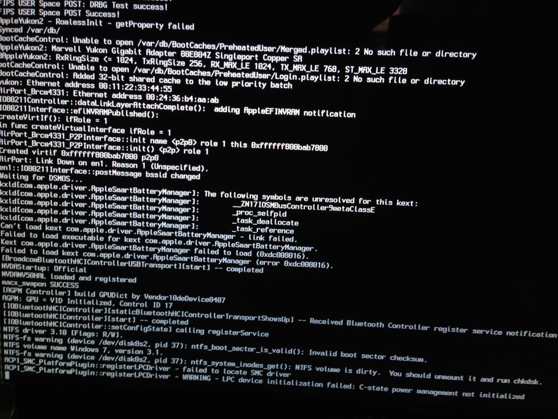

lulighttec Posted July 23, 2013 Share Posted July 23, 2013 Hi Immo, DarwinX, I have in the past gleaned loads of helpful information from these blogs. However, I am still stuck trying to get from 10.8.1 to anything higher. Most recently I have tried to upgrade to 10.8.4, via combo update, but my system hangs right after: ACPI_SMC_PlatformPlugin::registerLPCDriver - failed to locate SMC driver ACPI_SMC_PlatformPlugin::registerLPCDriver - WARNING - LPC device initialization failed: C-state power management not initialized I'm also noticing a problem with the AppleSmartBatteryManager kext not loading, because of a link failure (whatever that means), but that doesn't seem to be keeping things from loading. My most recent steps (because I was having problems with my bootloader not displaying properly, and not changing no matter what flags I used) was to format my drive and do a clean install from 10.8.4 image on a thumbdrive. I am using the bootloader on the thumbdrive, which is the latest version of Chameleon, and my DSDT.aml and plists are the exact ones that DarwinX most recently posted in a zip file for XPS M1530. I was only able to get the installer to boot with -x flag, but the HDD hangs in the same place regardless of the flags used. I have included some pictures, as well as some log files, as I have noticed more than one error during boot, but they go by so fast that it's hard for me to see them all. Other pertinent info: this is a MBR install as I also have Windows 7 on this machine. Immo, I plan to emulate your use of Clover as it sort of fixed my messenger issues. Thanks in advance, LULightTec logs.zip Link to comment Share on other sites More sharing options...
DarwinX Posted July 23, 2013 Share Posted July 23, 2013 Hi Immo, DarwinX, I have in the past gleaned loads of helpful information from these blogs. However, I am still stuck trying to get from 10.8.1 to anything higher. Most recently I have tried to upgrade to 10.8.4, via combo update, but my system hangs right after: ACPI_SMC_PlatformPlugin::registerLPCDriver - failed to locate SMC driver ACPI_SMC_PlatformPlugin::registerLPCDriver - WARNING - LPC device initialization failed: C-state power management not initialized I'm also noticing a problem with the AppleSmartBatteryManager kext not loading, because of a link failure (whatever that means), but that doesn't seem to be keeping things from loading. My most recent steps (because I was having problems with my bootloader not displaying properly, and not changing no matter what flags I used) was to format my drive and do a clean install from 10.8.4 image on a thumbdrive. I am using the bootloader on the thumbdrive, which is the latest version of Chameleon, and my DSDT.aml and plists are the exact ones that DarwinX most recently posted in a zip file for XPS M1530. I was only able to get the installer to boot with -x flag, but the HDD hangs in the same place regardless of the flags used. I have included some pictures, as well as some log files, as I have noticed more than one error during boot, but they go by so fast that it's hard for me to see them all. Other pertinent info: this is a MBR install as I also have Windows 7 on this machine. Immo, I plan to emulate your use of Clover as it sort of fixed my messenger issues. Thanks in advance, LULightTec Ignore the "ACPI_SMC_PlatformPlugin::registerLPCDriver" log messages as we all experience it, and it has nothing to do with your kernel panic. It appears that the AppleACPIPlatform.kext in your system is missing or failing to load. Use the following regressed AppleACPIPlatform.kext version 1.3.6 from the Snow Leopard. The latest AppleSmartBatterManager.kext is also attached. AppleACPIPlatform.kext.zip AppleSmartBatteryManager.kext.zip All Messages.app issues are fully resolved by simply adding the FileNVRAM.dylib to the /Extra/Modules directory of your boot partition. FileNVRAM.dylib.zip Link to comment Share on other sites More sharing options...
LatinMcG Posted July 23, 2013 Share Posted July 23, 2013 the smartbatterymanager error is likely due to old no updated OS. once u update to latests it should go away had same isue with voodoohda 2.7.2 and 10.6.0 untill i updated .. or the platform kext. boot -v -f to force and ignore caches. Link to comment Share on other sites More sharing options...
lulighttec Posted July 24, 2013 Share Posted July 24, 2013 Ignore the "ACPI_SMC_PlatformPlugin::registerLPCDriver" log messages as we all experience it, and it has nothing to do with your kernel panic. It appears that the AppleACPIPlatform.kext in your system is missing or failing to load. Use the following regressed AppleACPIPlatform.kext version 1.3.6 from the Snow Leopard. The latest AppleSmartBatterManager.kext is also attached. AppleACPIPlatform.kext.zip AppleSmartBatteryManager.kext.zip All Messages.app issues are fully resolved by simply adding the FileNVRAM.dylib to the /Extra/Modules directory of your boot partition. FileNVRAM.dylib.zip DarwinX: Are these different than the ones you included in your zip file? Your previous post Link to comment Share on other sites More sharing options...

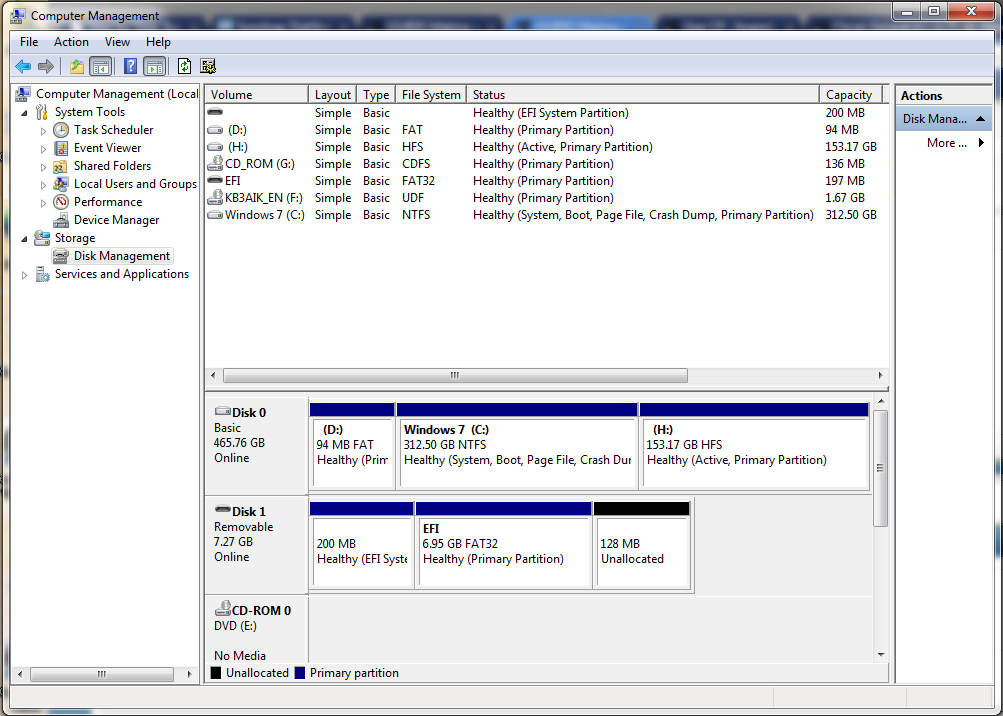

DarwinX Posted July 24, 2013 Share Posted July 24, 2013 DarwinX: Are these different than the ones you included in your zip file? Your previous post No, the kexts are identical. Perhaps your issue is related to the fact that you're running under the MBR. Do you have Windows 7 installed on your primary partition? Link to comment Share on other sites More sharing options...
lulighttec Posted July 24, 2013 Share Posted July 24, 2013 No, the kexts are identical. Perhaps your issue is related to the fact that you're running under the MBR. Do you have Windows 7 installed on your primary partition? They are both Primaries, and OSX is marked as active. In the past it hasn't been a problem. That doesn't sound right when I say it out loud, but you see what the Disk Management shows me. Link to comment Share on other sites More sharing options...
DarwinX Posted July 24, 2013 Share Posted July 24, 2013 They are both Primaries, and OSX is marked as active. In the past it hasn't been a problem. That doesn't sound right when I say it out loud, but you see what the Disk Management shows me. What I meant to ask was if the first partition on your disk were Windows 7, which it is. Generally speaking, dual boot with Windows and OS X can be, at times, quite problematic. Just an FYI, your kernel log contains some abnormal NTFS driver warnings related to the invalid boot sector checksum of your Windows 7 partition. Try booting without all of the unnecessary kexts, including the AppleYukon2.kext and AppleSmartBatteryManager.kext as the latter is preventing the rebuilding of the kernelcache. Which means that your /System/Library/Extensions directory should only contain the FakeSMC.kext without any plugins, AppleACPIPlatform.kext and VoodooPS2Controller.kext. DO NOT use the /Extra/Extensions directory at all! In your org.chameleon.Boot.plist, set the default partition string to hd(0,3) and try using the UseKernelCache=NO option. Also, in your BIOS, ensure that the SATA operation mode is set to the default AHCI mode rather than the ATA mode. Link to comment Share on other sites More sharing options...
lulighttec Posted July 25, 2013 Share Posted July 25, 2013 What I meant to ask was if the first partition on your disk were Windows 7, which it is. Generally speaking, dual boot with Windows and OS X can be, at times, quite problematic. Just an FYI, your kernel log contains some abnormal NTFS driver warnings related to the invalid boot sector checksum of your Windows 7 partition. Try booting without all of the unnecessary kexts, including the AppleYukon2.kext and AppleSmartBatteryManager.kext as the latter is preventing the rebuilding of the kernelcache. Which means that your /System/Library/Extensions directory should only contain the FakeSMC.kext without any plugins, AppleACPIPlatform.kext and VoodooPS2Controller.kext. DO NOT use the /Extra/Extensions directory at all! In your org.chameleon.Boot.plist, set the default partition string to hd(0,3) and try using the UseKernelCache=NO option. Also, in your BIOS, ensure that the SATA operation mode is set to the default AHCI mode rather than the ATA mode. BIOS is set to AHCI, and I did notice that NTFS is mounting dirty, which I will need to take care of, but actually I found the problem. I have been booting into Single User Mode to make changes to the kexts, and in trying to mount one of the partitions, it caused the system to boot a little more than it normally would for Single User Mode, and moved past some of the other errors. After I was done replacing kexts, and exited S.U.M., when the system tried to continue to boot, I realized that it was actually hanging right after "Waiting for DSMOS to arrive..." I did a little research, and found that it was related to problems with FakeSMC.kext. There was something wrong with the FakeSMC.kext that was included in your zip file. I downloaded the latest version and used it to replaced the existing one, and it booted right up. I'm not sure what was wrong with the one in your zip, but... well there you have it. Now, about that NTFS partition... I should just run chkdsk on it, set to fix errors, correct? Also, regarding messages... I put the FileNVRAM.dylib in the folder that you said to, but now messages won't let me sign in with my apple ID. It just repeatedly asks me for my password. Thoughts? I haven't yet installed a bootloader on the partition, so I have options. One other thing: I can't seem to get Chameleon to display a gui and stop giving me verbose boots, no matter what options or flags I use, or what is in the plist. However, I am that much closer! :-) I am very happy right now. And thanks for both the direct and indirect guidance! -LULightTec Edit: One more thing: I stopped using the Extra/extensions folder a long time ago... Edit 2: Apparently it won't log into facebook either; settings keeps rejecting my login, even though facebook registers that I have logged in from OSX. Edit 3: Upon reboot, OSX showed me as logged into facebook. Link to comment Share on other sites More sharing options...
DarwinX Posted July 25, 2013 Share Posted July 25, 2013 BIOS is set to AHCI, and I did notice that NTFS is mounting dirty, which I will need to take care of, but actually I found the problem. I have been booting into Single User Mode to make changes to the kexts, and in trying to mount one of the partitions, it caused the system to boot a little more than it normally would for Single User Mode, and moved past some of the other errors. After I was done replacing kexts, and exited S.U.M., when the system tried to continue to boot, I realized that it was actually hanging right after "Waiting for DSMOS to arrive..." I did a little research, and found that it was related to problems with FakeSMC.kext. There was something wrong with the FakeSMC.kext that was included in your zip file. I downloaded the latest version and used it to replaced the existing one, and it booted right up. I'm not sure what was wrong with the one in your zip, but... well there you have it. Now, about that NTFS partition... I should just run chkdsk on it, set to fix errors, correct? Also, regarding messages... I put the FileNVRAM.dylib in the folder that you said to, but now messages won't let me sign in with my apple ID. It just repeatedly asks me for my password. Thoughts? I haven't yet installed a bootloader on the partition, so I have options. One other thing: I can't seem to get Chameleon to display a gui and stop giving me verbose boots, no matter what options or flags I use, or what is in the plist. However, I am that much closer! :-) I am very happy right now. And thanks for both the direct and indirect guidance! -LULightTec Edit: One more thing: I stopped using the Extra/extensions folder a long time ago... Edit 2: Apparently it won't log into facebook either; settings keeps rejecting my login, even though facebook registers that I have logged in from OSX. Edit 3: Upon reboot, OSX showed me as logged into facebook. I am glad to hear that you have managed to resolve your system issues, and yes, the chkdisk command ought to do the trick. As far as the Messages.app, did you reboot upon placing the FileNVRAM.dylib into the /Extra/Modules directory? Also, do you have the EthernetBuiltIn=YES entry in your org.chameleon.Boot.plist? If so, then generate a new SMBios.plist serial via either the Champlist.app or the Chameleon Wizard.app then reboot. Failing that, follow this guide by the Rampage Dev: Create a Recovery Partition And Enable All Features Of iCloud and iMessages Removing the -v kernel flag from the org.chameleon.Boot.plist of your root partition should disable the verbose boot. Link to comment Share on other sites More sharing options...
