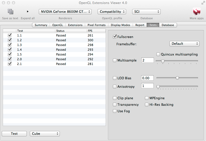

indiandragon Posted September 14, 2012 Share Posted September 14, 2012 Guys how is the performance of 8600M GT after the 10.8.1 Update ? My Nvidia 8600 M GT (256MB) is giving low performance since 10.8.1 update, I patched AGPM and G states seems to be working but performance is still very low compared to 10.8.0 . This is my Open GL results with 10.8.0 (Non patched AGPM) This is my Open GL results with 10.8.1 (Patched AGPM) [slightly better results than 10.8.1 without patched AGPM] This is my kernel Log right after Open GL Test Sep 14 22:20:06 localhost kernel[0]: AGPM: GPU = VID G-state set to 0 from 0, ControlID = 17. SW occupancy updated. Sep 14 22:20:07 localhost kernel[0]: AGPM: updateGPUHwPstate(1, 0): fHwPstate = 0 fFB = 0xffffff800c42a000 Sep 14 22:20:07 localhost kernel[0]: AGPM: updateGPUHwPstate(): state = 1. Calling fFB->setAggressiveness()... Sep 14 22:20:07 localhost kernel[0]: AGPM: GPU = VID G-state set to 1 from 0, ControlID = 17. SW occupancy updated. Sep 14 22:20:09 localhost kernel[0]: AGPM: updateGPUHwPstate(2, 0): fHwPstate = 1 fFB = 0xffffff800c42a000 Sep 14 22:20:09 localhost kernel[0]: AGPM: updateGPUHwPstate(): state = 2. Calling fFB->setAggressiveness()... Sep 14 22:20:09 localhost kernel[0]: AGPM: GPU = VID G-state set to 2 from 1, ControlID = 17. SW occupancy updated. So, My G - States seem to work correct. BTW, This is my patch in the AGPM, <key>MacBookPro7,1</key> <dict> <key>LogControl</key> <integer>1</integer> <key>Vendor10deDevice0407</key> <dict> <key>BoostPState</key> <array> <integer>0</integer> <integer>1</integer> <integer>2</integer> <integer>3</integer> </array> <key>BoostTime</key> <array> <integer>3</integer> <integer>3</integer> <integer>3</integer> <integer>3</integer> </array> <key>Heuristic</key> <dict> <key>ID</key> <integer>0</integer> <key>IdleInterval</key> <integer>250</integer> <key>SensorOption</key> <integer>1</integer> <key>SensorSampleRate</key> <integer>4</integer> <key>TargetCount</key> <integer>1</integer> <key>Threshold_High</key> <array> <integer>57</integer> <integer>70</integer> <integer>88</integer> <integer>100</integer> </array> <key>Threshold_Low</key> <array> <integer>0</integer> <integer>68</integer> <integer>75</integer> <integer>100</integer> </array> </dict> <key>control-id</key> <integer>17</integer> </dict> </dict> P.S - Installed CUDA Drive 5.0.24, does not help in performance. Anyone else having same issues ? Those who have 8600m GT, please post your Open GL Benchmarks. Link to comment Share on other sites More sharing options...
LatinMcG Posted September 15, 2012 Share Posted September 15, 2012 u using smbios.plist of MacBookPro7,1 ?? i wonder what is closest matching gstates in the AGPM kext.. maybe shift it to the proper smbios model besides the device id... and the control id i wiped my inspiron 1520 and windowzed/Linuxed it.. for sale to relative.. still have desktop G31M-ES2L rev 1. Link to comment Share on other sites More sharing options...
indiandragon Posted September 15, 2012 Share Posted September 15, 2012 u using smbios.plist of MacBookPro7,1 ?? i wonder what is closest matching gstates in the AGPM kext.. maybe shift it to the proper smbios model besides the device id... and the control id i wiped my inspiron 1520 and windowzed/Linuxed it.. for sale to relative.. still have desktop G31M-ES2L rev 1. Actual closest SMBios should be MacBookPro 3,1 but it doesn't allow CPU throttling in my T7250 and AGPM doesn't have MBP 3,1 in it. Anything above MacBookPro 5,1 works for me. I chose MBP7,1 as everything was working fine except of course for LPC and Shutdown. In fact the first Open GL benchmark was taken with the same smbios and now I do not have any idea on how the Open GL scores went this low, also 10.8.1 have the same graphics kexts. BTW, LatinMcG if you sold your 1520 you could have done with OSX right ? Surely would have added more value !! Link to comment Share on other sites More sharing options...

indiandragon Posted September 16, 2012 Share Posted September 16, 2012 Yep guess dell messed up BIOS, btw you have idea on your Open GL scores before your removed OSX? No one else have posted the scores yet. Link to comment Share on other sites More sharing options...
LatinMcG Posted September 16, 2012 Share Posted September 16, 2012 nope never bothered to check it. Link to comment Share on other sites More sharing options...
