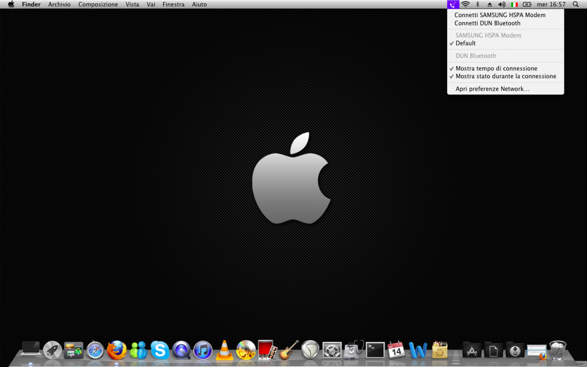

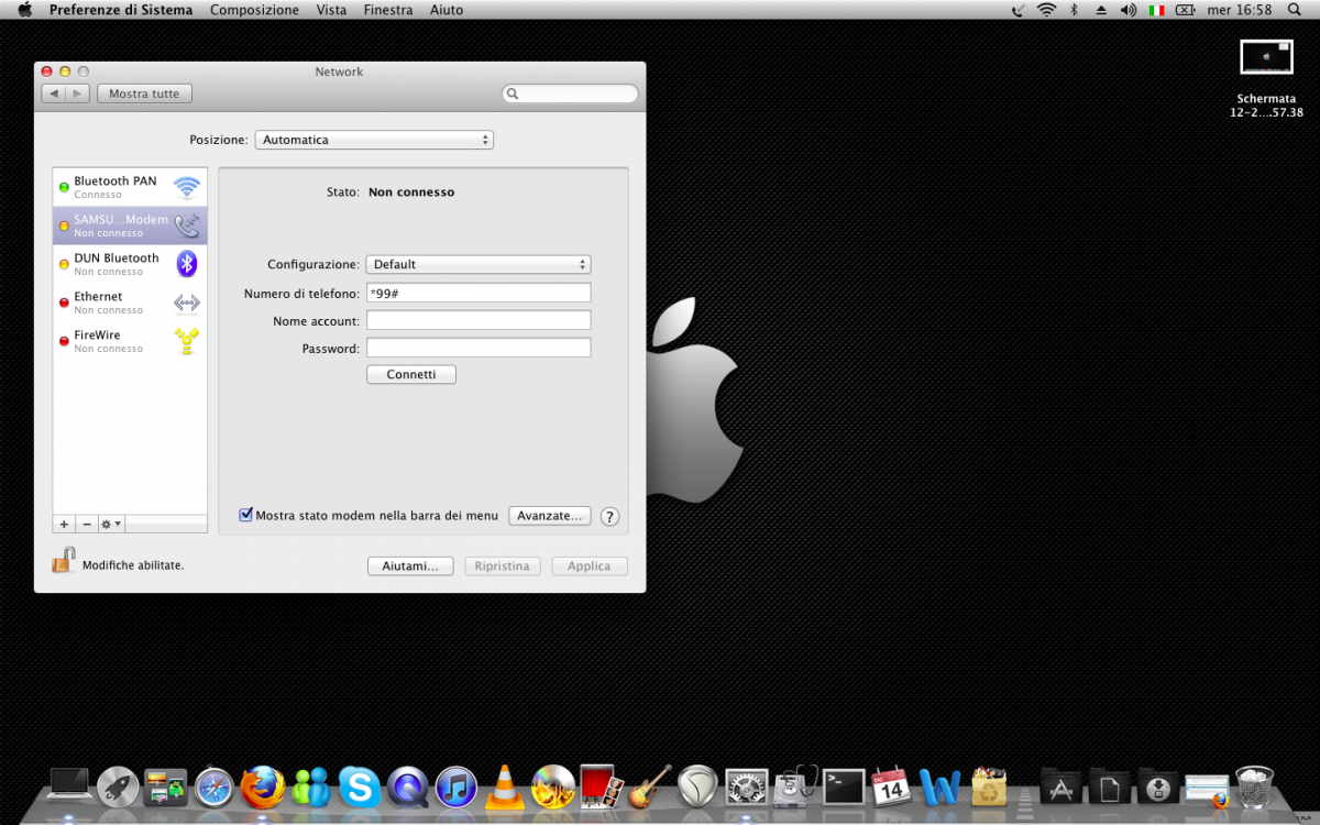

raimdal Posted December 14, 2011 Share Posted December 14, 2011 Because of my english it's not good I'm not shure if you say it's better or not...It seems to me that you say it's better...If so I'm happy for you. I have , a good news but I will test better in the next days, Today the nc10 netbook of a friend of mine it's dead and he give to me the wwan samsung y3100, I had read in topics on this netbook that it doesn't work but that netbook was related to leopard...so I've inserted the card without any hope...but look at the picture...I think it's working but now I don't have the possibility to test with the sim because I have not money enough on the sim...I'm waiting to see my girl-friend who have an internet-key wind..I think it's working like I see...but I'll wait to connect really..If the test will be positive I will tell you so you can insert into the list of hardware working out of the box. I'm sorry if this is not the right place for this news, in that case can you move this post in the right place? thank you Link to comment Share on other sites More sharing options...

raimdal Posted December 20, 2011 Share Posted December 20, 2011 samsung y3100 works out of the box in lion... Link to comment Share on other sites More sharing options...
LatinMcG Posted December 20, 2011 Share Posted December 20, 2011 samsung y3100 works out of the box in lion... ahh wwan mobile broadband device. nice Link to comment Share on other sites More sharing options...
