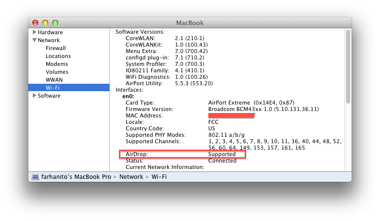

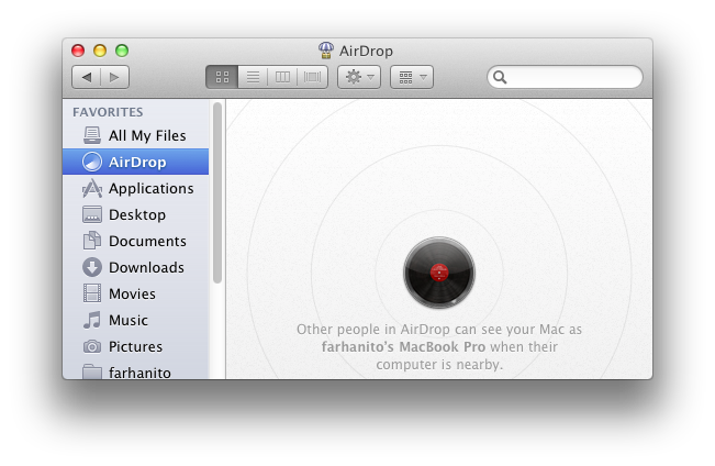

farhanito Posted September 18, 2011 Share Posted September 18, 2011 just want to share some info that this hint about enabling AirDrop on Lion from http://hints.macworld.com/article.php?stor...110913213649565 is apparently working with my dell wireless 1490 (reflashed to airport extreme) havent tested the functionality yet since i've only got one Lion system running Link to comment Share on other sites More sharing options...
