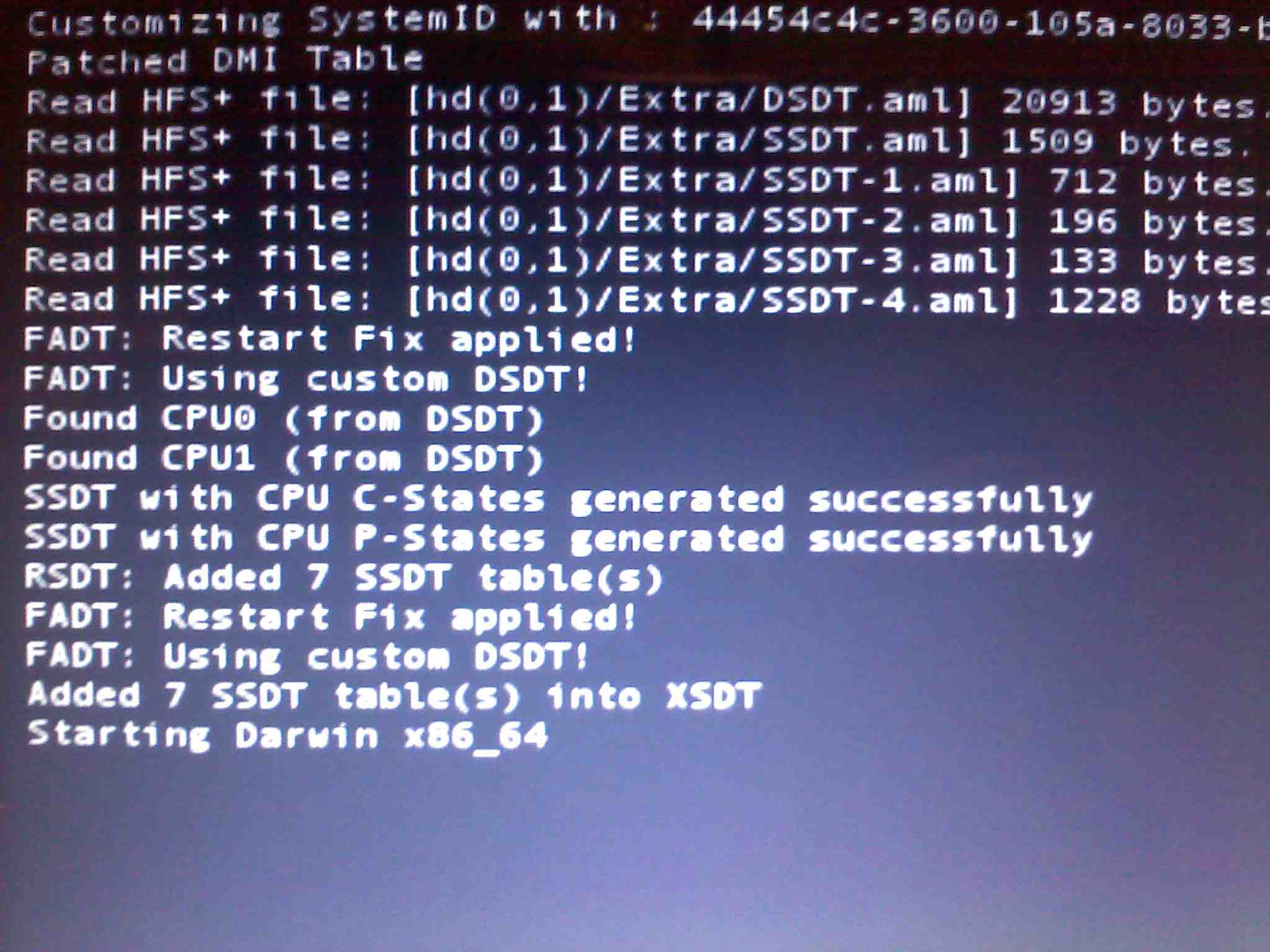

C and P states are now enabled. I added the Scope (_PR) to the beginning of the DSDT script and those Invalid Characters Found in the ProcessorOP! are gone. Snippet of the location of the _PR in the DSDT below.
CPU C and P states are generated successfully see image below.
LPC Warning has not gone away

All I did is move my Scope(_PR) all the way to the top of the DSDT, other than that the DSDT is a 100% copy of Brett Whinnen Non Specific CPU for the Nvidia M8600 from the first post.
I just read today that the new revision of Mojodojo's Chameleon has a fix for the Scope _PR position so don't worry about moving it with the lastest Rev.
With CoolBook I see voltages on the right but all 0's for frequency on the left and nothing in the bottom left fields.
I did not do any mods for FakeSMC and SUperIO in my DSDT to get iSTAT pro to give me CPU and GPU Diode Temp. readings. If you use the ACPIMon instead there is some script you need to add to your DSDT. I am working on this today so I can get Fan speed and Northbridge Temps like Slice iSTAT shows.
The SSDT tables are from Ubuntu just rename all 5.
SSDT_r1-PmRef-Cpu0Cst-3001-INTL-20050624.aml
SSDT_r1-PmRef-Cpu0Ist-3000-INTL-20050624.aml
SSDT_r1-PmRef-Cpu1Cst-3000-INTL-20050624.aml
SSDT_r1-PmRef-Cpu1Ist-3000-INTL-20050624.aml
SSDT_r1-PmRef-CpuPm-3000-INTL-20050624.aml
Starting with the first one above rename it to SDDT.aml, then the second one to SSDT-1.aml...... CpuPm, last one as SSDT-4.aml.
