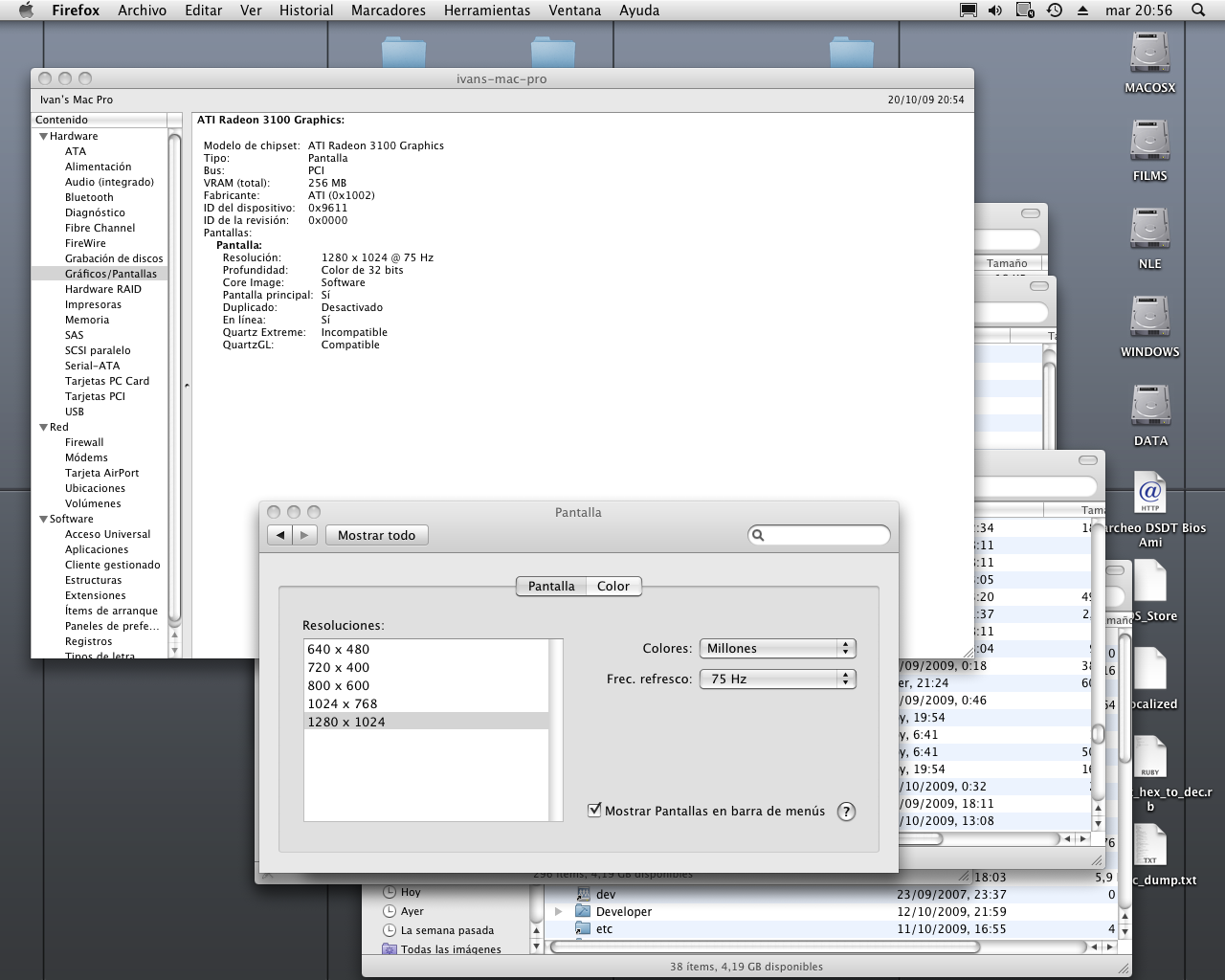

jkwarras Posted October 20, 2009 Share Posted October 20, 2009 Thanks! It works on my on-board video card, a ATI HD 3100. The kext is loaded and I get the resolutions menu. Two issues I'll like to report: 1) Booting with -v doesn't work, it hangs. 2) As expected QE doesn't work. It's a RV610 chipset, so I tried adding my device ID in the info.plist (0x96111002), but I get garbage screen. Any ideas? Thanks again man, it's really appreciated to get my card on system profile Link to comment Share on other sites More sharing options...

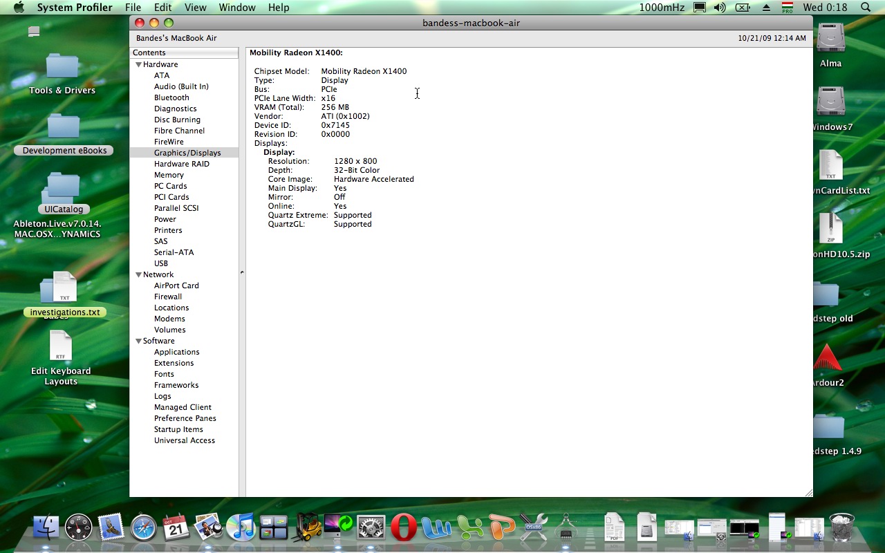

Bandes Posted October 20, 2009 Share Posted October 20, 2009 Excellent work dong! I 've been using my Fujitsu Siemens Pi1536 laptop until now with an external monitor(1920x1080) using Atiinject and SwitchresX. Now i removed Atiinject, installed Radeonhd kext, and laptop screen works now with 1280x800. (External monitor no more) I dont have any different resolutions listed, but this is not a problem. Just one thing, mouse tears again I wonder if it can be solved somehow. It was gone when using external monitor. update: resolutions are now listed as well with 640x480, 800x600, 1024x768, 1280x800. All work with mouse tear. Link to comment Share on other sites More sharing options...

Bandes Posted October 21, 2009 Share Posted October 21, 2009 Your external monitor is using the ATI vanilla driver, that's why there is no mouse tearing. I'd like to remove the mouse tearing too, but someone need to tell us what causes this. The tearing manifests in relation with the overlay surfaces maybe. Generally if there is some garbage, then something is clocked over usually. Interesting thing i noticed, the laptop does not get hot as it gets on windows when Ati Powerplay is set to performance mode (the higher clock setting) so it should have to be running on energy saving mode. In the sametime cinebench produces around the same test results on OS X. (That time the laptop gets hot as well) I really miss Atitool for OS X. Would give important information for sure. There is one similar clocking software for OS X, but it does not support Ati X1400, just some older gpus. One more interesting thing. On OS X i cant choose refresh rate. N/A is there. On Windows there are two options, 59Hz and 60 Hz. I was always wondering why these two. 59 ??? Strange. Link to comment Share on other sites More sharing options...
