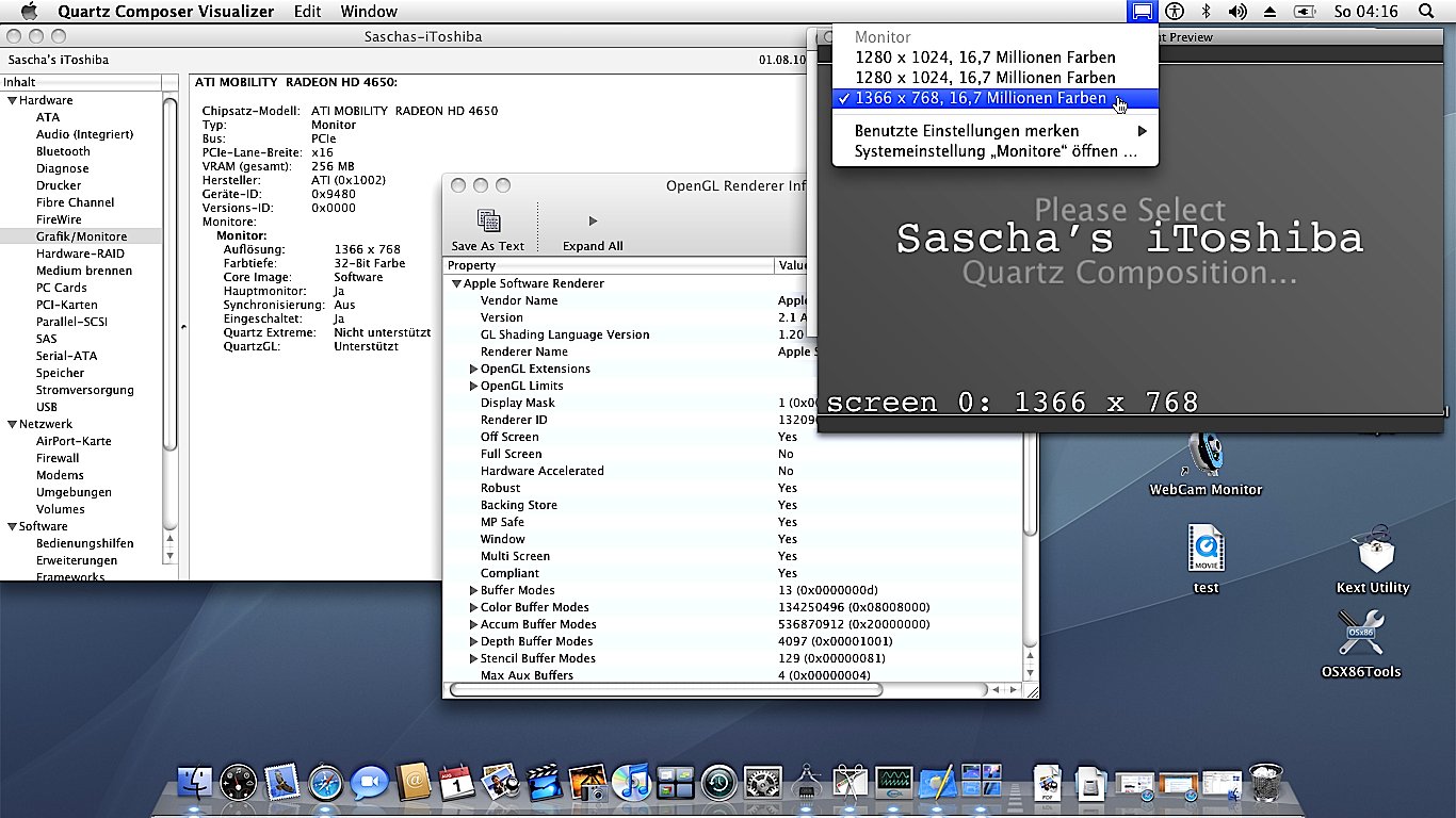

Toshiba Satellite L500-120 ( Vista/W7 Machine ) Core2Duo.2.1GhZ,4GB Ram, ATI Mobility HD4650 ( M96 ) with 1GB Ram ( so says Toshiba ) Phoenix Bios, Intel ICH9M family.
Driver radeonHD says it has only 256MB ram for video, but imaybe thats just the maximum via this solution or a bug ( or Toshiba is telling {censored} .. ) fine and sharp working resolution 1366x768x32, I enabled QuartzGL with "OSX86tools", and after that even imovie 6 and iphoto 6 are operable at good speed ( really ! ) , all effects, quicktime movies, preview,coverflow,screengrab,quicklook all working. ( IN SnowLeopard nothing of that was possible , reverted to Leopard for that reason, although the radeonHD did of course work also there but SL is too much built on 3D/ new Quicktime, so its useless for me)
speedwise I could imagine to use Leopard on this machine on a daily base.. if not :
Annoying : the GPU fan is constantly blowing, which is driving me mad. Its loud as hell . IN Vista and Linux the fan is silent as soon as catalyst is installed and "powerplay" is enabled.It only goes sometimes on when 3d is heavily used or high definition video is used. The L500 is a super silent machine otherwise.
The fan issue will let me sooner or later install Linux again ( Ubuntu 10 fully supports this laptop out of box )
The built-in webcam ( chiconey UVC usb, works in Win and Lin without drivers ) turns light on, but only shows black . It must have to do with missing accelearation ( photo booth says my graphic card is not usable and cloes ) , ichat crashed when the cam goes on..
Othwise all working like it should, even cardreader,sound,bluetooth, the wheel to adjust volume shows on-screen-notifications and so on.
Only problematic stuff is the IWLAGN 5100 chip. I managed to make it appear as Ethernet in SnowLeo with 2 kexts , but the OS thinks it is a cable-bound network and so I cannot join any hotspot.
It has HDMI out, but as I dont know what this might be good for I cant tell if it is working. I use the laptop alone, no secondary monitor or equippment. Only a Mouse sometimes cause trackpad is uncomfortable all the time ;)
I dont care too much for 3D as long as I can run imovie and iphoto and watch youtube without lags, but that damn fan-thing.. if there is a solution .. :rolleyes:
