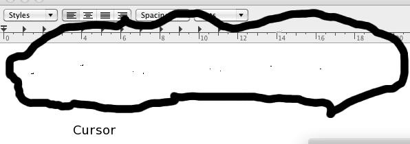

I am having some problems with my mobility x1300 at the moment. After launching certain applications (such as 3d games and video players) I get the following cursor display (see cursor.jpg attachment).
I am using up to date RadeonHD.kext (this problem did occur on the previous RadeonHD.kext).
EnableHWcursor false or true makes no difference.
I believe I might have some sort of hardware acceleration as the Dock is smooth at opening folders (it didnt in the past).
System profiler doesn't list any acceleration.
I've tried using ATIRadeonX1000.kext, only adding my device ID and tried using the attached kext, which was hex edited by someone else.
I do have mouse tearing with enableHWcursor set to false
I am running 10.6.3.
Can anyone help me out with this cursor distortion?

I have already started testing some things and i noticed that: The mouse works fine if i use the built in screen zoom feature. The screen goes slightly blurry but i can see my mouse in Dreamweaver CS5 which is a great help.
Not sure if this information helped you but oh well thought i'd let you know,

I just played with the cursor part, here is something I found. Whenever I move the mouse into the Microsoft Word document area, "2 color cursor" scheme is used instead of the default "32 color cursor" scheme used by the system. So I guess all problems with hardware cursor may caused by the same reason, those programs or games are using "2 color cursor", i.e., black and white colors only.
Here is the code used for log the usage of which scheme:
	if (VSLPrepareCursorForHardwareCursor(cursorRef, &hwcDescDirect32, &hardwareCursorInfo)) {
	bitDepth = 32;
	cursorMode = 3;
	LOG("32 color Cursor selected\n");
} else if (VSLPrepareCursorForHardwareCursor(cursorRef, &hardwareCursorDescriptor1, &hardwareCursorInfo)) {
	bitDepth = 2;
	cursorMode = 1;
	LOG("2 color Cursor selected\n");
} else {
	LOG("Prepare Hardware cursor failed\n");
	return FALSE;
Somehow the 2 color cursor is not working correctly at the moment. Now it is displayed as some smeared lines instead of nothing.
I will continue to research on this.
I added the support for 2 bits color cursor. Now the cursor is working correctly in Microsoft Word for me. I have updated the topic. People please test the latest kext and report.
