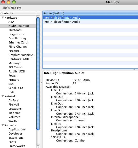

NoSmokingBandit Posted September 23, 2009 Share Posted September 23, 2009 With all the DSDT editing and whatnot floating around i desperately sought after a simpler solution. This method uses HDEFEnabler, a x64 version of HDAEnabler from Taruga, and a patched AppleHDA of unknown origins (if you know it belongs to you let me know and i will add your name for credit). These cant be installed to an efi partition, and have to go in /S/L/E, but if it saves me time and confusion from editing the dsdt i really dont care. I just installed them using KextHelper which surprisingly works well in 10.6. It will back up your original AppleHDA to /Backup Extensions, so if you need it back you can find it there. This may also work with other codecs but all i have around here are 888 so i cant test anything else. The kexts are attached, please report if this worked or not along with your motherboard model. I havent tested this extensively, but as far as i can tell it gives me 5.1 surround on my GA-EP45T-UD3LR x64_audio_for_ALC888.zip Link to comment Share on other sites More sharing options...

NoSmokingBandit Posted September 23, 2009 Author Share Posted September 23, 2009 Did you try changing the output in System Preferences? The AppleHDA i used in Leo set it to the wrong output by default and all i had to do was change it in sysprefs once and that fixed it. Link to comment Share on other sites More sharing options...
zeebeedee Posted September 23, 2009 Share Posted September 23, 2009 At last i've found a working kext Thank you so much NoSmokingBandit, i owe you a beer The only problem i still couldn't find a way of getting sound all of them together. They are working seperately by selecting on sound prefs. BTW, My MOBO is EX58-UD3R Link to comment Share on other sites More sharing options...

NoSmokingBandit Posted September 24, 2009 Author Share Posted September 24, 2009 ^^ Theres a link near the bottom of this page for 883 by Clubber_77: http://www.projectosx.com/forum/index.php?...entry1993 I havent tried it myself (because i have no 883), so post results if it works! At last i've found a working kext Thank you so much NoSmokingBandit, i owe you a beer The only problem i still couldn't find a way of getting sound all of them together. They are working seperately by selecting on sound prefs. BTW, My MOBO is EX58-UD3R Do you mean like Speaker Fill, where stereo things like mp3s can play through all the speakers at once? I have a setup for that, but i havent tested it in 10.6 yet. I'm still getting settled in I'll see if it still works and post a speaker fill guide tomorrow probably. Link to comment Share on other sites More sharing options...
hjupter Posted September 24, 2009 Share Posted September 24, 2009 AWESOME!! it WORKS!!! Ive like a week looking for a solution for my mobo p35-ds3l acl888 with SL 64, i just installed the kext's with kext helper and instantly the sound was working without restart. THANKS! Sorry for my english xD Link to comment Share on other sites More sharing options...

keypox Posted September 25, 2009 Share Posted September 25, 2009 how do you get all speakers to work at once? My speakers all work but not at the same time. works based on which line out i choose nevermind follow blackosx gudie and then doing this got all speakers working "I take back my word. Got full analog 5.1 to work on my onboard alc888! 1. Tweak AppleHDA.kext to detect 3 Line Outputs: Green, Black, Orange. 2. Run Audio Midi Setup 3. Add new Aggregate Device 4. Click on the 3 check boxes corresponding to the 3 Line outs 5. Click on Configure Speakers 6. Select all 3 streams 7. Select Multichannel 5.1 8. Make sure all channels are properly mapped 9. Select Aggregate Device as output under System Preferences>Sound 10. Done" from post here http://www.infinitemac.com/f57/guide-alc88...surround-t3746/ Actually everything worked right up to the last step... step 9. Aggregate device is not showing up in sys pref > sound where a restart was required Link to comment Share on other sites More sharing options...
Lira Posted September 28, 2009 Share Posted September 28, 2009 Oh...I really don't get it. I have an alc888 (but 7.1, I don't know if that is a problem) and first time that I installed those kext and restarted the devices appeared correctly at the preferences pane, but no sound was coming out of the speakers. So I restarted my PC in windows to see if there were any problem with the speakers, but in windows they worked just fine. But when I booted in mac os again the devices stopped appearing in the preference pane and the audio MIDI setup doesn't open. Anyone have any idea? Edit: I discovered that the problem with audio MIDI setup was the aggregate profile that I made to join the channels, I deleted that and now the program works fine again. But still no audio... Link to comment Share on other sites More sharing options...
Azimutz Posted September 28, 2009 Share Posted September 28, 2009 I don't know if anyone noticed but, HDAEnabler.kext is already in plugins folder of AppleHDA.kext no need to install it twice. Anyway, this works for me but, far from 100%... no headphones, at least. Will test more when possible... Thanks Link to comment Share on other sites More sharing options...
MACinized Posted September 30, 2009 Share Posted September 30, 2009 I don't know if anyone noticed but, HDAEnabler.kext is already in plugins folder of AppleHDA.kext no need to install it twice.Anyway, this works for me but, far from 100%... no headphones, at least. Will test more when possible... Thanks good thing u noticed it Azimutz that HDAEnabler is already included w/ AppleHDA. so guys, don't use the HDAEnabler.kext anymore. just use the AppleHDA.kext. it works with ALC888S onboard Aspire M1800. Link to comment Share on other sites More sharing options...
jerdcox Posted September 30, 2009 Share Posted September 30, 2009 Haven't tested 5.1, but stereo works, and seems to be working perfectly. No pops or hisses, running on a GA-EP45T-UD3LR with ALC888, ICH10R, and an E6300. Used lifehacker's Snow Leopard guide to install and get it booting from hard drive, added these two kexts, and everything worked. And I had been working on sound from various other guides and sources, including testing many kexts and editing my dsdt.aml like crazy days trying to get this working. Many thanks for a great post; I had given up and gone back to Ubuntu for a few days. This system is usable now that I have sound. Link to comment Share on other sites More sharing options...
