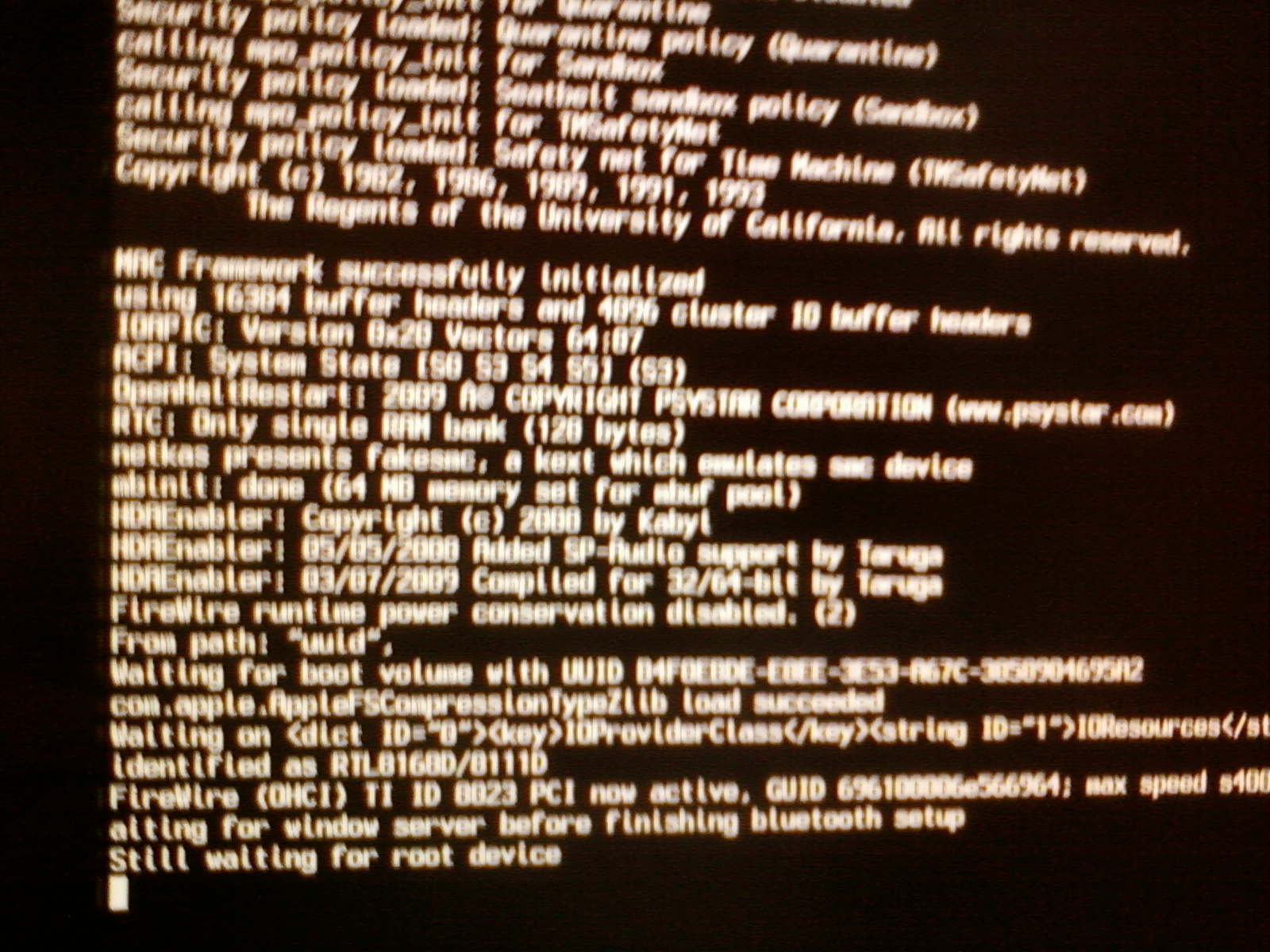

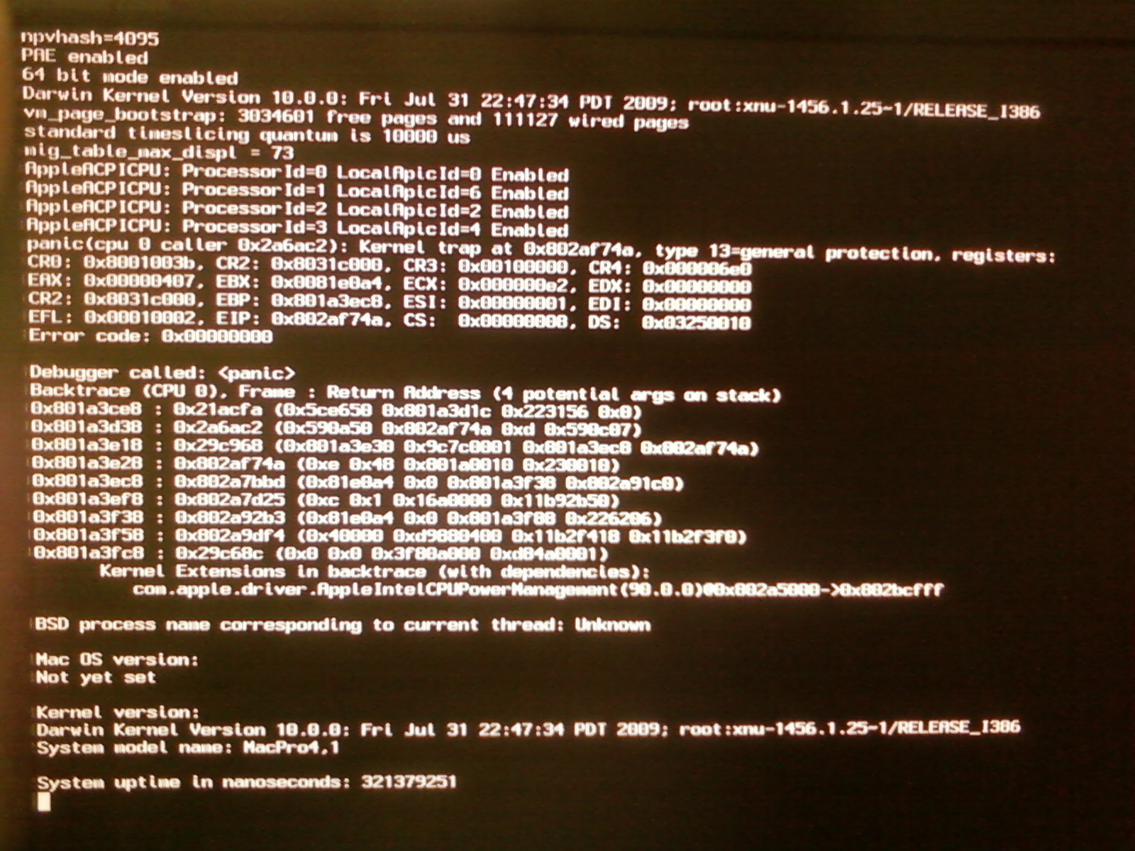

Hey CruiSAr,
I just tried your guide used DD's Script to remove all the kext's but the fakesmc and the ethernet. I got a kp after I rebooted (i removed the kexts and updated the boot cache and then moved the dsdl into the /extra) but it looks like something is up with my #4 cpu.
Heres a screeny
What do you think?
Edited for botardedness
Hey CruiSAr,
Heres a screeny
No screen attached, the DSDT was patched as of bios F9m version, I see you have version 12...maybe that could be the issue.
EDIT: You also need a modded bootLoader for the setup to work, sorry, I forgot to mention that...check the link in the guide.

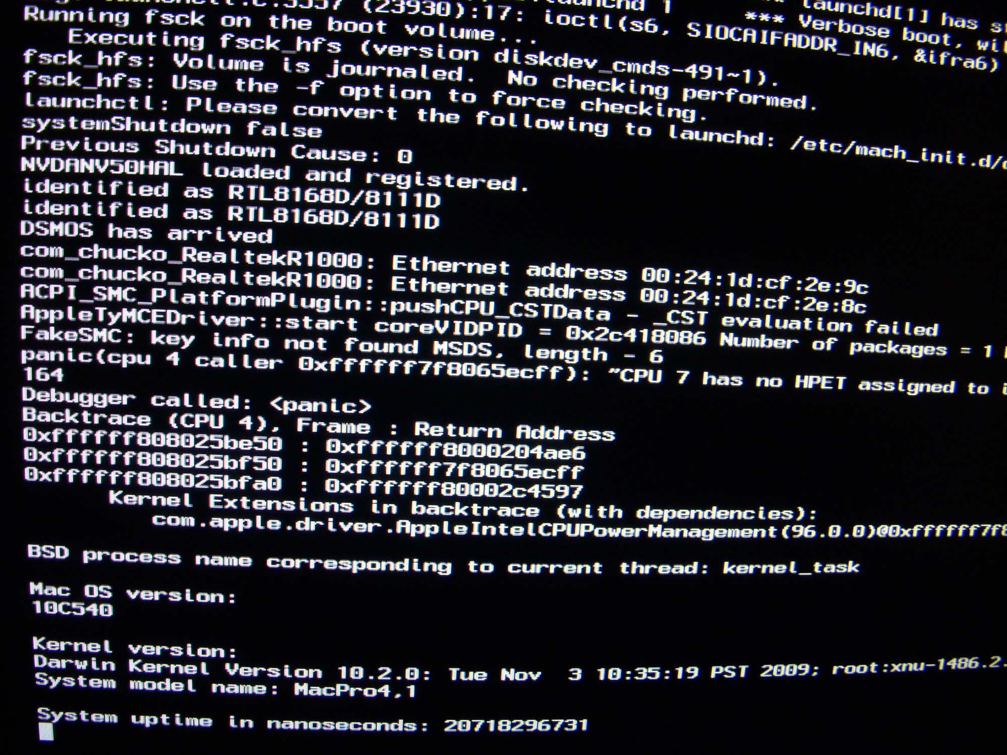

If you can access your SL drive from Leo, then I suggest you copy over the necessary files /Extra folder etc etc and try a reinstall, it will only take 15 minutes. You can also try reinstalling the bootLoader again.
tried to reinstall the bootloader - no luck. The weird part is that the same preboot CD I previously used successfully will no longer boot - same type of a hang... just stops after it says done mounting.
-jon
-jon
Ok try flashing the bios again, maybe to an older version, I find F8e and F9m to be very good...Try clearing CMOS as well
Fashed the bios. cleared the cmos using the button at the back of the mother board.
Still not working. same issue. The preboot CD acts a little different though - after it says done mounting the curosor continues to spin and the HD light is on - but the CD stops spinning.
completely at a loss as to what the issue is.
