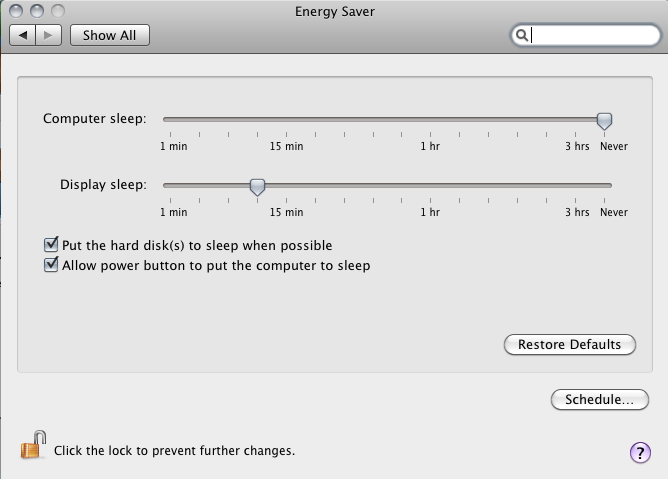

Sidewinder33 Posted March 18, 2010 Share Posted March 18, 2010 Hey all I have a question about sleeping with our board. I have Sleepenabler installed and sleep works, but every now and then my computer completely shuts down after being asleep for a period of time. I've been reading through the Sleepenabler thread, and it appears that several options are missing in the energy saver preferences. I know right now I have it set to never at the moment but thats because I've almost missed work twice when my alarm (on my computer) didnt go off since it was shutdown and not just sleeping. So my question is is there any thing extra i need to add or modify to add in the extra options. I was reading about AppleLPC.kext but I'm very new to the game and the threads seem a little older. Is there a new option that accomplishes the same? Thanks for any help guys Link to comment Share on other sites More sharing options...

CruiSAr Posted March 19, 2010 Share Posted March 19, 2010 Hey allI have a question about sleeping with our board. I have Sleepenabler installed and sleep works, but every now and then my computer completely shuts down after being asleep for a period of time. I've been reading through the Sleepenabler thread, and it appears that several options are missing in the energy saver preferences. I know right now I have it set to never at the moment but thats because I've almost missed work twice when my alarm (on my computer) didnt go off since it was shutdown and not just sleeping. So my question is is there any thing extra i need to add or modify to add in the extra options. I was reading about AppleLPC.kext but I'm very new to the game and the threads seem a little older. Is there a new option that accomplishes the same? Thanks for any help guys Never experinced issues with sleep before, if you want a 100% working sleep with no hassles then you should defer from third part kexts and use native power management. Consult d00d's native power management thread Link to comment Share on other sites More sharing options...
zoro2 Posted March 19, 2010 Share Posted March 19, 2010 Never experinced issues with sleep before, if you want a 100% working sleep with no hassles then you should defer from third part kexts and use native power management. Consult d00d's native power management thread I have an odd sleep problem. I don't know if this would help to know or not? If I leave myself logged in it goes to sleep and AFAIK it wakes up even much later just fine. But, If I log out and it goes to sleep, it gets to a place, not immediately but after some time, where it wont wake up at all. I have to reboot. The only KEXT I use that I think is related to sleep is: NullCPUPowerManagement.kext. Link to comment Share on other sites More sharing options...

Sidewinder33 Posted March 19, 2010 Share Posted March 19, 2010 Never experinced issues with sleep before, if you want a 100% working sleep with no hassles then you should defer from third part kexts and use native power management. Consult d00d's native power management thread I've looks at the thread and I really really want to do it (less hassle once its set up) but I'm pretty novice at coding and hackintosh manipulating in general. I have a hard time understanding all that dood says in his thread. I've tried reading it over several times but just can't get my head around it completely. But that is my goal to get there some time Hi all, First let me say thanks for all the hard work I followed many of the posts here and had a successful 10.6.2 installation. My 10.6.2 system was stable for months until a recent problem: Boot loader wont load - no boot loader seems to work. One day my 10.6.2 system stopped working. When it boots I get this: boot0: GPT boot0: testing boot0: testing boot0: done boot1: /boot then the screen clears I get a "spinning" cursor at the upper left of the screen that then stops.... and that's it. I have the same symptoms when I try to use any other method to boot - like the preboot disk (which previously worked fine). I've got a 10.5.7 system running fine from another HD, just can't get anything else working. Any help would be greatly appreciated. My config is basically what DD has but my graphics card is a ATI Radeon HD 2600. Thanks. JonG Hey Jon DD addressed this on his first post BOOTINGWhen I boot, I get the following message: boot 0: GPT boot 0: testing boot 0: testing boot 0: error What's wrong? This message appears when the BIOS cannot find a bootable system. Double-check your BIOS drive priority or make sure the BIOS is instructed to boot from the proper drive with a installed bootloader. I just installed a new OS and bootloader. Now I can't boot back into my old install. What happened? You have different and, therefore, incompatible, bootloaders installed. Ideally, each bootable partition needs to have the same bootloader installed. If that is not attainable, then you need to select the desired OS/partition via BIOS drive/partition selector <F12>, not bootloader, to ensure your system boots just the bootloader installed for that partition/drive. If you select a partition in the bootloader screen that has a different bootloader installed, you may experience instability or unpredictable behavior, including kernel panics. Link to comment Share on other sites More sharing options...
