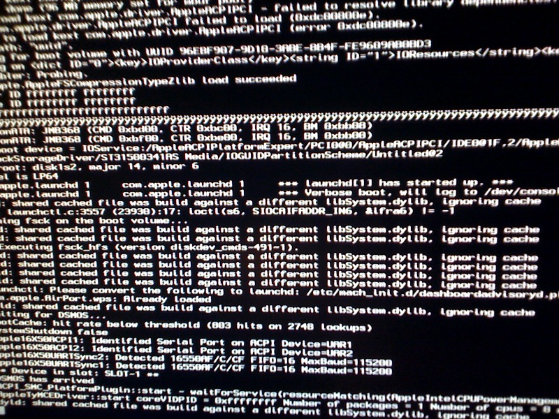

Hmm, I'm having a weird ethernet problem which I think I caused myself. I booted with verbose and another network device was detected on top of what I already had, instead of ignoring/deleting it I deleted both and now I don't seem to have any ethernet at all. I don't think it's even detected... I have tried reinstalling kexts and other things, but it just won't detect it.
Can anyone help me on this? Thanks.
Did u try rebuilding the boot cache after the kext reinstallation? Just a thought, give it a try.
Yeah I did. I installed it using the script so it automatically updates the caches after installing. Thanks for the thought though.

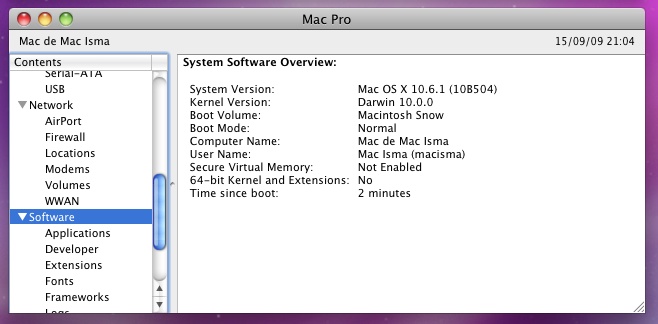

I noticed that same problem as well. Although I probably won't be using sleep anymore since it doesn't work when my CPU's overclocked. After waking up my bluetooth mouse, although connected, didn't work either. But strangely the keyboard (which is also bluetooth) did work.
Edit:
Also, I still need some help getting ethernet working properly in 64-bit mode. Ethernet appears under my Network tab in 64-bit mode the same as it does in 32-bit. However, this is how it looks both using DHCP:
32-bit
64-bit
I'm guessing RealtekR1000.kext isn't 64-bit compatible, so the question I'm asking is what's the alternative?
Thanks.

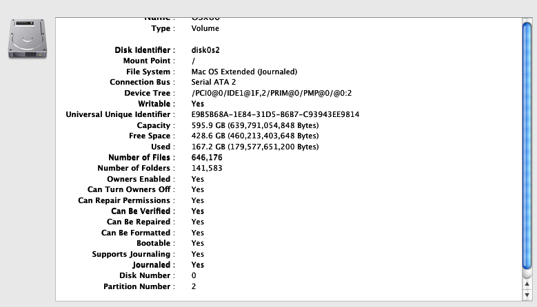

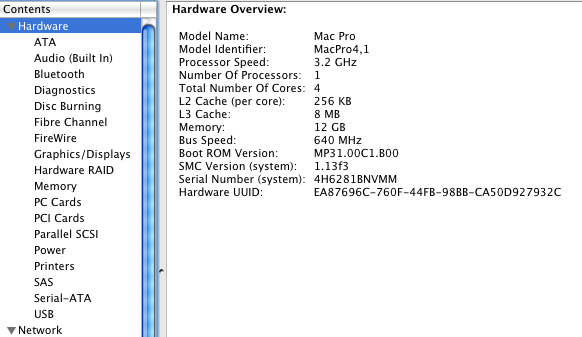

I'm back and this is my first post to the new thread. Thank you MAJ. The new script is fantastic. I'm using Chameleon 2 RC3 for both Leopard and Snow Leopard (32-bit for now) on separate drives using the EFI partition. Simply amazing. I cannot thank you enough.
There is one small problem with the script however. When you up update the boot caches you update UUID.kext (or PlatformUUID.kext) with the UUID of the boot drive which is actually incorrect. In fact these are different.
The boot UUID in com.apple.boot.plist is the UUID of the drive partition that you would like the bootloader to boot. Every partition has its own own UUID and is created when the drive is partitioned.
The UUID is those kexts is your hardware UUID and should never change. You can see it in System profiler in the hardware tab. It also appears in /Volumes/YOURDRIVENAME/Users/YOURUSERNAME/Library/Preferences/ByHost/ in the name of the files. This is how a lot of software authorization happens.
Regardless of whether or not I boot Leopard or SL (which have different boot-uuid's), my hardware UUID is the same. That way any migrated software that is authorized to run on one partition will continue to run on the other partition. I hope that was a clear enough explanation.
Anyway, this really isn't your fault. It's a very common misconception. I only figured it out through some serious trial and error plus dumb luck. I look forward to a fixed version. Your hard work has made this easy for me and lots of other people.
Cheers FUT1L1TY
Bear in mind to all. PlatformUUID.kext > Contents > info.plist sets your Hardware UUID: in System Profiler so if you have a Partition UUID: in there you will have to remove it first to get the true UUID. Then update with correct Hardware UUID: possibly after a reboot. May also apply to UUID.kext.
Can anyone confirm if Hardware UUID: is the correct UUID to enter in smbios.plist?
As I understand it correctly it should be
Partition UUID: for com.apple.boot.plist
Hardware UUID: for UUID.kext PlatformUUID.kext smbios.plist
khaosnz,
Thanks for that info.
Now, here's my question:
If removing the current (albeit, incorrect) UUID from smbios.plist will allow the correct UUID to appear, why isn't the smbios.plist retrieving it this way? Basically, you appear to be saying we really don't need that Platform UUID there, as it can be retrieved from hardware anyway, where ever that is.
But, I don't think there is one for hackintoshes. It seems to me that the hardware or platform UUID is planted in EFI firmware by Apple. So, we need to create and settle on a never changing platform UUID for use in the smbios.plist.
This will give me something to research and think about.
