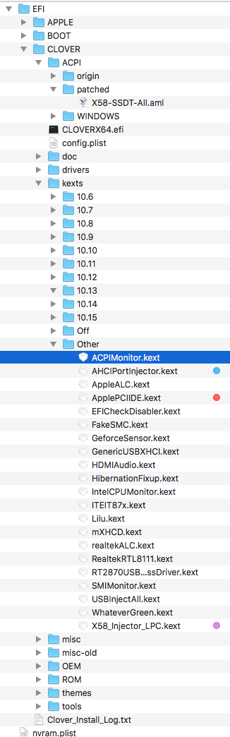

Hello jhrfc,
You will find hereby my Clover files ( Clover 2.5k-r5107) config.plist and X58 SSDT-ALL.aml. The EFI structure is in image.
I have upgraded my bios for years know with GA-EX58-UD5 -F13 mod11 (and bumped it a little bit to 3.46Hgz), i don't know if its important ....
Specs bios F13 mod11:
Updated :
IRST 11.6.0.1702
Realtek 2.50
Jmicron 1.07.28
(I use Kextupdater (v.3.4.1) for latest versions check of kexts)
Let me know if this helps !
Cheers

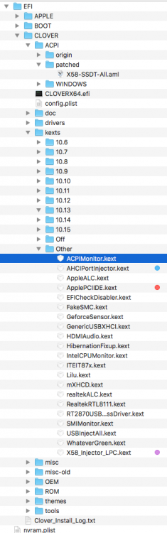

On 4/5/2020 at 12:23 PM, @ROBASEFR said:
Hello jhrfc,
Updated :
IRST 11.6.0.1702
Realtek 2.50
Jmicron 1.07.28
Cheers
config.plist
ex58ud5_f13mod11.rom
X58-SSDT-All.aml

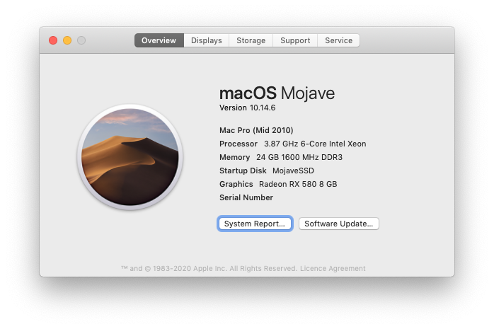

Now made the move to Mojave, all well. (sleep, speedstep, turbo etc), have also overclocked the CPU to 3.8 GHZ.
May now experiment with catalina. I know i will have to change the SMBIOS away form the old faithfull macpro5,1 i guess i'll need to be careful to not break the cpu power management.

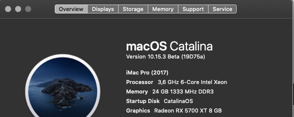

@jhrfc You can keep your Mac Pro 5,1 SMBios the only thing you need to add  into your Config.Plist is no_compat_check  and you can boot Cat woman
Personally recommending Mojave because it is much more stable than Catalina and you will definitely get some sleep and wake problems
Edited by Rocky12
Thanks @Rocky12! I read you needed to chnage the smbios for at least the upgrade/install, is that right?
Also out of interest which clover version are you using with catalina?
Will definitely install on an experemental disk for now!
Cheers
J
@jhrfc Yes this is true to get the latest updates you need to have a supported SMBios because Apple drop support for a bunch of machines so that’s why you need to have one which is supported
it doesn't make any problem if you still use Mac Pro 5,1 the only thing you have to add no_compat_check just to bypass the installation process
how to get the latest update there are some tools over macrumors but I don't now if they are working on hack
https://forums.macrumors.com/threads/macos-10-15-catalina-on-unsupported-macs.2183772/post-28410792
My Clover Version v2.5k-r5112
CatalinaOTAswufix.zip
Edited by Rocky12

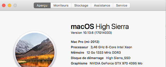

My rig is still ok with 10.13.6 latest security update and latest Nvidia and Cuda drivers..
11 years anniversary !:thumbsup_anim:
Bootloader: Clover v2.5k-r5122
Geekbench: Sc: 650 ; Mc-3674 ; Metal:137775 ; OpenCL 33540

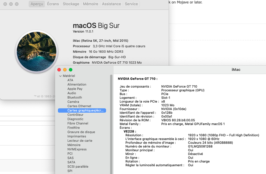

Geforce GT 710 works natively in Big Sur and Catalina
yes if the card supports metal, and is a card that can use the official apple Nvidia drivers you are ok, anything that needed nvidia's own webdrivers to work, will not work on Mojave or later.
Cheers
Cheers
Support metal of course :D
