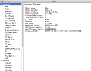

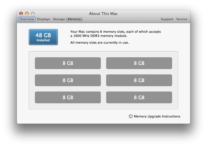

aikidoka25 Posted March 7, 2014 Share Posted March 7, 2014 There are rules to which slots you should use as stated in the EX58 manual, so for four sticks they need to go in slot 1,2,3,4 - slot 1 is nearest cpu I suspect that when the manual was written there were no 8GB modules, even 4GB was rare so it stated 24GB as max I've got 48GB now It could be wishful thinking but using all six slots seems smoother than 4, could be my imagination ?? (reason I'm using so much is Final Cut pro , Motion etc use a lot of RAM for video editing - 12 GB is easily used and I had to shut things down to avoid running out) PS - my old 12GB is on ebay uk now ;-) Are you using 6x8GB of triple channels DDR?. Currently I am using 6x2GB triple channels and it seems this type is out of trend now. So I wonder, if putting 3 pairs of dual channels will do. Link to comment Share on other sites More sharing options...

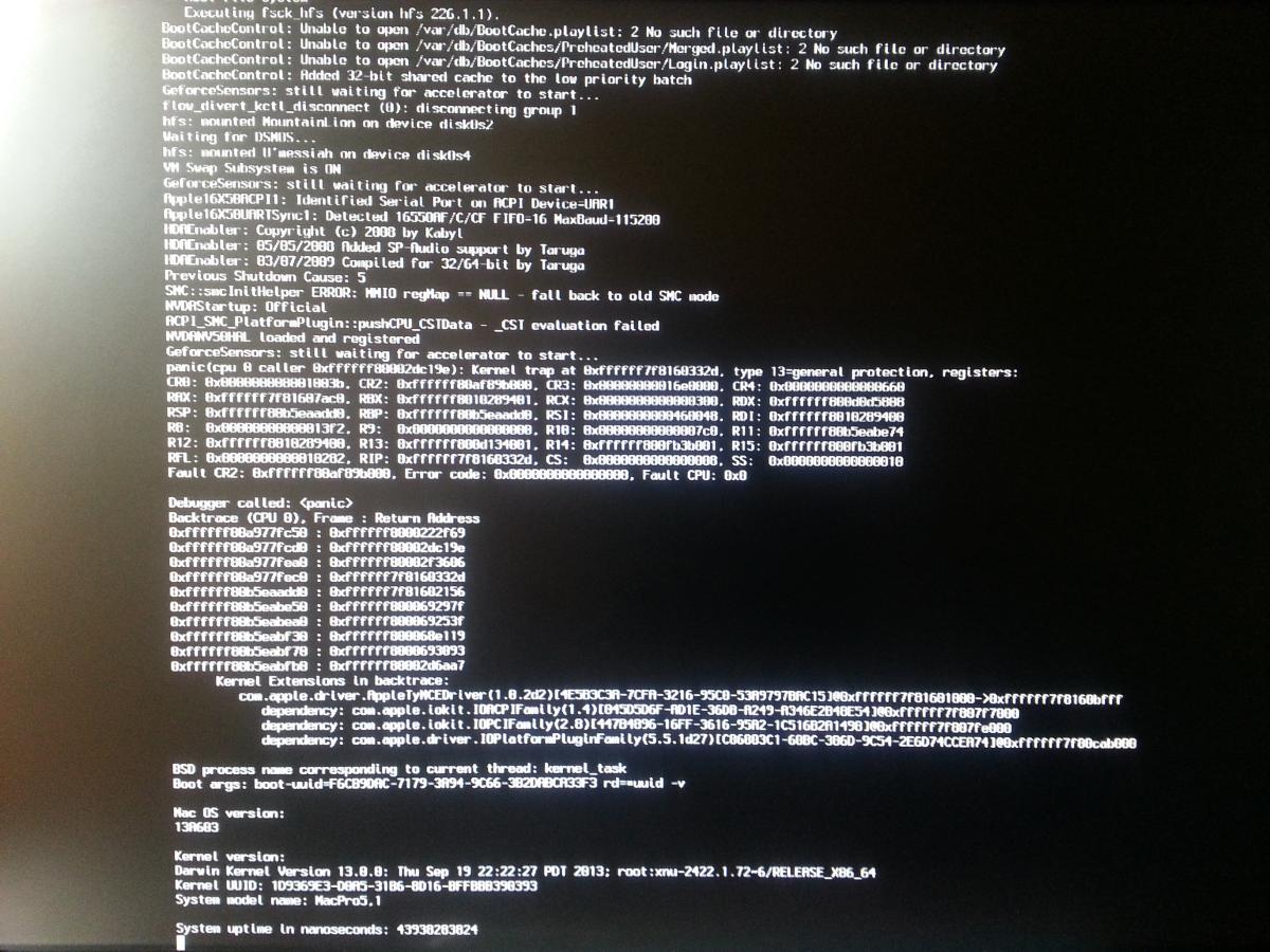

InsanelyOne Posted March 19, 2014 Share Posted March 19, 2014 Been running 10.9.1 with no problems... Updated to 10.9.2 and now I can only boot in safe mode. The error message is indicative of a disk failure but I'm not convinced that's the problem. Here's the error: SATA WARNING: Identify device checksum not implemented AppleAHCIDiskQueueManager::setPowerState timed out after 100202 ms Could this have something to do with having TRIM enabled/disabled? My boot drive is an SSD. Any help is greatly appreciated. Edit: On further inspection the "SATA WARNING" message is not the problem. It's definitely the AppleAHCIDiskQueueManager error. Googling hasn't been to much help so far. Edit Again: I ended up restoring to 10.9.1 from Time Machine. Never did figure out how to get past the error. Suggestions are still welcome. I hate not being able to stay up-to-date. Link to comment Share on other sites More sharing options...

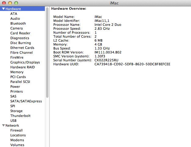

iLeopard_PC Posted April 6, 2014 Share Posted April 6, 2014 Hi all, First of all, i apologize for my bad english... I have installed Mavericks on my GA-P35-DS4 (rev 1.1) with this installer. It wasn't easy because my graphic card (EN8800GT) not seem to work well with Mavericks; now I can boot only with "-x" (it means that i haven't Qe/Ci) but i discovered that ethernet and audio don't work. Any suggestions? This is what i can see if i boot without -X My org.chameleon.Boot.plist: <key>GenerateCStates</key> <string>Yes</string> <key>GeneratePStates</key> <string>Yes</string> <key>EthernetBuiltIn</key> <string>Yes</string> <key>Graphics Mode</key> <string>1280x1024x32</string> <key>GraphicsEnabler</key> <string>Yes</string> <key>PciRoot</key> <string>1</string> <key>Kernel</key> <string>mach_kernel</string> <key>Kernel Flags</key> <string>-v</string> <key>Timeout</key> <string>3</string> Last questions.. Is there anyone who has installed Mavericks with GA-P35? and someone who has installed Mavericks with 8800GT? Thanks Link to comment Share on other sites More sharing options...
@ROBASEFR Posted April 16, 2014 Share Posted April 16, 2014 Hi all, First of all, i apologize for my bad english... I have installed Mavericks on my GA-P35-DS4 (rev 1.1) with this installer. It wasn't easy because my graphic card (EN8800GT) not seem to work well with Mavericks; now I can boot only with "-x" (it means that i haven't Qe/Ci) but i discovered that ethernet and audio don't work. Any suggestions? Last questions.. Is there anyone who has installed Mavericks with GA-P35? and someone who has installed Mavericks with 8800GT? Thanks From de script folder 10.9: For audio (yours is Realtek ALC889A codec=ALC885) you need to put the default kexts for audio in S/L/E (information here: https://github.com/toleda/audio_ALC885) For LAN (yours is Realtek 8111B) use the IONetorkingFamily.kext in the script folder and put it in S/L/E. or use RealtekRTL811.kext (v.1.1.3 ) that I replaced inside IONetworkingFamily.kext/ plugins (instead of RealtekRTL81xx.kext) http://www.insanelymac.com/forum/index.php?app=core&module=attach§ion=attach&attach_id=133745 For your Nvidia 8800GT : Install latest Nvidia drivers http://www.nvidia.com/download/driverResults.aspx/73628/ and Ad this in your org.chameleon.Boot.plist: <key>Kernel Flags</key> <string>nvda_drv=1</string> Good luck 1 Link to comment Share on other sites More sharing options...
iLeopard_PC Posted April 21, 2014 Share Posted April 21, 2014 Hi all, i have re-installed Mavericks on my computer with this guide and some tricks (pciroot=1 in my boot and, also, I have deleted AppleTyMCEDriver.kext). My system works but is slow; for example i have a lot of lag using Safari and games as well. My graphic card does not seem to work well. I have installed OSXUpdCombo10.9.2.dmg but nothing has change... so what can i do? Link to comment Share on other sites More sharing options...
Maestroso Posted April 30, 2014 Share Posted April 30, 2014 Hi, First of all: Thanks so much to Digital Dreamer for keeping up the script! I have used it since 10.5 or 10.6 successfully. This time, after installing 10.9.2 on my Gigabyte GA-EX58-DS4 with Core i7 920 (3.3 GHz OC), 18 GB RAM, I'm facing issues unfortunately. It seems as if my system is affected by the +10° C issue that is related to NativePowerManagement. In 10.8.4 idling temperatures used to vary around 50-54° Celsius. Now in 10.9.2 the cpu idles at 60-63° Celsius. I know that the DSDT patcher is supposed to fix this but it seems to be unable to retrieve vendor and device ID of the LPC controller. Accordingly, the output log in console states the following: ------- <==================> DSDT Patcher <==================> ###################### Checking Method local variable is not initialized (Local0) fix No corrections needed. ###################### Checking Length larger than min/max window fix No corrections needed. ###################### Non-hex letters in lowercase (Invalid ID fix) No corrections needed. ###################### Checking Device (RTC) length (CMOS reset fix) No corrections needed. ###################### Checking for (WAK) Sleep fix. No corrections needed. ###################### Checking for (RTC) Sleep fix. No corrections needed. ###################### Checking for Power Button fix. No corrections needed. ###################### Native Power Management fix (HPET & LPC). HPET fix not needed. Unable to retrieve vendor and device ID of LPC Controller! Skipping. lspci LPC line: lspci: Cannot find any working access method. DirectHW.kext not loaded. ###################### Checking for Shutdown fix. No corrections needed. ###################### Code trimming, cleanup and optimization. Working... Trim Device RTC (Real Time Clock) Device RTC: No changes needed Remove Device FDC (Floppy Device) Device FDC: Nonexistant Remove Device SPKR (Speaker) Device SPKR: Nonexistant Remove Device PS2K (PS/2 Keyboard) Device PS2K: Nonexistant Method PS2K: Nonexistant Notify PS2K: Nonexistant Remove Device PS2M (PS/2 Mouse) Device PS2M: Nonexistant Method PS2M: Nonexistant Notify PS2M: Nonexistant Device PSMR: Nonexistant Remove Device UAR1 (UART for Parallel/Serial Ports) Device UAR1: Nonexistant Notify UAR1: Nonexistant Remove Device UAR2 (UART for Parallel/Serial Ports) Device UAR2: Nonexistant Notify UAR2: Nonexistant Remove Method OSTP Method (OSTP): Nonexistant Line OSTP (): No lines found Rename Device AZAL to HDEF (Audio) AZAL to HDEF: No changes needed Rename All USB Devices (e.g. USB0 to UHC1) USB0 to UHC1: No changes needed USB1 to UHC2: No changes needed USB2 to UHC3: No changes needed USB4 to UHC4: No changes needed USB5 to UHC5: No changes needed USB6 to UHC6: No changes needed EUSB to EHCI: No changes needed USBE to UHCI: No changes needed #### Total lines removed: 0 Doing final compile. Intel ACPI Component Architecture ASL Optimizing Compiler version 20121220-64 [Dec 29 2012] Copyright © 2000 - 2012 Intel Corporation ASL Input: Debug/dsdt_fixed.txt - 5149 lines, 158311 bytes, 2059 keywords AML Output: Debug/dsdt.aml - 16268 bytes, 569 named objects, 1490 executable opcodes Compilation complete. 0 Errors, 0 Warnings, 0 Remarks, 15 Optimizations DSDT patch created - copying patch to drive ------- I have tried to modify the DSDT myself (following guidelines by d00d's native power management modifications) but ended up with the same results. I really wonder what's wrong. Also tried to install 10.9.2 on another partition in order to see if something else might have gone wrong during the first install but both installs exhibit the same issue. In addition, Geekbench gives an approximately 25% slower benchmark compared to 10.8 (6300 vs. 8500 points multi-cpu in 64 bit). Would anybody be so kind to take a look at my DSDT? Or maybe point me towards the right direction? I'm really running out of options here. Link: https://app.box.com/s/rffuhasaof4xy6rqcwl0 Any help would really mean a lot to me. Thanks! Link to comment Share on other sites More sharing options...

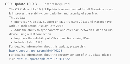

tling Posted May 15, 2014 Share Posted May 15, 2014 Smooth update to 10.9.3 Link to comment Share on other sites More sharing options...
sjpapa Posted May 15, 2014 Share Posted May 15, 2014 Yuppie!! 10.9.3 synch contacts between iOS and iMac again!!! No iCloud needed! Will try out and report.... Link to comment Share on other sites More sharing options...
