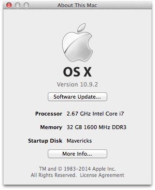

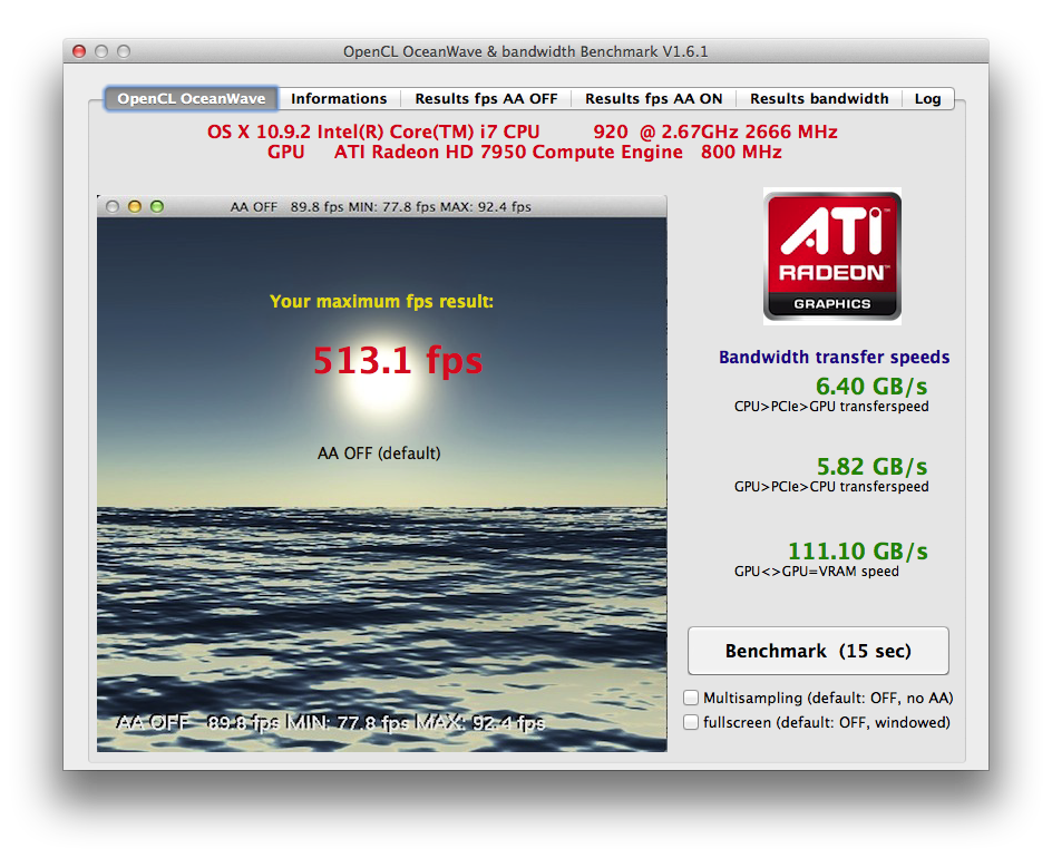

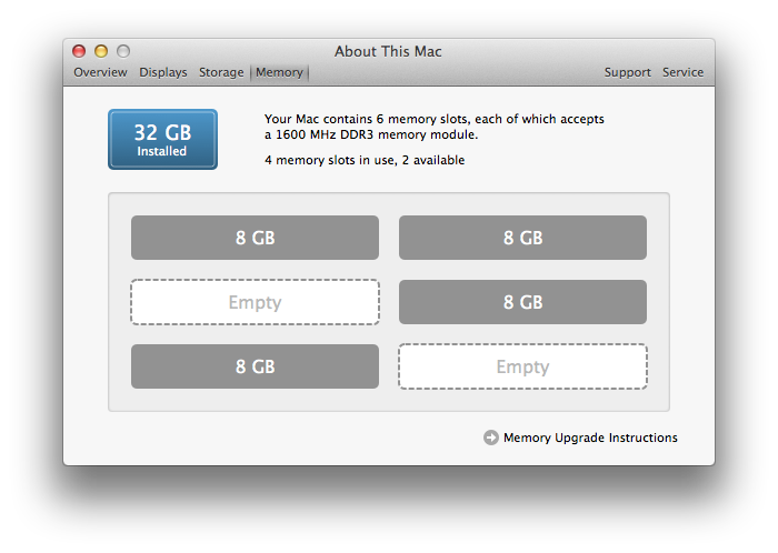

LocusOfControl Posted February 26, 2014 Share Posted February 26, 2014 Just for info, I'm in the process of giving my Hackingtosh an upgrade as it was getting a bit slow for my current needs I had been doing some video editing with Final Cut Pro, Motion 5, mObject etc and 12GB wasn't enough, I had to shut things down to get a reasonable speed. So I decided to swap my original 12GB Corsair for some 8GB sticks of Corsair Vengeance RAM The EX58-UD5 is quoted as supporting 6x4GB of RAM (24GB) . That seems a bit understated by Gigabyte because I've just upgraded to 32GB (4x8GB) and now plan to move to 48GB next month I'm also swapping my old ATI Radeon 4870 1GB for the SAPPHIRE HD 7950 3GB GDDR5 MAC Edition http://www.sapphiretech.com/presentation/product/product_index.aspx?cid=1&gid=3&sgid=1157&pid=1777&psn&leg=0&lid=1# yes I could have probably used the regular 7950 but to be honest I just wanted it to be stable and hassle free Just going to give the RAM a torture test before swapping the video card Edit - I compiled the N body simulator from the apple developer site, unfortunately it doesn't stop eating RAM at 32GB, kept ongoing to 140GB before I stopped it and maxes the cpu , at least the new RAM works and it isn't as painful as just 12GB was Now to swap the graphics card Link to comment Share on other sites More sharing options...
LocusOfControl Posted February 26, 2014 Share Posted February 26, 2014 Installed the 7950, big improvement on the OpenCL N body simulation (I'm interested in doing some OpenCL programming) with 4870 I was getting a score of approx 77, with the 7950 I was getting a really smooth 477 so I'm happy with that, feels like a new machine Just makes you wonder what a couple of FirePro W7000 would be like on the new mac pro, I thought about getting the W7000 but it was another £200+ so I thought the 7950 would be a good bang for the buck at £290 For info, I had to change GraphicsEnabler to No (it was Yes with the 4870) otherwise I got a black screen I may overclock my i7 920, currently running at a stock 2.88GHz for the past few years, may try to push it up to 3GHz Link to comment Share on other sites More sharing options...
Cosmin Petre Posted February 27, 2014 Share Posted February 27, 2014 Installed the 7950, big improvement on the OpenCL N body simulation (I'm interested in doing some OpenCL programming) with 4870 I was getting a score of approx 77, with the 7950 I was getting a really smooth 477 so I'm happy with that, feels like a new machine Just makes you wonder what a couple of FirePro W7000 would be like on the new mac pro, I thought about getting the W7000 but it was another £200+ so I thought the 7950 would be a good bang for the buck at £290 For info, I had to change GraphicsEnabler to No (it was Yes with the 4870) otherwise I got a black screen I may overclock my i7 920, currently running at a stock 2.88GHz for the past few years, may try to push it up to 3GHz Hey Locus I'm also looking for bit of speed bump on my EX58 UD5. Can you hook me up with links to the exact products you bought (Im in UK too) and can you confirm both RAM and Card are stable and work out-of -box without too much hassle (aside from changing GraphicsEnabler to No) . cheers! Link to comment Share on other sites More sharing options...
LocusOfControl Posted February 27, 2014 Share Posted February 27, 2014 Hi Petre I did a check on Google for best price and it was amazon, where else ;-) I paid £281.51 free post from a seller called Trusted Tech (last one I believe - quick delivery), having checked they have no more and the next best price on amazon is £308 if you look here you will see that some are selling at less than £300 https://www.google.co.uk/shopping/product/11433253530452994774?q=Sapphire+Radeon+HD+7950+Video+Graphics+card+3+GB+PCI-Express+16+DDR5+MAC&cr=countryUK%7CcountryGB&client=safari&rls=en&bav=on.2,or.r_qf.&bvm=bv.61965928,d.d2k,pv.xjs.s.en_US.mRllcBPSixs.O&biw=1336&bih=942&tch=1&ech=1&psi=zisPU4HDNqGH0AXerIGoAw.1393503183090.5&ei=2isPU8-COZKBhAeky4DoBw&ved=0CFYQpiswAA 513 FPS compares quite well with a 3GHz + mac pro with similar card (my hack is running at stock speed) One thing to note, the sapphire is a very nice looking card (better than the windows cards with all the fans etc) but your power supply will need two x six (6) pin pci-e power connectors which I had on my Hyper 880W psu. The old 4870 had a 6 pin and an 8 pin power connector Apart from that its plug and play, just change graphics enabler = N in your boot plist You may want to check out the windows version of the 7950 - I believe they will will work but I did read that there were some pci-e bandwidth issues ? (I'm not bothered - seemed like to much effort when this works out of the box) The RAM is this (note CL=9 there is a cheaper CL10) http://www.amazon.co.uk/gp/product/B0085IWXB8/ref=oh_details_o09_s00_i00?ie=UTF8&psc=1 Again, plug and play provide you put them in the correct slots 1,2,3,4 for 32GB I'm using Final Cut Pro, Motion 5 and motionfvx ( http://www.motionvfx.com/store,plugins,3,60,1,1.html ) plus Xcode with no trouble I have an SSD on my spare instance which would be faster but this is just on my old SATA drive, I assume the SSD would be faster (I don't use the SSD since it has clover boot loader and for some strange reason the sound doesn't work ? ) Link to comment Share on other sites More sharing options...
Cosmin Petre Posted February 27, 2014 Share Posted February 27, 2014 Thanks for your reply Locus Apart from that its plug and play, just change graphics enabler = N in your boot plist So, no kexts to install? Did you flip the switch to the Windows mode - to turn off the Apple EFI? thanks Link to comment Share on other sites More sharing options...
