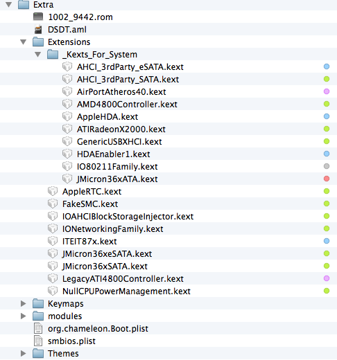

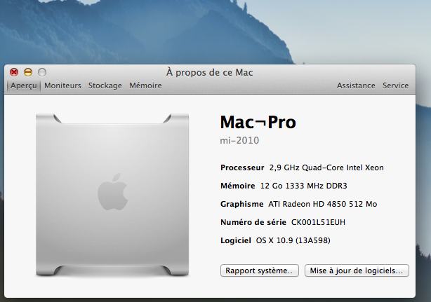

@ROBASEFR Posted October 12, 2013 Share Posted October 12, 2013 UPDATE: 10/12/13 - version 8.0 beta Link: HackInstaller 8.0 beta Hi d_d, Thank you so much to maintain this script for so long time ! I'm writing this with my new Mavericks GM ! and of course with your splendid new 8.0 beta script (whish Apple made beta's as you do ) My steps: 1. Created Mavericks Install disk with 10.9 GM 2. Install on dedicated harddisk (Mavericks GM) 3. From ML 10.8.5 installed with the script bootloader and kexts (changed some kexts for personal purpose) 4. Copied from ML/Extra to Mavericks GM/Extra ( DSDT.aml; org.chameleon.Boot.plist ; smbios.plist and my ati.rom) 5. Reboot on new Mavericks GM with bootflags -v -f 6. Migration of my account from ML10.8.5 disk 7. And it works very good, so far nothing weird (even my Google mail account has no problem ! ) Here are some snapshots Found updates for AHCI_3rdParty_eSATA.kext (0.4) AppleHDA.kext and HDAEnabler1.kext 2.4.7(-from toleda) for ALC885/889a Using USB3 card with GenericUSBXHCI.kext (1.2.6) Bye Link to comment Share on other sites More sharing options...

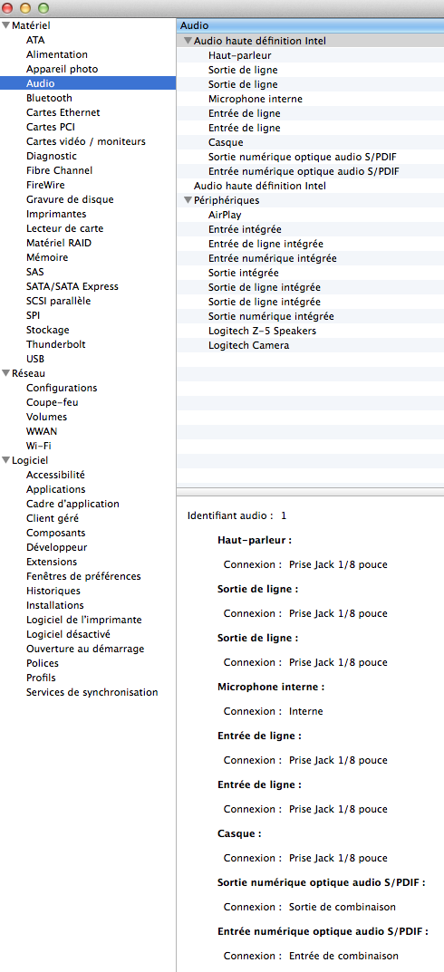

iLLNESS Posted October 12, 2013 Share Posted October 12, 2013 i seem to always have issues with audio every update. i can't seem to get it working again. what is the process for audio with your scripts? ive previously used mbeast to get it working with previous updates. i "think" ive cleaned out the old ##### stuff and reran this script. it installed the kexts to /Extra but i still do not have audio. i have a ga-ex58-ud5 so its 889a default behaviour is it installs applehda, hdaenabler, and alc885hda to /Extra UPDATE: 10/12/13 - version 8.0 betaLink: HackInstaller 8.0 betaGive it a try guys.There are a few known bugs, but hopefully no showstoppers. Link to comment Share on other sites More sharing options...
digital_dreamer Posted October 12, 2013 Author Share Posted October 12, 2013 iLLNESS,Those audio kexts should be installed in /System to work properly.That should do it!MAJ@ROBASEFR,Thanks for your feedback and updates! MAJ Link to comment Share on other sites More sharing options...
iLLNESS Posted October 12, 2013 Share Posted October 12, 2013 iLLNESS, Those audio kexts should be installed in /System to work properly. That should do it! MAJ @ROBASEFR, Thanks for your feedback and updates! MAJ ah okay thank you. i will have to try that next. i ended up just reinstalling kexts with mbeast and that ended up working. UPDATE: installing default kexts to /System worked. linein wasnt working like it normally was for me so removed ALC885HDA so now just left with AppleHDA and HDAEnabler1 and all is well. only issue i'm finding is rebooting takes FOREVER. Shutdown works normally but reboot takes a couple minutes. might just be something with maverick though i haven't really looked much. Link to comment Share on other sites More sharing options...

@ROBASEFR Posted October 18, 2013 Share Posted October 18, 2013 Hello MAJ, Well, after some days using my Mavericks GM on EX58-UD5 some comments on the 8.0 beta script: - I don't have sleep/ wake support any more (like ML with the same DSDT) - The script doesn't work 100% when I remove a kext in the 10.9 subfolders ( leaving the " kext to remove" in "/System/Extensions" ) and "Extra/_Kexts_For_System" folder Do I have to use a patched AppleACPIplatform.kext ? as some others suggest Has this something to do with PowerNap ? http://www.osx86.net/files/file/92-appleacpiplatformkext-for-os-x-109-dp%C2%B4s/ I tried also without NullCPUPowerManagement.kext ( which i didn't need in ML) , but no difference Thanks for your feedback Link to comment Share on other sites More sharing options...
digital_dreamer Posted October 20, 2013 Author Share Posted October 20, 2013 @ROBASEFR, Are you saying your system is not able to sleep at all? Is your DSDT modified, outside what the script does? I would try the following, if you haven't already: Boot with the NullCPUPowerManagement.kext installed and without a DSDT. Run the DSDT patcher in the script. Uninstall the NullCPUPowerManagement.kext and reboot. I've never used the AppleACPIplatform.kext. My system power naps - wakes periodically and checks email and does a Time Machine backup and goes back to sleep. However, there is not PowerNap on/off option in the Energy Saver preferences, like I've seen on various websites. Plus, sorry to say, I've never experienced the issue with kexts failing to uninstall from /System/Extensions and /Extra/...System when the kext is moved to the repository. Please provide me your install log and I'll look into it. digital(underscore)dreamer(at)mac(dot)com I realize everyone's system is different and everyone does things differently. That's why it's easy for me to run the script "flawlessly" because I wrote it and know what should be done or not done, and what should be expected. However, I'd be deluding myself to think everyone runs the script the same way I do. So, I really need to weed out those variables and make sure it's fool-proof. Just as an example, someone recently told me the script is unable to work properly in the OS installer. Then, I found out he renamed the script's folder after it got copied over. That broke the file path. Just a simple little innocent change like that can create a tremendous amount of frustration for the user. So, I've had to learn to not assume everything is going to go just precisely the way I expect them, and allow the script to be more forgiving and less rigid in its rules. I have lots of fixes coming up. best of wishes, MAJ Link to comment Share on other sites More sharing options...
