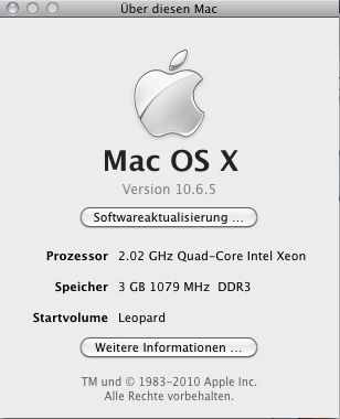

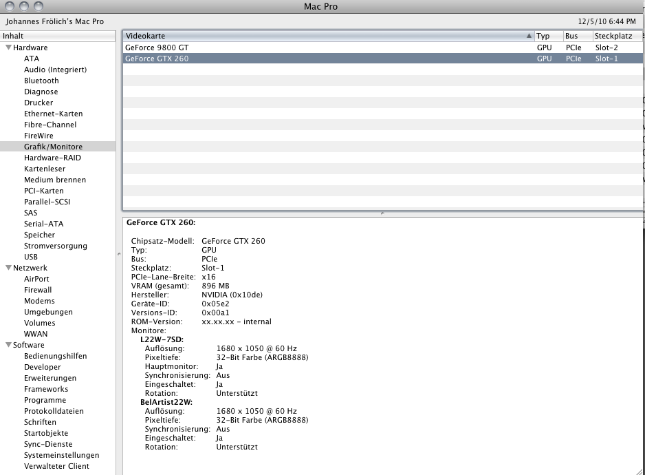

pcace Posted December 5, 2010 Share Posted December 5, 2010 Hey, im running 10.6.5 on my Hackintosh (i7 920, 3Gb Ram,AppleRAID0,GTX260, 9800GT) i Installed this via dd's script. Now i have 2 Performance Questions: is it possible that the i7 is not recogniced right? in the "about this mac" window it shows me a 2,02Ghz Quad-Core Intel Xenon... How can i check how fast my machine is in reality? Than next, is it possible to overclock tha machine easily? What do i have to do for that? Any hints? Now the second Question: i want to use openCL in Luxrender (luxrender.net) - Therefore i have the 2 Graphiccards installed. When i use the smalllux1.7.1 openCL Benchmark, it only sees the GTX260. It also not uses the CPU right! there is only very little load on it! The 9800GT is not recogniced as an openCL Device!? Where can i look for the Problems? ore does anyone now about this Problem? INITIALISING: 1 OpenCL platform found! [Platform 0] Name: Apple Vendor: Apple Version: OpenCL 1.0 (Aug 22 2010 18:08:16) Profile: FULL_PROFILE [OpenCL-only Context] 2 OpenCL devices found! [Device 0] Name: GeForce GTX 260 Vendor: NVIDIA Type: GPU Device Version: OpenCL 1.0 Driver Version: CLH 1.0 Compute Units: 24 Work Group Size: 512 Clock: 1242 MHz Global Memory: 896 MB Local Memory: 16 KB Cache Size: 0 KB Cache Line Size: 0 Bytes Available: Yes Double-Precision: No Extensions: cl_khr_byte_addressable_store cl_khr_global_int32_base_atomics cl_khr_global_int32_extended_atomics cl_APPLE_gl_sharing cl_APPLE_SetMemObjectDestructor cl_APPLE_ContextLoggingFunctions cl_khr_local_int32_base_atomics cl_khr_local_int32_extended_atomics [Device 1] Name: Intel® Core i7 CPU 920 @ 2.67GHz Vendor: Intel Type: CPU Device Version: OpenCL 1.0 Driver Version: 1.0 Compute Units: 8 Work Group Size: 1 Clock: 2024 MHz Global Memory (Total): 3072 MB Global Memory (Host): 2304 MB Global Memory (PCIe): 768 MB Local Memory: 16 KB Cache Size: 8192 KB Cache Line Size: 64 Bytes Available: Yes Double-Precision: Yes Extensions: cl_khr_fp64 cl_khr_global_int32_base_atomics cl_khr_global_int32_extended_atomics cl_khr_local_int32_base_atomics cl_khr_local_int32_extended_atomics cl_khr_byte_addressable_store cl_APPLE_gl_sharing cl_APPLE_SetMemObjectDestructor cl_APPLE_ContextLoggingFunctions [shared OpenCL+OpenGL Context] 2 OpenCL devices found! [Device 0] Name: GeForce GTX 260 Vendor: NVIDIA Type: GPU Device Version: OpenCL 1.0 Driver Version: CLH 1.0 Compute Units: 24 Work Group Size: 512 Clock: 1242 MHz Global Memory: 896 MB Local Memory: 16 KB Cache Size: 0 KB Cache Line Size: 0 Bytes Available: Yes Double-Precision: No Extensions: cl_khr_byte_addressable_store cl_khr_global_int32_base_atomics cl_khr_global_int32_extended_atomics cl_APPLE_gl_sharing cl_APPLE_SetMemObjectDestructor cl_APPLE_ContextLoggingFunctions cl_khr_local_int32_base_atomics cl_khr_local_int32_extended_atomics [Device 1] Name: Intel® Core i7 CPU 920 @ 2.67GHz Vendor: Intel Type: CPU Device Version: OpenCL 1.0 Driver Version: 1.0 Compute Units: 8 Work Group Size: 1 Clock: 2024 MHz Global Memory (Total): 3072 MB Global Memory (Host): 2304 MB Global Memory (PCIe): 768 MB Local Memory: 16 KB Cache Size: 8192 KB Cache Line Size: 64 Bytes Available: Yes Double-Precision: Yes Extensions: cl_khr_fp64 cl_khr_global_int32_base_atomics cl_khr_global_int32_extended_atomics cl_khr_local_int32_base_atomics cl_khr_local_int32_extended_atomics cl_khr_byte_addressable_store cl_APPLE_gl_sharing cl_APPLE_SetMemObjectDestructor cl_APPLE_ContextLoggingFunctions i use Graphics enabler in my boot plist. So there are no kexts/strings installed manualy. i Hope anyone can tell me why my CPU only runs @ 2024Mhz... Thanks, Pcace EDIT: One more Question: i Found the Chameleon.prefPane in the DD-Script fiolder. A nice Tool! THe Problem is - it has no effect when i change anything. Where can i find my actual used boot.plist?!? editing one of these plist also has no effect: Plist Selector: Modify which plist? (Script will ignore any plists located in EFI partitions.) Boot Plists: Partition Identifier Directory 1) For Kext Installer --disk2 Script 2) Boot OSX --disk1s3 Extra 3) Leopard (Apple RAID) --disk2 Extra | SMBIOS Plists Partition Identifier Directory 4) For Kext Installer --disk2 Script 5) Boot OSX --disk1s3 Extra 6) Leopard (Apple RAID) --disk2 Extra EDIT2: Im using the Cham_2.0_RC4_Asere Bootloader with these Kexts: Kext/kernel Installer: Files to be installed from the script's folders to Leopard - Extra: ATA VERSION ARCH SIZE DESTINATION (No files present to install) Audio 1) HDAEnabler.kext 1.0.0d1 x86_64 108K /Extra 2) LegacyHDA.kext 888 N/A 72K /Extra Graphics (No files present to install) Networking (No files present to install) Misc Patches 3) fakesmc.kext 2 x86_64 124K /System 4) NullCPUPowerManagement.kext 1.0.2 x86_64 80K /Extra Kernel & matching kext (No files present to install) Link to comment Share on other sites More sharing options...

pcace Posted December 6, 2010 Share Posted December 6, 2010 I don't know if the bootloader can inject info on more than one card. Anyone?The way most people do this is use a EFI string that contains both card info. My script will not work with this currently. You'll need to insert one card in the slot you intend to have it and grab the device tree for it once booted. Then, shutdown, pull it and insert the other card in the slot you intend to have it and grab its device tree. Once you have both device trees you can build a EFI string from them. For information on this, go in my script in /~extra/Resources/GFX_Strings/_info and you'll find some helpful web links on working with dual cards. That preference pane is designed to be used with the latest RC5 bootloader (not Cham_2.0_RC4_Asere). I should include a note regarding that. Hey, here is my instal-log: http://paste.ubuntu.com/540323/ i Hope it helps! But again my question: where can i find my boot.plist witch is used to boot my hackintosh? Thanks, Pcace Link to comment Share on other sites More sharing options...
