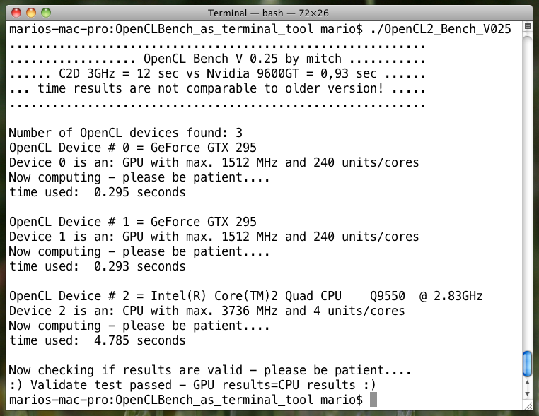

Good luck. I did this today to try to make this work so that I could run SL in 64-bit mode. The Netkas ATY_Init kext is currently only 32-bit. (this works for 32-bit if the EFI string doesn't work for you).
I'm attaching a picture which shows both GPUs being seen by OpenCL.

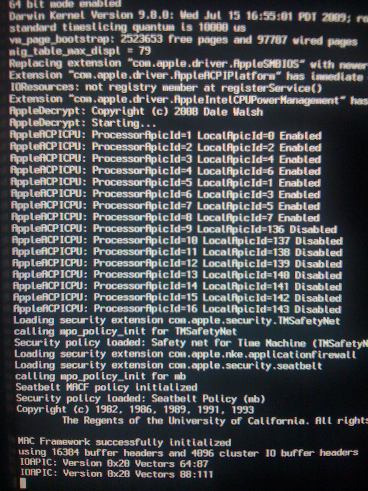

I can not even boot in Leo 10.5.8 with gtx 295 (single pcb)? -x or -s did not help.
I installed osx with NV 7600GS, then installed injector from netkas and gtx200 drivers after, on top of that insert 0x05eb10de&0xfff8ffff into the NVDANV50Hal.kext/Contents/Info.plist file using nano.
then run:
mount -uw /
chown -R 0:0 /System/Library/Extensions/ATY_Init.kext
chmod -R 755 /System/Library/Extensions/ATY_Init.kext
then reboot and replace the card to 295. Then nothing.
Last lines i can see are:
using 16384 buffer headers and 4096 cluster IO buffer headers
ing...
IOAPIC: version 0x20 Vectors 64:87
IOAPIC: version 0x20 Vectors 88:111
It perfectly boot back if I use NV7600 or even GTX9800+ without any street magic :shock: . So how could you manage to load osx with 295? What did i do wrong? I assume that before get right PciRoot key, OSX have to be loaded with GTX295 or I can use yours keys?
then run:
mount -uw /
For 10.5.x: Before rebooting, run sudo touch /System/Library/Extensions. Wait a minute afterwards. OS X will automatically update Extensions.mkext. ls -ltr /System/Library. Extensions.mkext should be the last file displayed. Make sure you have the latest Netkas ATY_Init extension. Check your BIOS and set to PEG1 (not sure which motherboard you're running on). You may need to press Ctrl-F1 once in bios for Gigabyte to see the additional options.
During the installation of OS X 10.5.x, the system used the VESA driver as the card (Single PCB Edition) was not properly detected due to card 05eb id.
You can go here http://forums.macrumors.com/showpost.php?p...p;postcount=236 where I documented how I got the EVGA GFX 295 Co-op edition to work under 10.5.x.
Good luck.

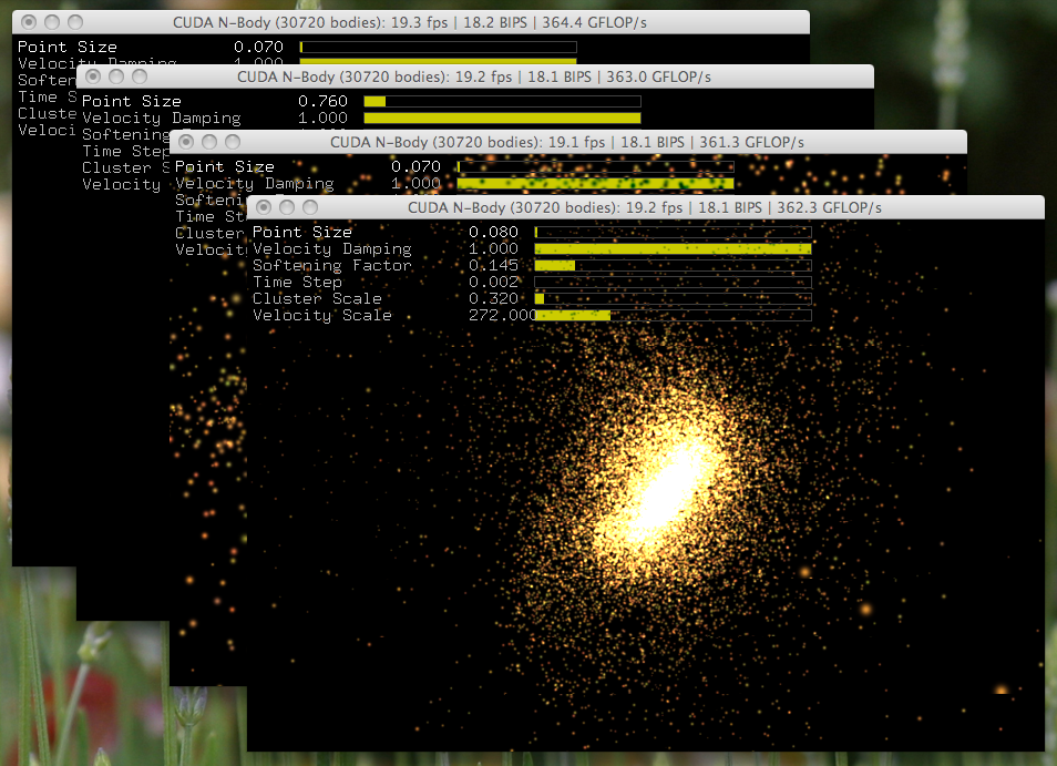

Here's a picture of 4 CUDA N-Body Demos running simultaneously under 10.5.8 via the following:
./nbody -device=0 &
./nbody -device=1 &
./nbody -device=2 &
./nbody -device=3 &
A good power supply is required to run 2 GTX 295 cards (4 GPUs) on a quad-core system. The 4 N-body demos and 4 CPU cores at 90% each requires 600 watts of power consumption. I have an Antec Signature 800w power supply.
## 1 GTX 295 Card
idle: 98 watts
2 N-Body demos: 310-320 watts (2 CPU cores at 90% each)
## 2 GTX 295 Cards
Idle: 153 watts
4 N-Body demos: 600 watts (4 CPU cores at 90% each)
Meroy, you're the man!! I was glad to see I was able to get my EVGA 295 CO-OP working with both monitors after installing 10.6.1. My only problem is that it's not showing up correctly. I followed your install but I can't seem to get it to show up. In System Profiler the 295 shows up correct in one slot and the other is shown as "Display" with no information shown. Do you know where I could of went wrong? I never installed any of the Netkas Enabler or Kext, was I supposed to? I have a Gigabyte UD5 board if that makes any difference. Any help would be appreciated. Thanks!
