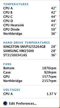

mm67 Posted July 22, 2010 Share Posted July 22, 2010 For CPU temps, there are a number of products that work. iStat menu is one that I'm using, and there's one called Temperature Monitor. One note: this board has a more aggressive cooling program than others I'm using (with F8 firmware). That is, when the CPU reads at 22*C it runs the fan at it's lowest setting (30%). Above that and the board runs on a scaled setting, up to 66*C (100% fanspeed). I'm investigating a way to raise the initial temperature because other boards have higher settings, meaning the fans will be quieter during idle. Drives me nuts how loud this is by default! And - iStat will only read the core temperatures, versus the "CPU temp" that the bios reads. In Windows there are programs that read both - my CPU reads 25* "CPU temp" and 41/39* "Core" temps. So if you see something high in iStat, don't worry. Check it in the bios, or boot into Windows to really check it. You can get both fan control and reading of all temp sensors by using a newer experimental version of FakeSMC from here : http://www.projectosx.com/forum/index.php?showtopic=1206 Link to comment Share on other sites More sharing options...
iRobie Posted July 22, 2010 Author Share Posted July 22, 2010 You can get both fan control and reading of all temp sensors by using a newer experimental version of FakeSMC from here : http://www.projectosx.com/forum/index.php?showtopic=1206 Great! I had no idea this existed! To use this: 1. Download FakeSMC from the link provided. 2. Right-click FakeSMC, show package contents. Go into plugins. Then delete X3100 plugin. 3. Delete fakesmc.kext from /Extra/Extensions 4. Install this fakesmc with Kext Utility (I installed via terminal, but Kext Utility puts it in /S/L/E and *should* work) I can't control the fans, but it reads them and reads CPU better. Thanks! Link to comment Share on other sites More sharing options...
mm67 Posted July 22, 2010 Share Posted July 22, 2010 Great! I had no idea this existed! To use this: 1. Download FakeSMC from the link provided. 2. Right-click FakeSMC, show package contents. Go into plugins. Then delete X3100 plugin. 3. Delete fakesmc.kext from /Extra/Extensions 4. Install this fakesmc with Kext Utility (I installed via terminal, but Kext Utility puts it in /S/L/E and *should* work) I can't control the fans, but it reads them and reads CPU better. Thanks! For fan control you need to edit SuperIO plugin's info.plist. On my Gigabyte boards both 4-pin fan headers can be controlled by this. Link to comment Share on other sites More sharing options...
tazito Posted July 22, 2010 Share Posted July 22, 2010 I think I only changed the HPET, and disabled unused components. Floppy Drive in particular will slow down Windows install to a crawl. If there are more changes I'll edit the first page. I added a BIOS section but it's pretty bare since I haven't changed anything in a few months. I wouldn't recommend installing MyHack to your SATA drive then ridgeline's on top of that. That's asking for trouble! I'm glad you got it working though Use MyHack to make a USB bootable stick or drive, then install Ridgeline to your main HDD. I've had success with two different 400 firewire cards. I went PCI first, but it was too large with my video card's massive heatsink & fan. This PCI card worked: SYBA PCI to Firewire PCI-E card sits just fine about the vid card. This is the one I have: SYBA 2 Ports PCI-E IEEE 1394A For CPU temps, there are a number of products that work. iStat menu is one that I'm using, and there's one called Temperature Monitor. One note: this board has a more aggressive cooling program than others I'm using (with F8 firmware). That is, when the CPU reads at 22*C it runs the fan at it's lowest setting (30%). Above that and the board runs on a scaled setting, up to 66*C (100% fanspeed). I'm investigating a way to raise the initial temperature because other boards have higher settings, meaning the fans will be quieter during idle. Drives me nuts how loud this is by default! And - iStat will only read the core temperatures, versus the "CPU temp" that the bios reads. In Windows there are programs that read both - my CPU reads 25* "CPU temp" and 41/39* "Core" temps. So if you see something high in iStat, don't worry. Check it in the bios, or boot into Windows to really check it. I'm betting it was you who left the review in newegg that's funny....I'm getting that one, I need it for all the video transferring and editing for school. Link to comment Share on other sites More sharing options...
iRobie Posted July 25, 2010 Author Share Posted July 25, 2010 For fan control you need to edit SuperIO plugin's info.plist. On my Gigabyte boards both 4-pin fan headers can be controlled by this. Can you upload your FakeSMC file? I've tried a lot of different combinations... latest rev w/ SuperIO, w/ SMCITEController, rev218, rev190. Finally with rev171 & Info.plist editing on SuperIO I can set fan speed in iStat, but it does nothing. And yes, in my various attempts I did change temps in SuperIO The console messages always said the same - setting starting temp at 20, even if I changed that to 40 or something else. You're not on the G41M, are you? Has anyone gotten fan control working with the G41M? This FakeSMC allows you to see CPU temps, fan speeds, and GPU temps so it's a great addition! I'm just getting greedy :-D Win7 averages about 1000rpms (basically silent) while OSX averages ~1450rpms on my Arctic Freezer CPU fan, and I'm trying to find out why. Link to comment Share on other sites More sharing options...
mm67 Posted July 25, 2010 Share Posted July 25, 2010 Can you upload your FakeSMC file? I've tried a lot of different combinations... latest rev w/ SuperIO, w/ SMCITEController, rev218, rev190. Finally with rev171 & Info.plist editing on SuperIO I can set fan speed in iStat, but it does nothing. And yes, in my various attempts I did change temps in SuperIO The console messages always said the same - setting starting temp at 20, even if I changed that to 40 or something else. You're not on the G41M, are you? Has anyone gotten fan control working with the G41M? This FakeSMC allows you to see CPU temps, fan speeds, and GPU temps so it's a great addition! I'm just getting greedy :-D Win7 averages about 1000rpms (basically silent) while OSX averages ~1450rpms on my Arctic Freezer CPU fan, and I'm trying to find out why. No, I don't have the same board, but on this case that doesn't matter. Our boards have same SuperIO chip and that's enough in this case. SuperIO chip has 3 PWM outputs so you need to first figure where fan headers are connected. My EP45-UD3 for example has CPU_FAN connected to output 2 and SYS_FAN2 to output 1, output 0 is not connected at all. This is how I control SYS_FAN2 header: <key>Fan1</key> <dict> <key>Force Detection</key> <true/> <key>Name</key> <string>Bottom</string> <key>Software Fan Control</key> <dict> <key>Enabled</key> <true/> <key>High Temperature, ℃</key> <integer>50</integer> <key>High Throttle, %</key> <integer>100</integer> <key>Start Temperature, ℃</key> <integer>30</integer> <key>Start Throttle, %</key> <integer>50</integer> <key>Temperature Source</key> <string>System</string> </dict> </dict> And Software Fan Control section looks like this: <key>Software Fan Control</key> <dict> <key>Enabled</key> <true/> <key>Voltage Control</key> <false/> </dict> That's a 4-pin PWM controlled fan that is controlled by System temperature, other option would be to use Processor as temperature source. With these settings fan runs on 50 % speed at 30 C and accelerates to 100 % if System temperature reaches 50 C. Link to comment Share on other sites More sharing options...
iRobie Posted July 30, 2010 Author Share Posted July 30, 2010 No, I don't have the same board, but on this case that doesn't matter. Our boards have same SuperIO chip and that's enough in this case. SuperIO chip has 3 PWM outputs so you need to first figure where fan headers are connected. My EP45-UD3 for example has CPU_FAN connected to output 2 and SYS_FAN2 to output 1, output 0 is not connected at all. This is how I control SYS_FAN2 header: Ah, thanks! The Fan2 thing is kind of strange. Fan0 is the one with the RPM monitor, but Fan2 is the one with the temp controls. Getting rid of one breaks the system I have... very strange. And I don't know if I saw the end section either, thanks for pointing that out! On this board, the SYS_FAN isn't a PWM fan. I tried plugging in a fan there & controlling it with software but wasn't too successful. Could be because I called it SYS_FAN (instead of SYS_FAN2), or because I had Voltage = FALSE like you suggested, which to me indicates a 3 pin fan wouldn't work. Who knows? But I have it plugged into a fan controller anyway, so I have very little incentive to fix it. For anyone else that wants to slow down or speed up there CPU fan, I've attached three FakeSMCs in this archive: FakeSMC-reallyslowfan: 25*/5% fan, 70*/100% fan FakeSMC-slowfan: 25*/5% fan, 60*/100% fan FakeSMC-fastfan: 30*/50% fan, 50*/100* fan So, if you want to overclock and want to keep low temps, use fast fan. If you have a processor with a TCore of 64 but want as quiet as you can, go for slowfan. And if you have a higher Tcore processor and want quiet, use reallyslowfan. To use any, first delete FakeSMC.kext from /Extra/Extensions. Then use Kext Utility to install whatever kext you want, after unzipping of course And if you want to set temps yourself, take any of the FakeSMC files, and find: FakeSMC.kext/Contents/PlugIns/FakeSMCSuperIO.kext/Contents/Info.plist Edit that file. Change "Fan2" settings to match your needs. Then run Kext Utility again & reboot. FakeSMC_fanspeeds.zip Link to comment Share on other sites More sharing options...
mm67 Posted July 30, 2010 Share Posted July 30, 2010 On this board, the SYS_FAN isn't a PWM fan. I tried plugging in a fan there & controlling it with software but wasn't too successful. Could be because I called it SYS_FAN (instead of SYS_FAN2), or because I had Voltage = FALSE like you suggested, which to me indicates a 3 pin fan wouldn't work. Who knows? But I have it plugged into a fan controller anyway, so I have very little incentive to fix it. If you use 4-pin PWM fans then you set Voltage control disabled, with 3-pin fans you need to enable Voltage control. Link to comment Share on other sites More sharing options...
iRobie Posted July 30, 2010 Author Share Posted July 30, 2010 If you use 4-pin PWM fans then you set Voltage control disabled, with 3-pin fans you need to enable Voltage control. That's exactly what I was thinking. This board has a 4-pin CPU Fan & a 3-pin Sys fan. If the SuperIO can't mix and match, it can only control one at a time. Link to comment Share on other sites More sharing options...
mm67 Posted July 30, 2010 Share Posted July 30, 2010 That's exactly what I was thinking. This board has a 4-pin CPU Fan & a 3-pin Sys fan. If the SuperIO can't mix and match, it can only control one at a time. I don't think that you can control the 3-pin header, at least on my board that is not possible. I have 2 3-pin headers and 2 4-pin headers and only 4-pin ones can be controlled. If you want to control more than one fan then this is a great solution : http://www.akasa.com.tw/update.php?tpl=pro...;model=AK-CB002 Link to comment Share on other sites More sharing options...
