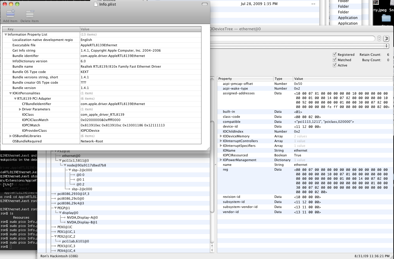

The PCI device shows up in the device tree, but for some reason, the kext isn't loading it properly as a device. I've uploaded a pic of the IORegistry entry as well as the Info.plist for the kext... do you see any issues there?
download this Kext Utility
and run it. it repairs permissions for you.

The problem seems to be that i was running the 64bit kernel, and it didn't want to load the driver. I'm trying the 32 bit kernel now. I got it to load once though by booting in to single user mode, using kextload to load the driver, then continue booting.
But, i haven't been able to get it to boot since with the NIC working.
did you try these flags -arch=i386 -x32 -v

The only way i've been able to get it to work is to boot in to single user mode (-s -f -x32 for good measure), THEN use "kextload AppleRTL8139.kext" (even though it already tried and failed to load with the error below) then type "exit" to continue booting. This seems to work for either the 64bit or 32bit kernel.
If I use -x32, it tries and fails to load AppleRTL8139 saying something like "mach-o file malformed invalid magic number xfeedface".
I'm thinking RTL8139 either needs to load earlier or later in the boot process...
ohhh did you remove the one from your extra folder?
remove it then download a new kext and place that one in system/library/extensions/
run kext utility to repair permissions
ya its probably booting without the required dependency kexts.
