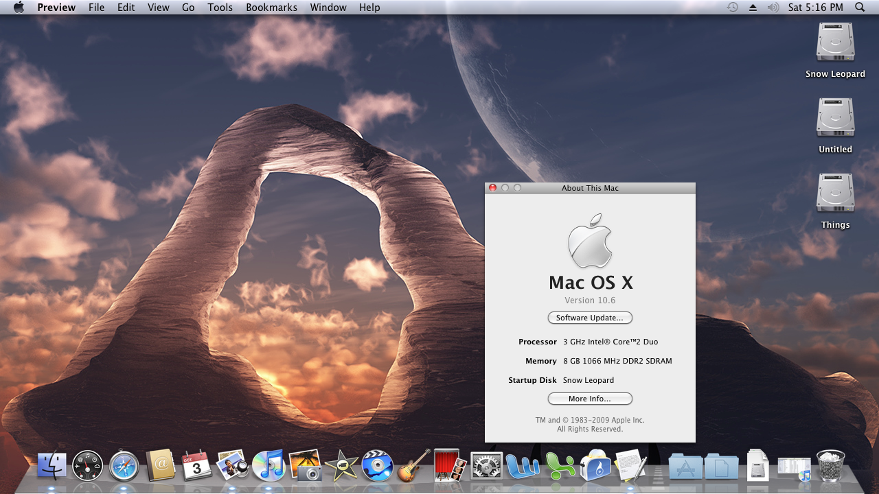

kr0nic Posted October 4, 2009 Share Posted October 4, 2009 First off I want to thank everyone that helped! Doom42 for this wonderful guide and Insanely Mac as a whole!!! System: Intel Core 2 Duo E8400 3GHz Gigabyte EP45-UD3P 8GB DDR2 RAM 2x 320GB HD eVGA nVidia GeForce 9400 GT 1GB Install Method: 2 Hard Drives. 1 blank, 1 with leo Doom's guide. SL installed within a Leo setup, via image file. My special steps to this guide. Used 3 outs 2 ins audio kext from the SL pack to get my digital working. the green legacy kext. (ALC889A) Used a DSDT.aml file posted by crash alert at this forum: http://www.insanelymac.com/forum/index.php?showtopic=183502 (Tried to manually create a dsdt file but i kept getting errors) (COPIED VIDEO EFI STRINGS DIRECTLY FROM MY LEO INSTALL, NO PROGRAM, SIMPLE COPY AND PASTE!) after install, and modifications to the new drive first boot with -v -x32. went through setup quickly, after intro video, to get to spot light before the panic.... too late, still panic! 2nd reboot, -v -x32, setup was done, went directly to desktop, got to spotlight and hid my drives under privacy. still got another panic. 3rd reboot -v -x32, went back to spotlight and took the privacy off my drives and typed a word in the search box on the upper right hand corner of the spotlight window to index my drives... NO PANIC. 4th reboot. Normal boot, no boot flags. STABLE NO PANICS!!!! UP FOR ALMOST 12 hours. did some updates, installed all my programs. everything seems stable! SL is flying!!! xbench looks good, everything seems to be in working order. Once again. Thank everyone for all the hard work! Hope this helps someone! Here is my extra folder!!! (dsdt file, legacy kext, etc...) Remember to change your EFI STRINGS for video card, UUID's for hard drive, SMBIOS, and appropriate kexts! this audio kext is for the alc889a on the EP45-UD3P, digital out works! extra.zip Link to comment Share on other sites More sharing options...
seanmcd Posted October 4, 2009 Share Posted October 4, 2009 Thanks for the info. I'll probably just buy the Patriot ram that the guy in the other guide recommended as it seems to work for him. I'm sure I'll be back on this thread as soon as my hardware arrives. Mushkin ram works fine and it's usually cheap Link to comment Share on other sites More sharing options...
d00m42 Posted October 4, 2009 Author Share Posted October 4, 2009 First off I want to thank everyone that helped! Doom42 for this wonderful guide and Insanely Mac as a whole!!! System: Intel Core 2 Duo E8400 3GHz Gigabyte EP45-UD3P 8GB DDR2 RAM 2x 320GB HD eVGA nVidia GeForce 9400 GT 1GB Install Method: 2 Hard Drives. 1 blank, 1 with leo Doom's guide. SL installed within a Leo setup, via image file. My special steps to this guide. Used 3 outs 2 ins audio kext from the SL pack to get my digital working. the green legacy kext. (ALC889A) Used a DSDT.aml file posted by crash alert at this forum: http://www.insanelymac.com/forum/index.php?showtopic=183502 (Tried to manually create a dsdt file but i kept getting errors) (COPIED VIDEO EFI STRINGS DIRECTLY FROM MY LEO INSTALL, NO PROGRAM, SIMPLE COPY AND PASTE!) after install, and modifications to the new drive first boot with -v -x32. went through setup quickly, after intro video, to get to spot light before the panic.... too late, still panic! 2nd reboot, -v -x32, setup was done, went directly to desktop, got to spotlight and hid my drives under privacy. still got another panic. 3rd reboot -v -x32, went back to spotlight and took the privacy off my drives and typed a word in the search box on the upper right hand corner of the spotlight window to index my drives... NO PANIC. 4th reboot. Normal boot, no boot flags. STABLE NO PANICS!!!! UP FOR ALMOST 12 hours. did some updates, installed all my programs. everything seems stable! SL is flying!!! xbench looks good, everything seems to be in working order. Once again. Thank everyone for all the hard work! Hope this helps someone! Here is my extra folder!!! (dsdt file, legacy kext, etc...) Remember to change your EFI STRINGS for video card, UUID's for hard drive, SMBIOS, and appropriate kexts! this audio kext is for the alc889a on the EP45-UD3P, digital out works! extra.zip Sounds GREAT! You had a similar setup to my E8500/UD3R, so the instructions worked as they should have : ) Anyways just to let everyone know, the LAN power issue between Windows XP and OS X WASN'T solved by having "LAN Boot ROM" on in the BIOS (not sure why it didn't work, it should in theory), and I guess the XP w/ Chameleon issue is really only fixable if I install Chameleon on the XP disk and I don't really feel like it's worth all of the trouble. My one question is, however, if I get Windows 7 sometime can I upgrade my XP install to 7 and have the boot-through-Chameleon working? Will XP be able to be upgraded directly to 7? Link to comment Share on other sites More sharing options...

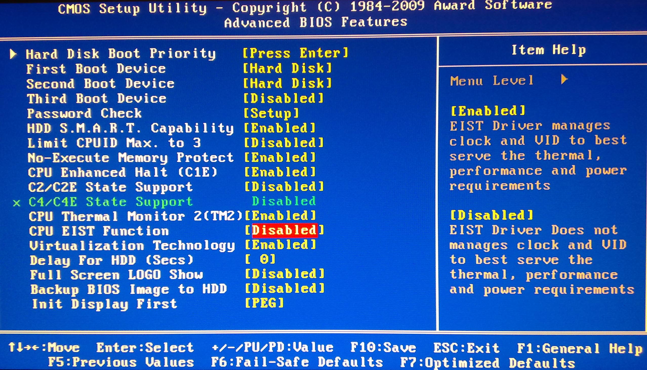

reason4u Posted October 4, 2009 Share Posted October 4, 2009 hi, every body talks about GA-EP45-UD3P board, what about GA EP45-EXTREME, is it not good one for hackintosh? I have that one. and you know how to run mac on this very fast? I have intel core 2 quad 9650 3.00 GHz and Nvidia 9800GTX+ graphic, 8 gig OCZ Ram PC8500, 750W power supply. but its not that fast, for example when I run Garage Band, when I play some traks on it, the cpu goeas down and the sounds is crashing, I have External sound car Edirol Ua-25, dont know why? and I cant play for example Call of duty 4 on it, its too lagy, graphic seems to be not very good on it. if know what I must do plzz tell what can I do? and u know Im living in Norway, I cant find GA-EP45-UD3P board, its not comming to norway any more . sorry for my bad english. thanks for ur attention Hadi Link to comment Share on other sites More sharing options...
Squirrelf Posted October 4, 2009 Share Posted October 4, 2009 hi, every body talks about GA-EP45-UD3P board, what about GA EP45-EXTREME, is it not good one for hackintosh? I have that one. and you know how to run mac on this very fast? I have intel core 2 quad 9650 3.00 GHz and Nvidia 9800GTX+ graphic, 8 gig OCZ Ram PC8500, 750W power supply. but its not that fast, for example when I run Garage Band, when I play some traks on it, the cpu goeas down and the sounds is crashing, I have External sound car Edirol Ua-25, dont know why? and I cant play for example Call of duty 4 on it, its too lagy, graphic seems to be not very good on it. if know what I must do plzz tell what can I do? and u know Im living in Norway, I cant find GA-EP45-UD3P board, its not comming to norway any more . sorry for my bad english. thanks for ur attention Hadi maybe your computer gets stuck in speed step you can try disableing c2/c4 and EIST (aka speedstep) Link to comment Share on other sites More sharing options...
reason4u Posted October 4, 2009 Share Posted October 4, 2009 hi again. you know I don't know any thing about (disableing c2/c4) and EIST (aka speedstep), you mean overcolocking? I don't have any experience of these things. can you give me some links or guides, how to do this? can you tell me what is the best Mother board for hackintosh right now?(what is the model) thank you maybe your computer gets stuck in speed stepyou can try disableing c2/c4 and EIST (aka speedstep) Link to comment Share on other sites More sharing options...
Squirrelf Posted October 4, 2009 Share Posted October 4, 2009 hi again.you know I don't know any thing about (disableing c2/c4) and EIST (aka speedstep), you mean overcolocking? I don't have any experience of these things. can you give me some links or guides, how to do this? can you tell me what is the best Mother board for hackintosh right now?(what is the model) thank you speedstep is an automatic downclocking when idle onload it should go back to full speed, but may not in macos, depends on many little things c2/c4 is similar in some way, it actually shutdown some part of the cpu when idle you'll see those option in the bios (second or third item in the main bios menu) both are located under the same page it will clearly say "c2/c4" and "EIST" set them both to disabled, don't touch anything else Link to comment Share on other sites More sharing options...
reason4u Posted October 4, 2009 Share Posted October 4, 2009 Thank you man. Im going to bios right now, will be back and tell what happening Link to comment Share on other sites More sharing options...
reason4u Posted October 4, 2009 Share Posted October 4, 2009 its seems very ok right now, I just Disabled EIST and c2/c4 was disabled. I attached a picture of the BIOS, if any thing wrong plzz tell me I dont know how to thank you. Thank u very very much. Link to comment Share on other sites More sharing options...
