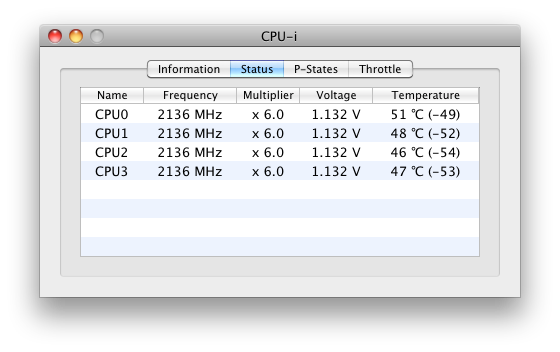

Eliade: Have you tried to lower the voltage for the minimum stepping? That should get the temps down even more. And hey, if it makes the system unstable, just change it back :-)
Sorry to answer this with a quote, but Superhai posted a pretty good explanation:
Ergo don't edit SystemIO. Do edit the FFixedHW.
thanks, that's exactly what I wanted

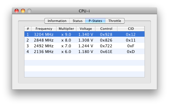

is it normal that I get only two stepping (x9 and x6) from linux dump, and/or should I add x7 and x6 manually
cpu-i P-states display four of them
but you have newer cpu than my q6600 so maybe I get only two and you get four...
and I suppose that if I change the overclock of my system I should change the dsdt speedstep settings again, am I right?
one more question if you know the answer, is that dsdt overriding the vcore in the bios even at full milti (x9)?

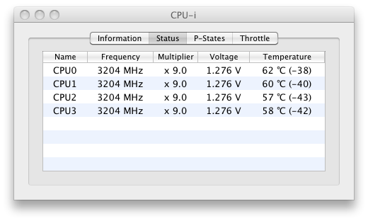

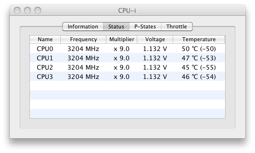

ABOUT SPEEDSTEP
at full multi (x9 in my case) the step setting in the dsdt doesn't do anything
I can set the voltage very low, sure cpu-i will display something lower
but I know my system is not a 1.132v, (bios is at 1.325), as of now mprime is super stable
if I change the bios down to even 1.275 keep the dsdt like before, my system crashes less than a minute after using mprime...
so what proof do I have that the system is actual using a lower vcore when I'm speedstepping down to x6 ? the temperature make me think I'm actually running at full 1.325vcore even at x6
I don't think cpu-i can really be fully trusted
I'll keep on experimenting
edit:
I added speedstep x7 and x8 to the x6 an x9 I already had, seems to work well
however, looking at the idle temperature, I really don't believe at least on my computer that speedstepping is actually reducing the voltage... even if cpu-i sows it, I know the display is wrong at x9... it's more like cpui is reading the dsdt/ssdt instead of getting actual hardware values...
I noticed however that if I set a voltage too low in the dsdt for the x6 step, it won't go in x6 very often, actually almost never, so I keep it at the pstate cpui advise, and now it stays at x6 when idle, temperature are still around 49~50°C when it is around 39~42°C without the dsdt speedstep fix
so I don't see the point of using speedstep with this setup

inspired by GA-P35-DS4 experience, I succeeded. So For those who suffered from the last step to success, I suggest guys to install the package from this:
http://www.insanelymac.com/forum/index.php?showtopic=184367, install the The GA-P35-DS4 Snow Leopard Installer (Get it here: http://www.mediafire.com/file/ndmrymdqgdz/...now%20Pack.pkg), then you're probably in, better boot with -v -x32 for first time .
Mine now is running pretty smoothly under both 32bit and 64bit.
