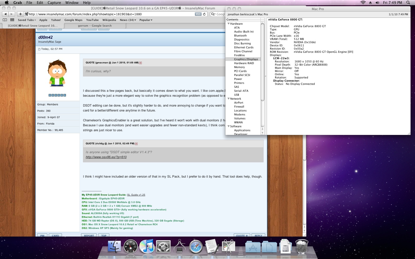

Can someone help me with my 8800GT still can't get QE/CI.
Try this com.apple.Boot.plist EFI string:

Well how I check for QE/CI is to got to About This Mac > More Info > Graphics/Displays and seeing if it has everything enabled and my graphics card shows up.
I would use a com.apple.Boot.plist EFI string. Try the one I gave you a few posts up.
Will do I'll post back with results.
Appreciate the help.
EDIT: Gorram idiot....I had the extension of my com.apple.Boot as txt.
QE/CI now enabled.

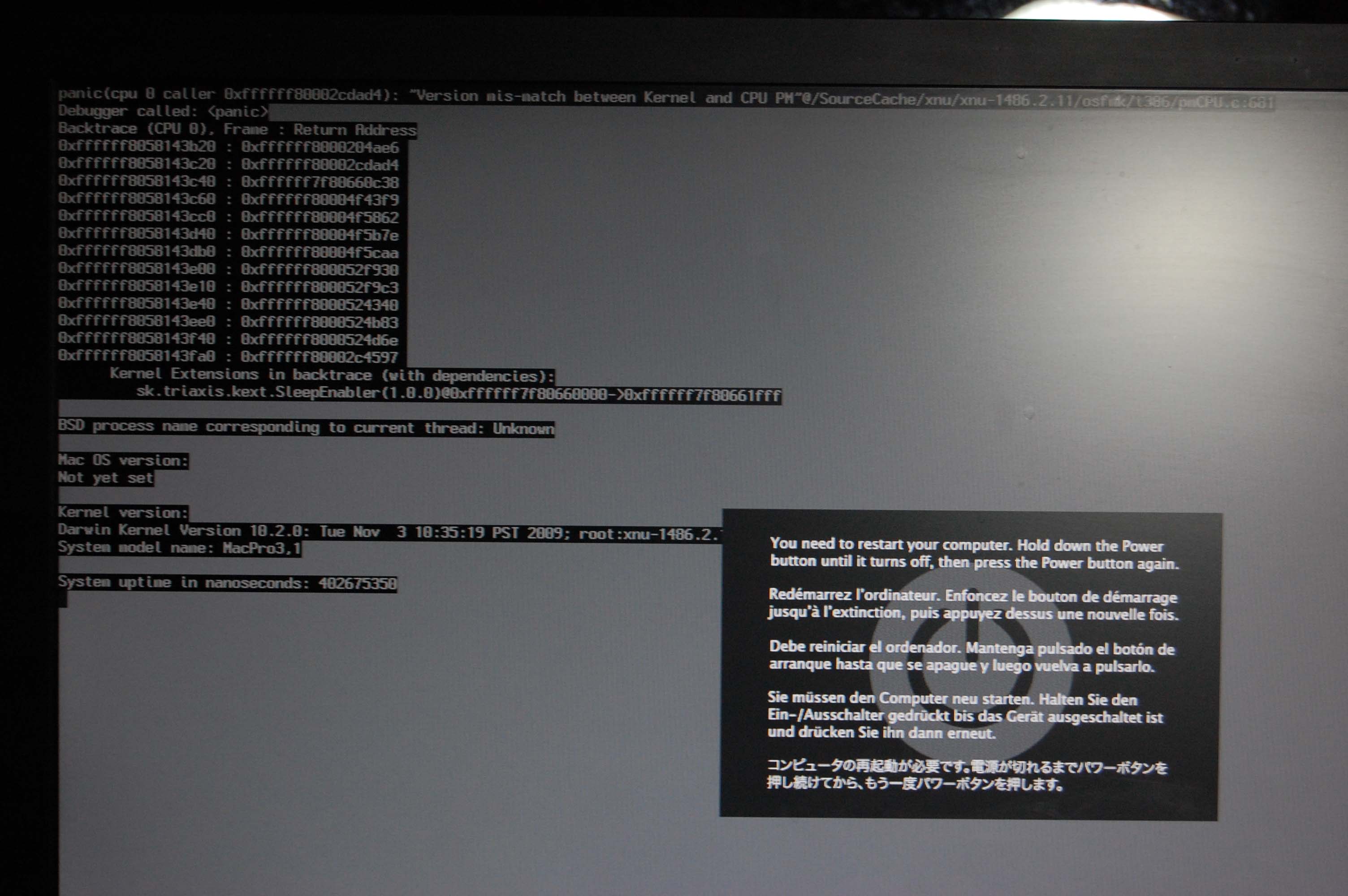

Hmmm Installed 10.6.1 update no problems. But kernel panic after installing 10.6.2 after restart.
EDIT: Looks like sleepenabler is the culprit. Others seem to have the problem.
EDIT 2: I'm now using the kexts from d00m42's SL Pack v5.0b. It works! I'm in 10.6.2 now.
I'll see how it goes from here.
Yep, always make sure before you run an update that all your kexts are up to date. Glad to hear it's running smoothly so far. Keep me posted!

How did it break your install? Make sure you do NOT have old SleepEnabler.kext installed when you update or it will kernel panic the whole way home and back.

alright i tried finding that sleepenabler.kext and it wasnt in there, its basically bricking me out of using snow leopard, and then gives this greyed out screen telling me to reboot and what not.
If you updated to 10.6.2 without making sure to switch it out, it's almost certainly the problem.
Look in /S/L/E and /E/E using Single User Mode (boot with -s).
