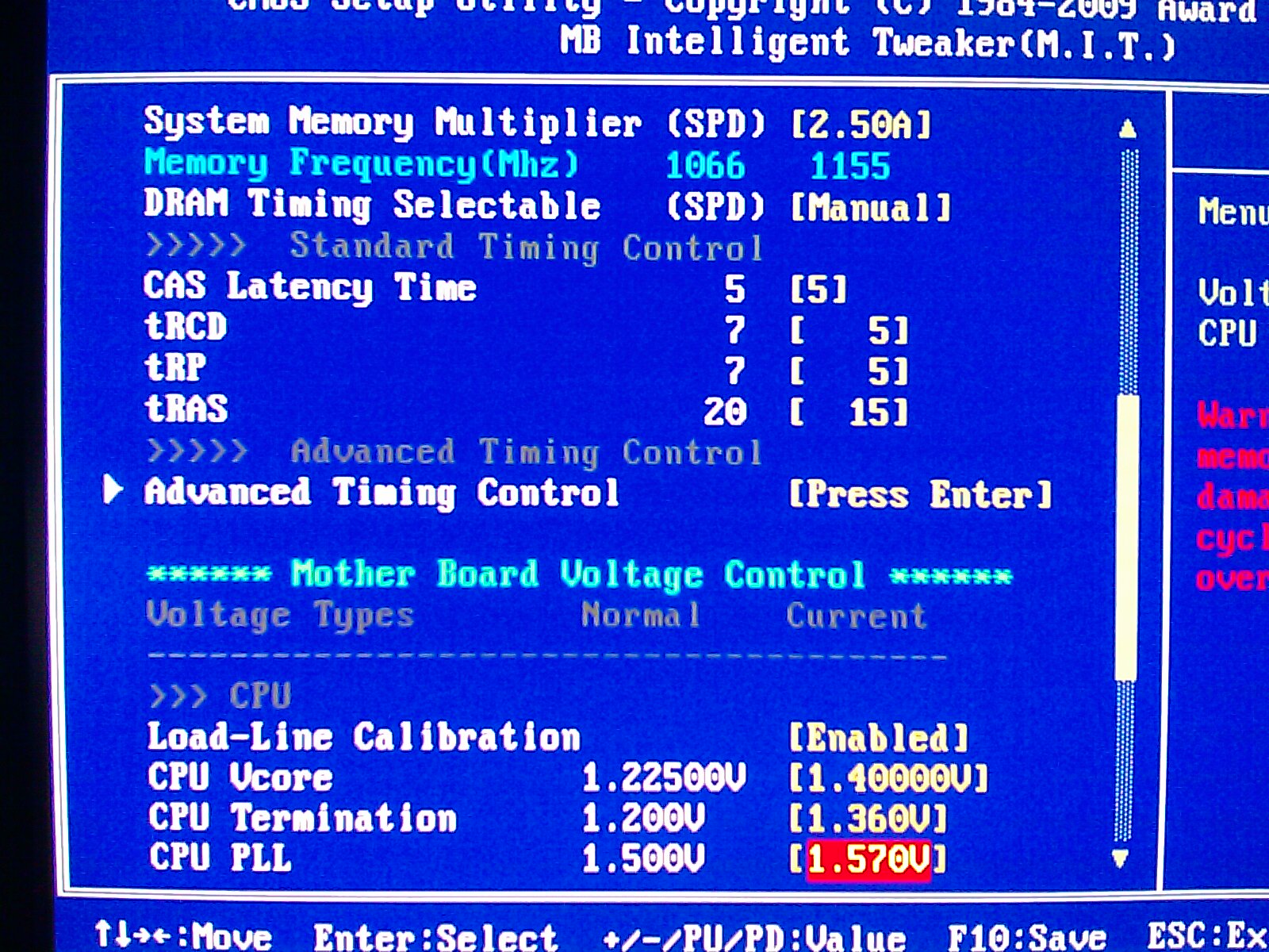

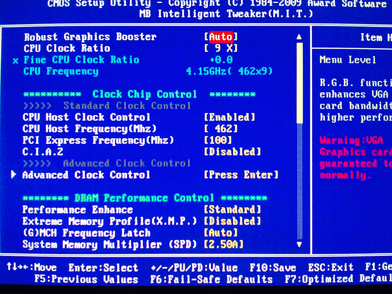

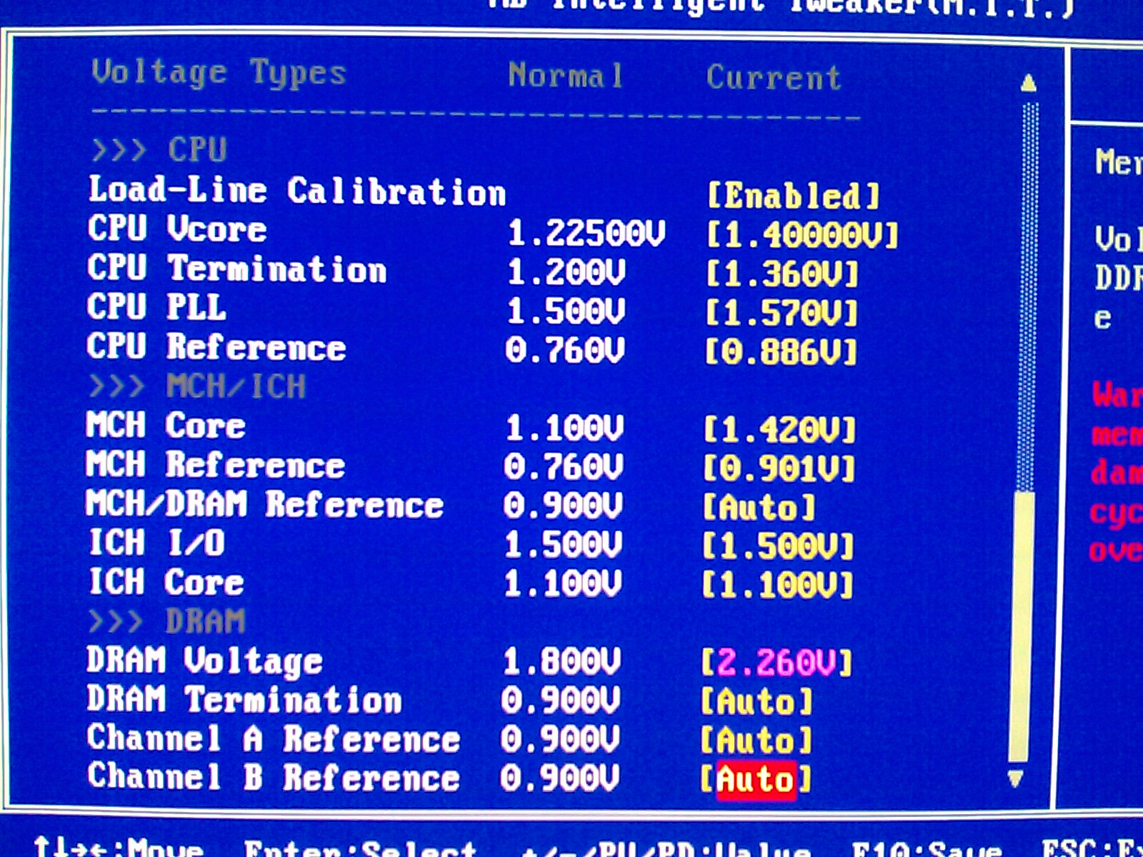

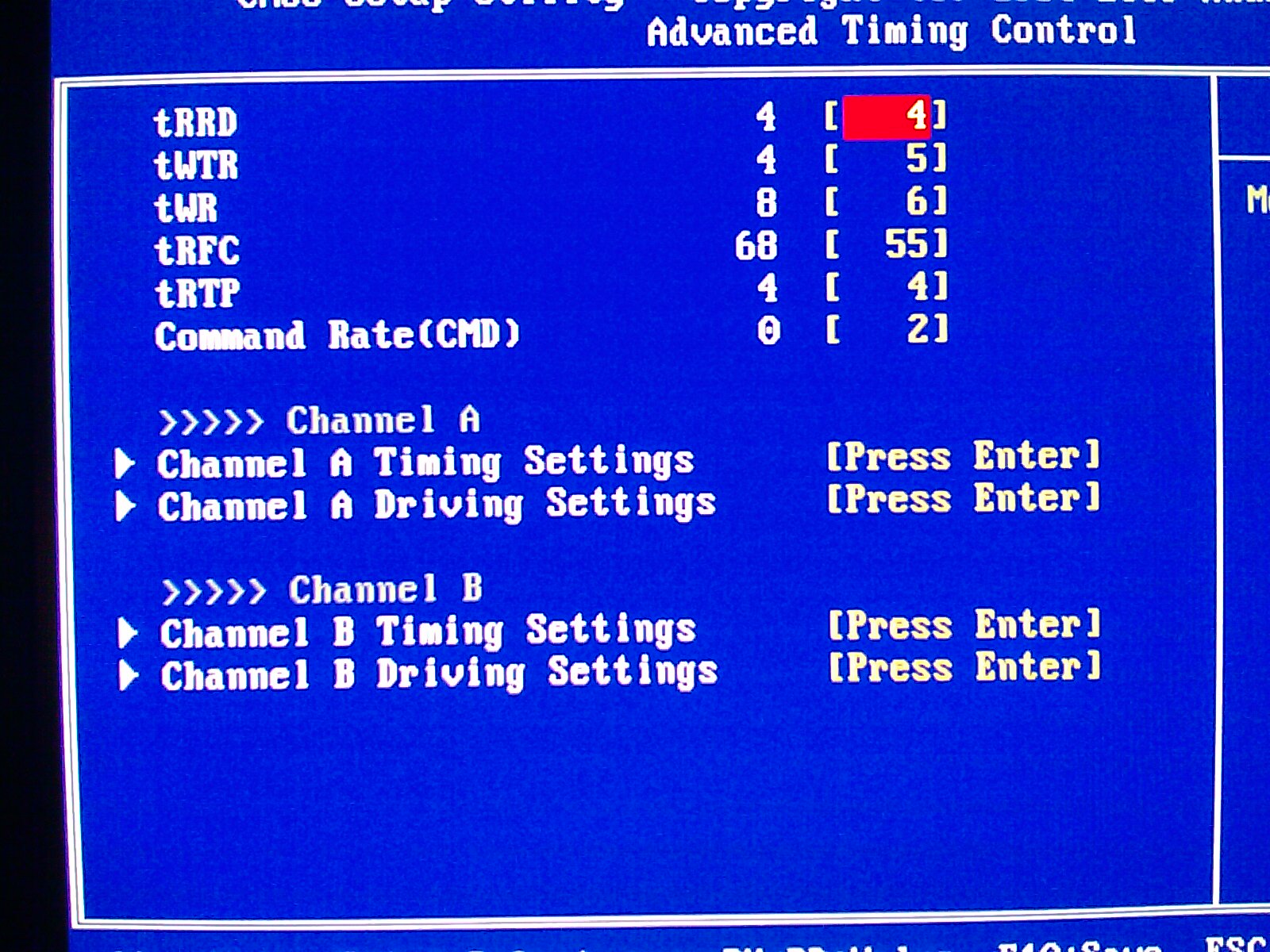

Do you think you can post your ram settings you have in your bios. I think i have the same set but im having trouble running it stable on this board. Thanks
Just for you :unsure:
My Ram is overclocked alot...But I've tested it extensively in Windows. I've been overclocking for a long time so I know it's stable.
For guaranteed stability, use the 2.0D divider, the Ram will be slower but you can tighten up the timings...such as 5-5-4-12 PL 8. Ram is funny, you just have to try ONE setting at time, reboot and test, change one thing, reboot and test...long process but once you find the perfect settings it'll be worth it :)

Just for you :(
For guaranteed stability, use the 2.0D divider, the Ram will be slower but you can tighten up the timings...such as 5-5-4-12 PL 8. Ram is funny, you just have to try ONE setting at time, reboot and test, change one thing, reboot and test...long process but once you find the perfect settings it'll be worth it :D
Thanks im going to give this a shot.

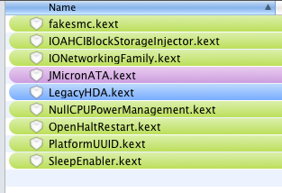

Hm, I think I got all the big quirks (cord stuck in CPU-fan being one of them, eh) sorted out now.
I'm running SL 10.6.1 with the following:
DSDT:
- gfx
- lan
- sound
- usbehc (built-in high speed fix)
- pwrb
- RTC/DTGP
+ some minor tweaks

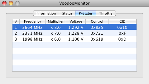

I also have vanilla speedstepping working without disabler.kext/nullcpupowerm.kext. Added _PSS tables with p-states, and cst-tables, which I extracted myself, not the macpro3,1 that are floating around. The temps are also fine now - idle at 32-35c, depending on temperature inside.
Kexts I've got loaded atm include:
fakesmc.kext
IOAHCIBlockStorageInjector.kext (might fix it via DSDT soon though)
OpenHaltRestart.kext
PlatformUUID.kext
VoodooMonitor.kext
Now, sleep didn't work last I tried, should, but didn't so I'm still working on that I guess.

2. I can't find more speedsteps for my CPU (Q8400 2.66Ghz) than the three CPUi/VoodooMonitor gives me, reason tells me there should be more? Could someone please help me find them! :(

I'll share my DSDT for my GA-EP45-UD3P not a UD3R but close enough. This DSDT a compilation from a few threads. SpeedStepping (with P&C states), Bonjour (without ifconfig patch, and in 32-bit only), etc work but it's all still a work in progress. I'm unable to find C-states for my processor/board so I'm using MacPro3,1 C-states. I've tried to keep the DSDT well commented as well.
I've removed sleepenabler.kext, NullCPUPowerManagement.kext and trying to get to a point where I can effectively remove OpenHaltRestart.kext.
Be sure to add dropSSDT=y to your com.appleBoot.plist.
Currently I'm trying to consolidate and streamline the SpeedStepping sections and fix an audio issue that's been bugging me. I've removed a lot of unused devices as well.
This is still a work in progress but it works well. See my signature for my specific hardware setup. I posted this in a hurry so I'll try and clean it up at another time. Just wanted to get it out there because I've seen some people asking for speed stepping.
Thanks to FormerlyKnownAs and Master Chief for their contributions and vast knowledge.
