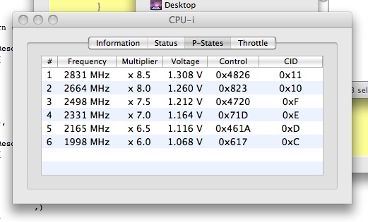

keeza Posted September 16, 2009 Share Posted September 16, 2009 Winston, would you be kind enough to have a quick look at my SSDT, I've compiled my tables from Everest and used Eliades DSDT as a template to see if I'm on the right track. All is good except I have only two P-states under SPSS & NPSS, I don't think its quite right. I havent ried compiling it yet. My processor is a Q9550 (quad core 2.83Ghz) - mobo UD3P. I appreciate your help. I've attached my SSDT part of my DDST and pics from CPU-i If you could give an old bloke a hand it would be much appreciated. (not really that old but feel like it when it comes to this stuff) MY_SSDT.zip Link to comment Share on other sites More sharing options...

Squirrelf Posted September 17, 2009 Share Posted September 17, 2009 Winston, would you be kind enough to have a quick look at my SSDT, I've compiled my tables from Everest and used Eliades DSDT as a template to see if I'm on the right track. All is good except I have only two P-states under SPSS & NPSS, I don't think its quite right. I havent ried compiling it yet. ... I too had two pstate a x6 and a x9, 7 and 8 where missing, I added the other two manually, just don't forget to change the 2 into a 4 in the "header" those four states, to tell the machine that there are now four states, check my dsdt you'll see the difference Link to comment Share on other sites More sharing options...

keeza Posted September 17, 2009 Share Posted September 17, 2009 I too had two pstate a x6 and a x9, 7 and 8 where missing, I added the other two manually, just don't forget to change the 2 into a 4 in the "header" those four states, to tell the machine that there are now four states, check my dsdt you'll see the difference Thanks, I think I'm getting my head around this. If you check the pics I've attached, CPU-i shows 6 P-states or steps that are possible. I understand these to be different voltage and speed levels that are applied depending on the demand on the processors to reduce power consumption and heat. I can then input these values from CPU-i into P-State calculator and that will calculate the PSS entry for my DSDT. I've attached a pic from CPU-i and P-State calculator. CPU-i example: If you take the values from step one (under P-States tab) and enter them into P-State calculator and convert them to hex you will get the required values to enter into NPSS and SPSS. As I have six pStates then my package should be (0x06) as I have 6 steps. So if I repeat step one for steps 2-6 that will give me the required package values. P-State Calculator: Where you see the ???? where would I find that info? Is the Core Clock value under P-Stae parameters the same as the Core Clock Value under CPU Characteristic or is it the FSB value? Core Voltage values - how do I get them? Am I on the right track here, am I understanding this right? ......this is becoming an obsession....... MY_SSDT.zip Link to comment Share on other sites More sharing options...

keeza Posted September 17, 2009 Share Posted September 17, 2009 Didn't you get cstates when you dumped your acpi tables?(Through linux or everest) What is the purpose of LegacyAppleLPC.kext? Thanks I got C-states through Everest. Could I get your feedback on my post #1087? I think its PStates that I need to generate but not sure how to do it. FID's VID's etc Link to comment Share on other sites More sharing options...
WinstonAce Posted September 17, 2009 Share Posted September 17, 2009 The cst tables and CpuPm go "as is" to the dsdt file the ist need to be modified with spss/npss according to the one's supported by your cpu Name (SPSS, Package (0x04) //change the number according to number of p-states in cpu-i { Package (0x06) //first p-state { 0x0E10, //speed of cpu (3600mhz in hex) 0x000157C0, 0xA0, 0x0A, 0x0922, //vid and fid (taken straight from cpu-i under control in p-states tab) 0x0922 //vid and fid (taken straight from cpu-i under control in p-states tab) }, Package (0x06) //second p-state { 0x0C80, //speed of cpu (3200mhz in hex) 0x000157C0, 0xA0, 0x0A, 0x0820, //vid and fid (taken straight from cpu-i under control in p-states tab) 0x0820 //vid and fid (taken straight from cpu-i under control in p-states tab) }, You should continue with all p-state as above Package (0x06) { 0x0AF0, 0x000157C0, 0xA0, 0x0A, 0x071C, 0x071C }, Package (0x06) { 0x0960, 0xDAC0, 0xA0, 0x0A, 0x0618, 0x0618 } Link to comment Share on other sites More sharing options...
keeza Posted September 17, 2009 Share Posted September 17, 2009 Gonna pop out for a couple of hours and relook at it when I get back. Thanks for your help. I guess what I need to do is create more packages as I only have two at the moment. I have 6 p-states and would like to have 6 packages if possible. Am I getting the gist of this? Link to comment Share on other sites More sharing options...
WinstonAce Posted September 17, 2009 Share Posted September 17, 2009 Yes, I also had only two p-states when i extracted the ssdt's needed to add two more Link to comment Share on other sites More sharing options...
keeza Posted September 17, 2009 Share Posted September 17, 2009 So if I've got it right below are my 6 Pstates based on the output from CPU-i under the P-States tab. The lines in bold are lines where I have no idea how to create and just copied them from your previous post. The same values get copied to NPSS?? Name (SPSS, Package (0x06) { Package (0x06) // First PSate { 0x00000B0F // 2831Mhz in hex 0x000157C0, 0x000000A0, 0x0000000A, 0x00004826 0x00004826 }, Package (0x06) // Second PSate { 0x00000A68 // 2664 Mhz in hex 0x000157C0, 0x000000A0, 0x0000000A, 0x00000823, 0x00000823, }, Package (0x06) // Third PSate { 0x000009C2 // 2498 Mhz in hex 0x000157C0, 0x000000A0, 0x0000000A, 0x00004720, 0x00004720, }, Package (0x06) // Fourth PSate { 0x0000091B // 2331 Mhz in hex 0x000157C0, 0x000000A0, 0x0000000A, 0x0000071D, 0x0000071D, }, Package (0x06) // Fifth PSate { 0x00000875 // 2165 Mhz in hex 0x000157C0, 0x000000A0, 0x0000000A, 0x0000461A, 0x0000461A, }, Package (0x06) // Sixth PSate { 0x000007CE // 1998 Mhz in hex 0x000157C0, 0x000000A0, 0x0000000A, 0x00000617, 0x00000617, } Would you be so kind to double check that I've got it right here? Link to comment Share on other sites More sharing options...
keeza Posted September 17, 2009 Share Posted September 17, 2009 Re my above post: An excerpt from Eliades MacPro SSDT, trying to figure out the relevance of the second line (shown underlined) Name (SPSS, Package (0x04) { Package (0x06) { 0x00000C84, 0x000157C0, // Converted to Hex = 88000 0x000000A0, 0x0000000A, 0x00000927, 0x00000927 }, Package (0x06) { 0x00000B20, 0x00000000, 0x000000A0, 0x0000000A, 0x00000826, 0x00000826 }, Package (0x06) { 0x000009BC, 0x00000000, 0x000000A0, 0x0000000A, 0x00000722, 0x00000722 }, Package (0x06) { 0x00000858, 0x0000DAC0, //Converted to Hex= 56000 0x000000A0, 0x0000000A, 0x0000061E, 0x0000061E Any idea from where this is generated from? Link to comment Share on other sites More sharing options...
WinstonAce Posted September 17, 2009 Share Posted September 17, 2009 I don't know where to get these values, Something related to power consumption but as I understood, they have no meaning for speedstep nevertheless, if you'll use the p-state calculator it will calculate it for you. Link to comment Share on other sites More sharing options...
