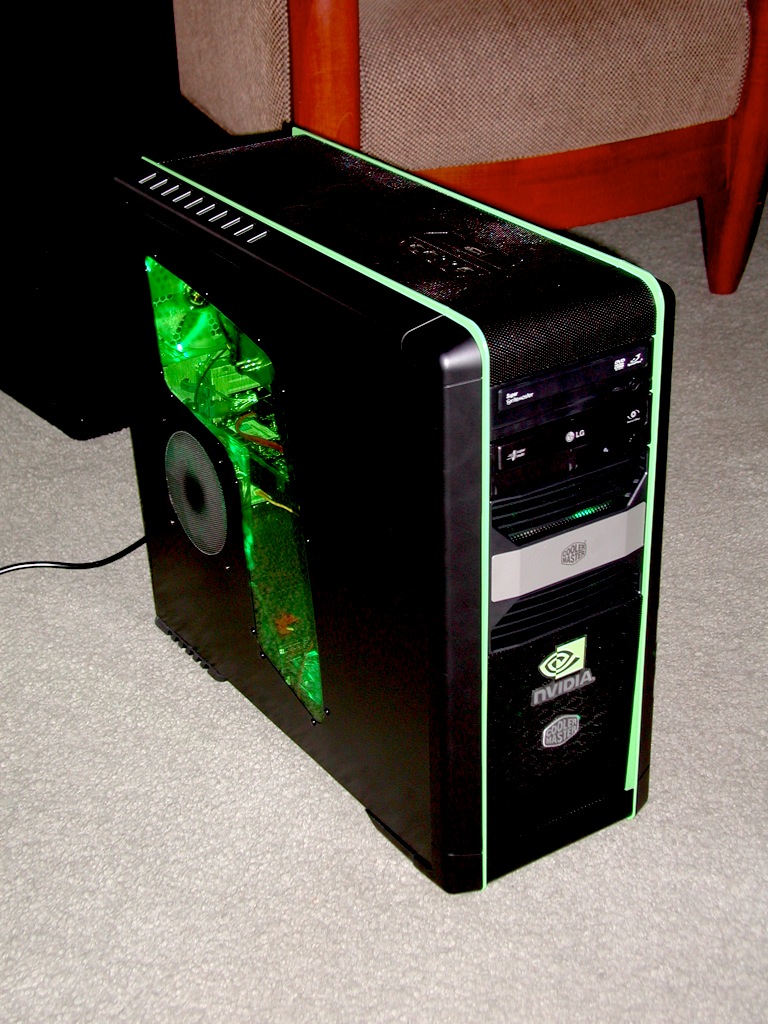

JFLNYC Posted September 3, 2009 Share Posted September 3, 2009 I'll post my EX58-UD3R specs here, inc ase anyone else is interested. Fair warning: I haven't yet got a satisfactory SL install. Basic install, no problem. Getting sound outputs and ethernet working correctly in both 32-bit and 64-bit, PROBLEM! About to do another clean install now. Having said that, works great with 10.5.8. OSX Mac Box Set Processor Intel Core i7 920 Nehalem 2.66GHz LGA 1366 Quad-Core Processor CPU Cooler Cooler Master V8 Motherboard GIGABYTE GA-EX58-UD3R LGA 1366 Memory G.SKILL 6GB (3 x 2GB) 240-Pin DDR3 SDRAM DDR3 1333 (PC3 10666) Hard Drive Western Digital Caviar Black WD1001FALS 1TB 7200 RPM 32MB Cache SATA 3.0Gb/s Graphics Card NVIDIA GeForce GTS 250 512MB Audio/Ethernet Onboard Optical Drive LITE-ON Black 22X DVD+R 8X DVD+RW 8X DVD+R DL 22X DVD-R 6X DVD-RW 16X DVD-ROM 48X CD-R 32X CD-RW 48X CD-ROM SATA 22X DVD Burner Case Cooler Master CM 690 NVIDIA Edition - mid tower - ATX PSU OCZ ModXStream Pro OCZ600MXSP 600W ATX12V V2.2 / EPS12V SLI Certified CrossFire Certified Modular Active PFC Power Supply compatible with core i7 Link to comment Share on other sites More sharing options...

Squirrelf Posted September 4, 2009 Share Posted September 4, 2009 JFLNYC I have the same case, but in regular black version I have 14 fans running (including PSU, Video Card and CPU)... LOL Eliade, any updates on KPs in various apps using x64? I'm in x86 atm and it's smooth as usual but last night while using x64 I had random KPs caused by various different apps... so far so good, but I haven't actually worked on it yet later tonight I will (photoshop, dreamweaver and indesign) only thing I'd like to have is IDE from EFI partition only, any ideas ? Link to comment Share on other sites More sharing options...

JFLNYC Posted September 4, 2009 Share Posted September 4, 2009 JFLNYC I have the same case, but in regular black version I have 14 fans running (including PSU, Video Card and CPU)... LOL Now I like you even more! The CM 690 case is a fantastic case and a great value. I thought 9 fans was enough, though, but I guess not! BTW, another Mac Clone I have is in an Antec Skeleton. Link to comment Share on other sites More sharing options...
