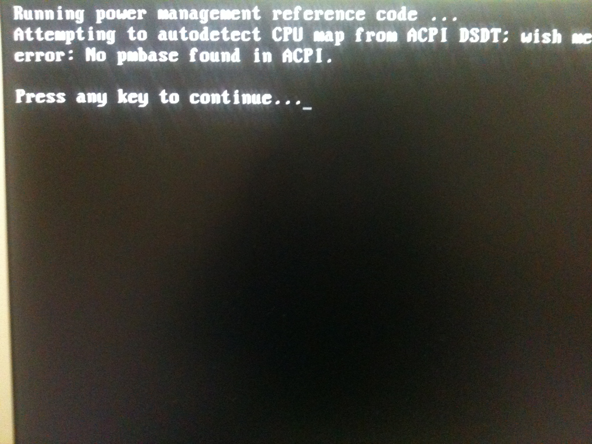

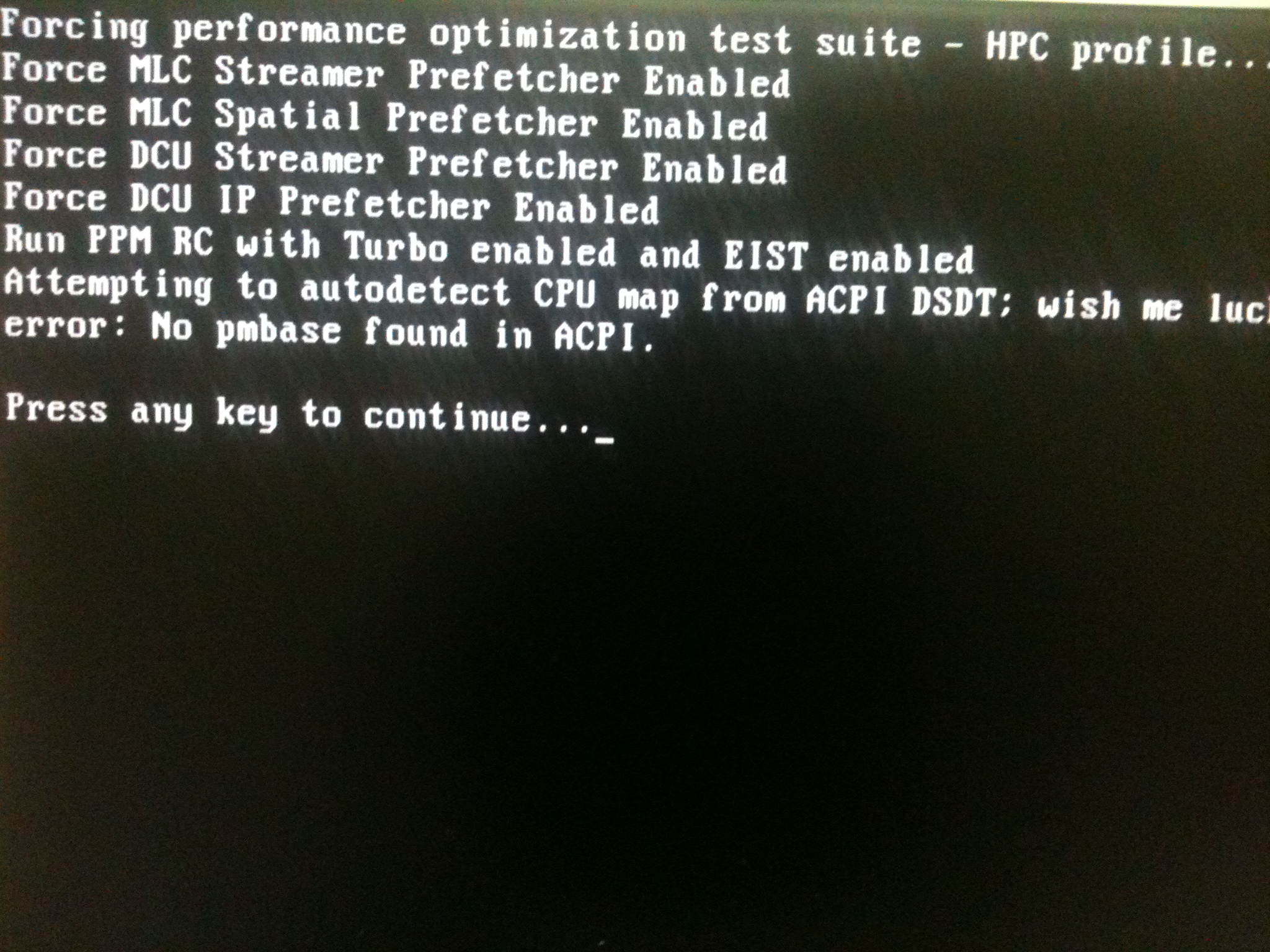

Does it make permanent changes to Bios (P-States etc.)? If so, can I assume that I will not need to edit my DSDT file as I am using AnVaL to generate P and C states based on my SSDT tables? Or does it just show me the corrections and allow me to dump those newly generated tables for later use?

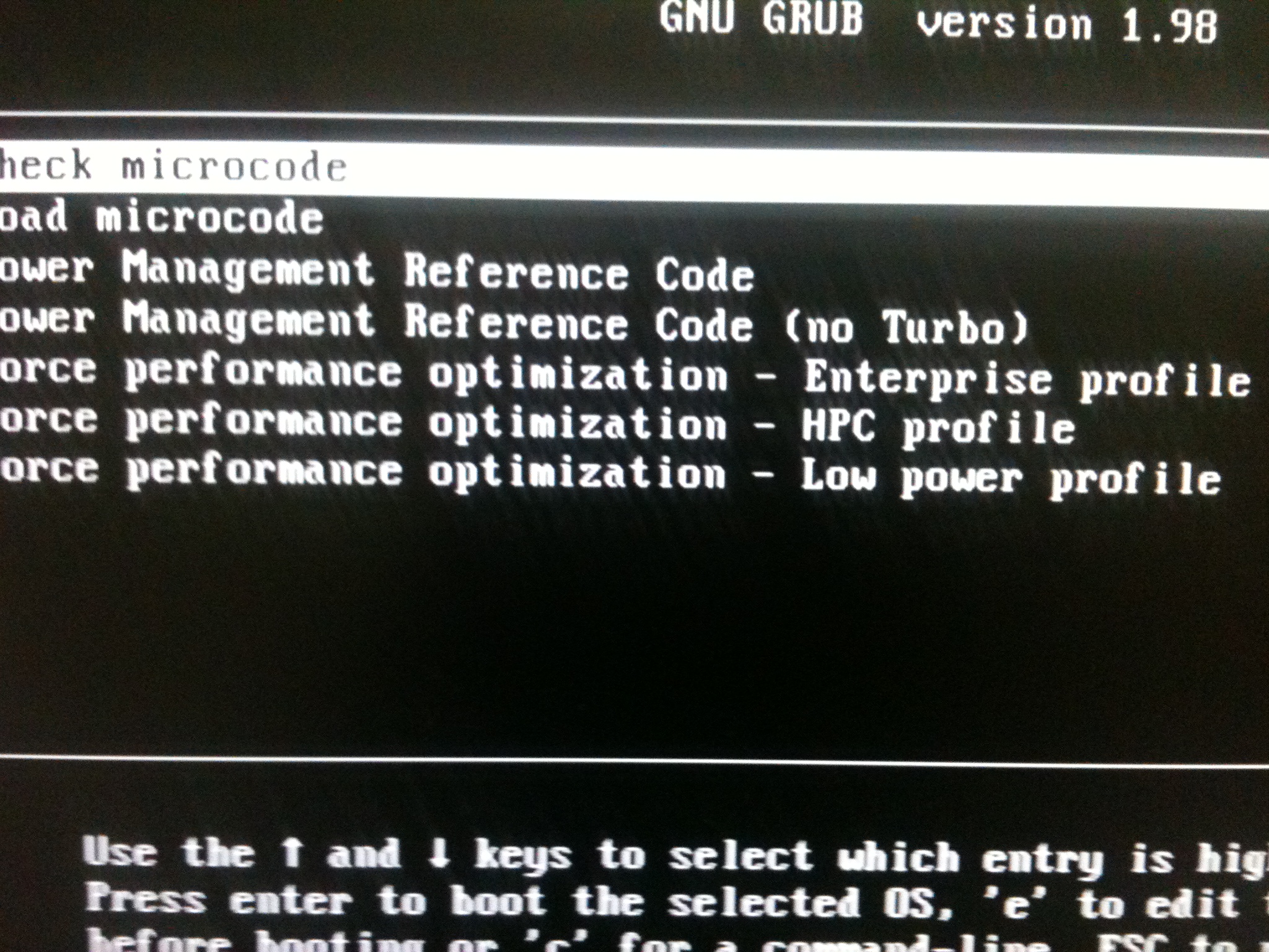

It doesn't change the existing BIOS. BITS test the BIOS initialization of Intel processors, hardware, and technologies against Intel recommendations. BITS also includes Intel's official reference code, which you can use to override your BIOS's hardware initialization with a known-good configuration, and then boot an OS. Just read all about it @ http://biosbits.org/
If you don't want to use BITS as intermediate boot loader, you can dump the fixed SSDT table & integrate it in the DSDT. This way you won't need to use boot loader to generate P & C states for you.
Say, I run the test and it made corrections for my SSDT tables. But later, in order to dump all those fixed SSDT tables I need to boot into Linux right? Since I don't have Windows installed, that seems the only choice. But the problem is, looking at the screen shots at that website, there are only two options; Boot first drive MBR and boot second drive MBR.
Does this mean that after making the corrections I can't use a Linux live Cd to boot into Linux? In my case, what would be the best option, if any, to dump the fixed SSDT tables? Do I need a separate hard drive on which Windows or Linux installed to dump all those SSDT tables?
I only tested it with windows but it should work with linux too. After you have choose which configuration you want in "Configure Menu", boot to linux by choosing "Boot first drive MBR" or "boot second drive MBR", depend on where linux is installed. Then dump SSDT table in linux.
I see. I think I'll try to find external hard drive to install Windows. But at this point, theoretically speaking, once I've run the test and chosen to boot into my first HDD on which Snow Leopard is installed, Chemeleon should be able to generate P and C States according to the fixed SSDT tables. Am I right?
Also in your case, did you see any improvement in your temp values or the way that CPU is being utilised by OS.
Yeah, theoretically speaking, it should work with Snow Leopard too. After you have chosen your desired configuration & boot into first HDD on which Snow Leopard is installed, your Snow Leopard will get new SSDT with fixed P-States. You don't need to tell Chameleon to generate P & C states anymore because that would be redundant. I'm unable to test this on my notebooks because P & C states are properly detected without telling Chameleon to generate P & C states for me.
I only tested this with windows but I didn't see or feel any improvements. When running the test, everything is OK on my notebook. The only error it found is one C state failed "demotion" routine. I don't know what that's for though (didn't bother to google it ;) ). The BITS ability to generate correct SSDT with fixed P States will definitely help who ever have problem with P States on their computer with OS X.

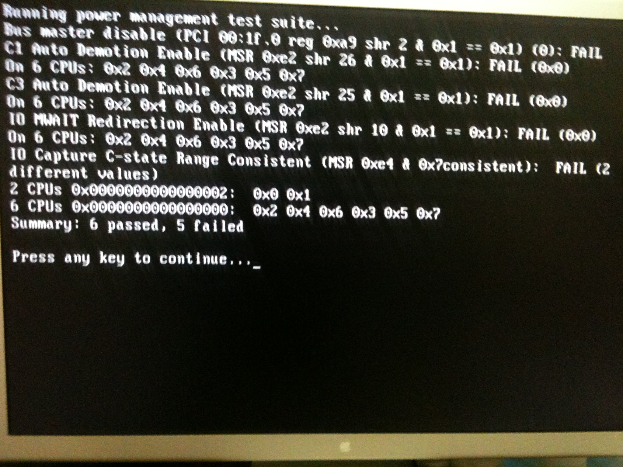

I ran a bits test, and i got quite a lot failures.
smrr test 6 passed 0 failed
pstate ratios 10 passed 0 failed
smi latency 0 passed 1 failed
msr consistency 8166 passed 2 failed(2 different values)
cstate residency 2 passed 2 failed (error need 2 arguments:msr_number value
powermanagement test suit 6 passed 5 failed
is this possible to fix with modifying dsdt?
thanks
