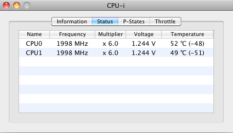

yonika Posted September 14, 2009 Share Posted September 14, 2009 You can easily verify all this with help of CPU-i (P-States) which works for me here. No, and like I said; it should drop power. That's a pretty clear indicator. I can't answer all your questions here, since they are unrelated to the matter at hand. But about that bug; Why don't you e-mail Matthieu Beaumel – the author of this widget – and tell him about the bug Well, Just to make sure i'm not hallucinating, I attached 2 screen shots of my CPU-i application, I can't see any power indicator, and there is no help for cpu-i, maybe i'm using the wrong app ? 10x, Jonathan Link to comment Share on other sites More sharing options...

xopher Posted September 15, 2009 Share Posted September 15, 2009 There's just one thing I haven't figured out yet, Master Chief said something about seeing the power value in CPU-i drop to 0.5 and go up to 1.0 if I have c-states working, I just could not find anywhere on CPU-i this information. Where the heck to I see this info ??? http://www.insanelymac.com/forum/index.php...st&id=56616 The voltage value is what MasterChief is referring to. It should drop to the value designated in your _PSS when Speedstep changes multiplier when eg. idle. If it falls to 0.5 you should have C-states working, because it reduces the power consumption even further. Link to comment Share on other sites More sharing options...

yonika Posted September 15, 2009 Share Posted September 15, 2009 http://www.insanelymac.com/forum/index.php...st&id=56616 The voltage value is what MasterChief is referring to. It should drop to the value designated in your _PSS when Speedstep changes multiplier when eg. idle. If it falls to 0.5 you should have C-states working, because it reduces the power consumption even further. 10x, Well, power and voltage are two really different things, that's why I did not understand that. do you know how much time I have to wait for it to drop ? I guess it just happens when the cpu is really really idle because it takes more time to change c-states. Jonathan Link to comment Share on other sites More sharing options...

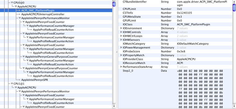

Dr. Hurt Posted September 15, 2009 Share Posted September 15, 2009 I have just found out that speed step is working fine without me doing anything - No errors, no nothing. I'm using a fully vanilla 32-bit 10.6.1 system (specs below). DSDT.aml and some kexts in the /Extra folder (in the pics below). I have neither dumped nor merged SSDTs. This only happens when I have nullCPUPM in /Extra folder. If I remove NullCPUPM, I get no speed step and higher CPU temps. Is this normal? 1.tiff 2.tiff 3.tiff DSDT.aml.zip Link to comment Share on other sites More sharing options...
