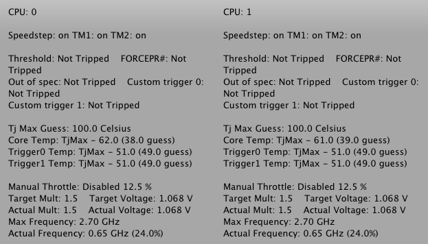

Hi there mm67, can i ask a question?
My previous Gigabyte board died and got a asus p5q-em
This board with a e8500 gives vanilla speedstep, but i'm not sure if all is OK (temps at idle 53c)
Is there anything i can change to get the temps down (on windows it idles at 34c)

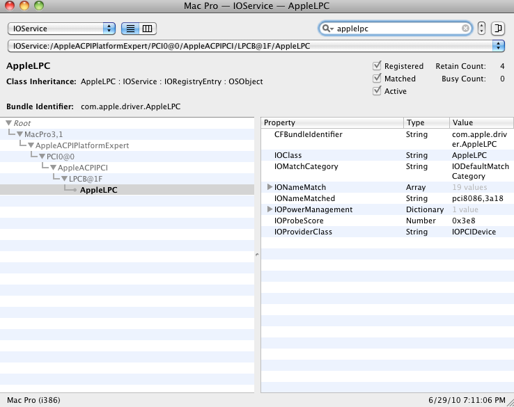

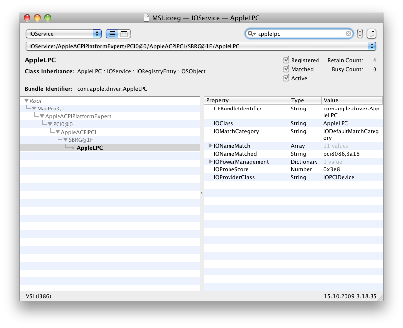

Check to see if AppleLPC.kext is loading. I have vanilla speedstep with my MSI board but gain between 5 and 10 deg whithout AppleLPC even though stepping is working.
See 1st post for getting AppleLPC working with DSDT patch.

I never even remember that ICH10R needs a fix for AppLPC, that seems to be missing since AppleLPC is not loaded on that IOregistry dump.
I have to set my ID to 3A18 (ICH10). I'm sure once Apple updates the MacPros they'll add support for ICH10R as long as they keep using Intel processors.

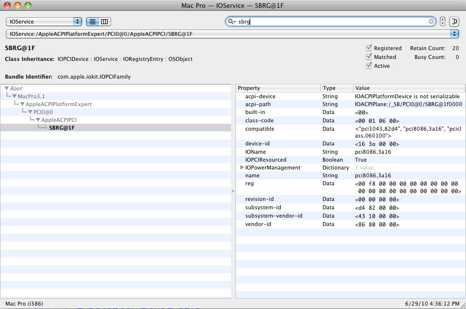

i remember it's on 3A16
T
edit > SBRG see pic
it's it called different, i can remember the other name for asus board
Found it a few day's ago on project osx site. i know that it is running
T
It's SBRG in your dsdt
