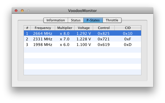

decided to copy paste my PSS from gigabyte and its working (well i can see voodoomonitor change frequency), what still concerns me is if the values are correct :(
and looking at your CST it's totally different.

im sure its working because if i taken out the PSS code and remove NULLCPUPM kext temp is on the 50+.. also its hot from where im from and im also using a stock cooler :D
still my concern is am i safe using this code (right now im using it)? do i need to change/remove anything or just use Speedstep via kext :D

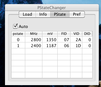

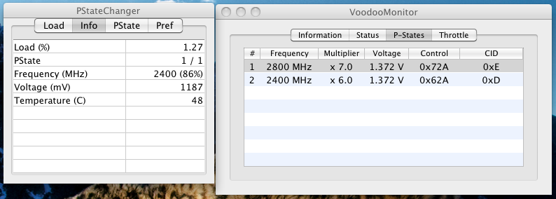

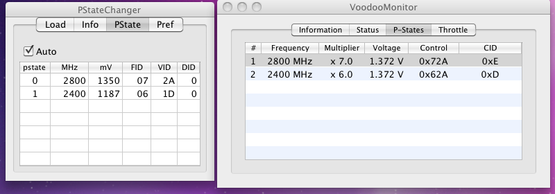

VoodooMonitor should show your different voltages like PState Changer.
Have you removed the PState Changer kext?
Tried with DropSSDT=Yes in plist?

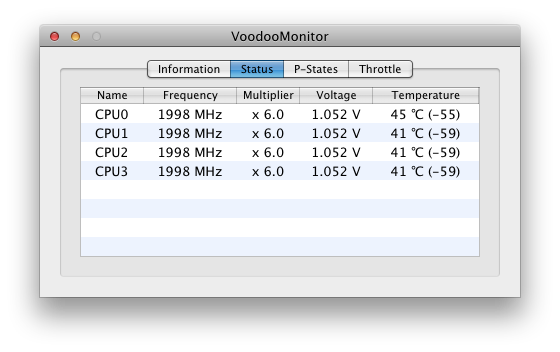

"Why go to the trouble of speedstep when tmp's are still gonna be 50+ idle...Whyyy???"
By reading most of this thread, you all seem to have fixed that by putting in "C states" the right way and double checking other things.
Apparently Voodoomonitor shows the same voltages for both pstates, I dunno why...I took out pstatechanger's-->voodoopstate kext and added dropssdt-->yes, still no go, it still shows the same voltage like the screenshot in my earlier post, but when I check speedstep via terminal, I get:
bash-3.2# ioreg -lw0 |grep CSTInfo	| |   |	 "CSTInfo" = 19136773
bash-3.2# ioreg -lw0 |grep PerformanceStateArray	| |   |	 "PerformanceStateArray" = (<00000000000000000a0000000a0000002a07000000000000>,<00000000000000000a0000000a0000002a06000001000000>)
...which I think means that speedstep is kinda working?

Im attaching my current dsdt with new speedstep code which fixed the stutter:
newssDSDT.dsl.zip
If you've added cst and PSS data to your DSDT why would you want to also load voodoopowermini ??
If you do want to load it try in S/L/E not E/E.
I would also say the same for voodoomonitor - put it in S/L/E
EDIT : You have the same VID (voltage ID) for both the pstates you have defined.
Method (_PSS, 0, NotSerialized)
           Return (Package (0x02)
               Package (0x06)
                   Zero,
                   Zero,
                   0x0A,
                   0x0A,
                   0x07[b][color="#ff0000"]2A[/color][/b],
                    Zero
               Package (0x06)
                   Zero,
                   Zero,
                   0x0A,
                   0x0A,
                  0x06[b][color="#ff0000"]2A[/color][/b],
                       One
Thats one down, good to hear the stuttering is fixed.
As FKA said try this code for the second P-State:
				Package (0x06)
				Zero,
				Zero,
				0x0A,
				0x0A,
					0x061D,
					One
Voodoo monitor works fine for me in E/E.
Remove VoodooPower, change the voltage ID as above and see how that goes.
As FKA said its either VoodooPower and remove P-State and C-State from DSDT or
C-State and P-State in DSDT and no VoodooPower.
To lower the temps, the whole point of me going after speedstep is to bring the temps under control, but I didnt know about the Pstates and Cstate thing being the same as v-mini, thanks for pointing that out.
Glad you cleared that keeza. However, the temps are still the same after giving the second p state different voltage. Even after taking out the P states and C states , voodoomini loads up but no temp difference, actually its +3-5 degrees with voodoomini.
The pstates calculator and vmonitor kexts have me confused, its quite obvious second p state is being loaded up with 1.187 voltage, but voodoomonitor shows the same for both.
Anything else we can try to get the temps down? :wacko:
PS: I tried the Macpro 3.1, 4.1, 5.1 switch in smbios, boots and runs fine in all of them with no temp difference, just thought Id mention this aswell.
You are still showing VID of 2A for both states.
Have you cleared caches once voodoomini was removed?
EDIT - also (sorry if you've already covered this) .. but do you have LPC device in IOReg??
