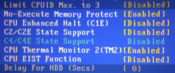

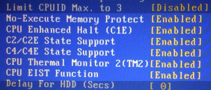

sk1nhead Posted December 18, 2009 Share Posted December 18, 2009 The stepping shown in VoodooMonitor seems to be more active now? (maybe not?) I have also tried disabling C1E in BIOS with no adverse affects. I then went on to disable C2/C2E and C4/C4E State Support in BIOS also. Here's pictures of my before and after BIOS settings. However, I am thinking I need C2 & C4 enabled to allow deep sleep of the CPU and to save energy when sleeping. Please can someone confirm? I left the CPU Thermal Monitor 2 enabled as I guess thats sensible. same here, tried disabling C1E and and EIST but the voltage and multiplier is jumpy.. also is this normal below? core 0 and 1 is different from 2 and 3 - took me about 10 tries to capture it but good thing i got it? SCARY! i'm reverting back before i break something.. here are the choices in my bios that i changed CPU Enhanced Halt (C1E): [disable] CPU EIST Function: [disable] Link to comment Share on other sites More sharing options...

sw170 Posted December 18, 2009 Share Posted December 18, 2009 With EIST off my CPU temperatures are about 5-6C higher (mprime) ±40C - EIST on ±46C - EIST off Link to comment Share on other sites More sharing options...

sw170 Posted December 19, 2009 Share Posted December 19, 2009 This must be an indicator that your DSDT isn't fully patched i.e. that you still have some work to do. my mistake, temps are actually the same with or without EIST. Turned off all C1,2,4 states in bios and still the same results added DropSSDT=Y - no change So now Chief: Do I need DropSSDT=Y or not ? (sorry if I missed something, and asking silly questions..) ah, and no sign of any SSDT in IORegistryExplorer with or without DropSSDT=Y Thanks a million Regards s Link to comment Share on other sites More sharing options...

Master Chief Posted December 19, 2009 Share Posted December 19, 2009 ... So now Chief: Do I need DropSSDT=Y or not ? (sorry if I missed something, and asking silly questions..) ah, and no sign of any SSDT in IORegistryExplorer with or without DropSSDT=Y.. No. You don't need this option when you disable EIST in the BIOS. Which acts as a master switch. Would be very helpful if some dsdt hero explain in an short summaryin which practical cases = by which problem DropSSDT=Y is needed (please NOT only tell "if xyz shown / not shown in IOregistry"!). Is it only needed if users also copied+modded SSDT parts into dsdt ? (i believe i have that not). You may need DropSSDT=Yes when you run into problems with the factory SSDT's. And people with EIST enabled in the BIOS might want to use it too, simply because it is cleaner. It is however not required. Link to comment Share on other sites More sharing options...
