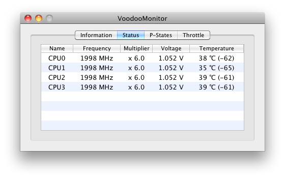

mcsmart Posted November 7, 2009 Share Posted November 7, 2009 @ mcsmart: CPU-X just shows the factory speed of the CPU. You need to use VoodooMonitor or MSRTools if you want to see if it's switching states. LOL, ok. This is definitely good to know. According to MSRTools SpeedStep is working... I guess EIST was working all of the time Thanks a lot for your help people! The only thing that does not make sense to me is that cpu-x showed my CPU speed correctly when using VodooPower.kext (also displayed how the multiplier changed). Now with vanilla speedstep cpu-x always shows 3GHz, the sysctrl values also show 3 GHz (for min and max). Can somebody explain that? Regards, mcsmart Link to comment Share on other sites More sharing options...
Beerkex'd Posted November 7, 2009 Share Posted November 7, 2009 That's news to me, I've never seen any activity in CPU-x. Maybe it only works with VoodooPower and not with AppleIntelCPUPM. Do your multipliers look 'normal' in MSRTools? I see 36.5 when it's supposed to say 6.5. sysctrl also shows my CPUs stock freq on both max- and min. here. Link to comment Share on other sites More sharing options...
mitch_de Posted November 8, 2009 Share Posted November 8, 2009 The only thing that does not make sense to me is that cpu-x showed my CPU speed correctly when using VodooPower.kext (also displayed how the multiplier changed). Now with vanilla speedstep cpu-x always shows 3GHz, the sysctrl values also show 3 GHz (for min and max). Can somebody explain that?Regards, mcsmart Yep. let my try: cpu-x doesnt read out cpu-near (cpu registers, MSR) it read an kernel variable (sysctl -a shows all) to get the MHz. Voodoopower based (most of them) kernel extensions do update that kernel variable on his PSstate changes!. So cpu-x can show real Mhz , if that voodoobased .kext had update that extra kernel variable. But not all voodoobased .kexts does set that kernel variable, so CPU-X is unsure. But i use it if i checked up/down MHz with MSR Tool. MSR Tool do read out MSR register(=cpu near) and use that kernel variable = allways (normally) real MHz. Link to comment Share on other sites More sharing options...
mcsmart Posted November 8, 2009 Share Posted November 8, 2009 Do your multipliers look 'normal' in MSRTools? I see 36.5 when it's supposed to say 6.5. Not, they are weird. They are between 3.0 and 4.5 @mitch_de: Thanks for explaining. There is still one more problem I have: After a while my system becomes sort of unresponsive. It is noticable when moving around windows (Finder, Terminal, Safari, ...) - everything is some kind of stuttering a little. Music and Videos still play fluently so it's pretty hard to describe. Has anybody else noticed this? Without speedstep this does not happen. The actual CPU load stays low, so the CPU frequency does not scale up when moving around windows. Regards, mcsmart Link to comment Share on other sites More sharing options...

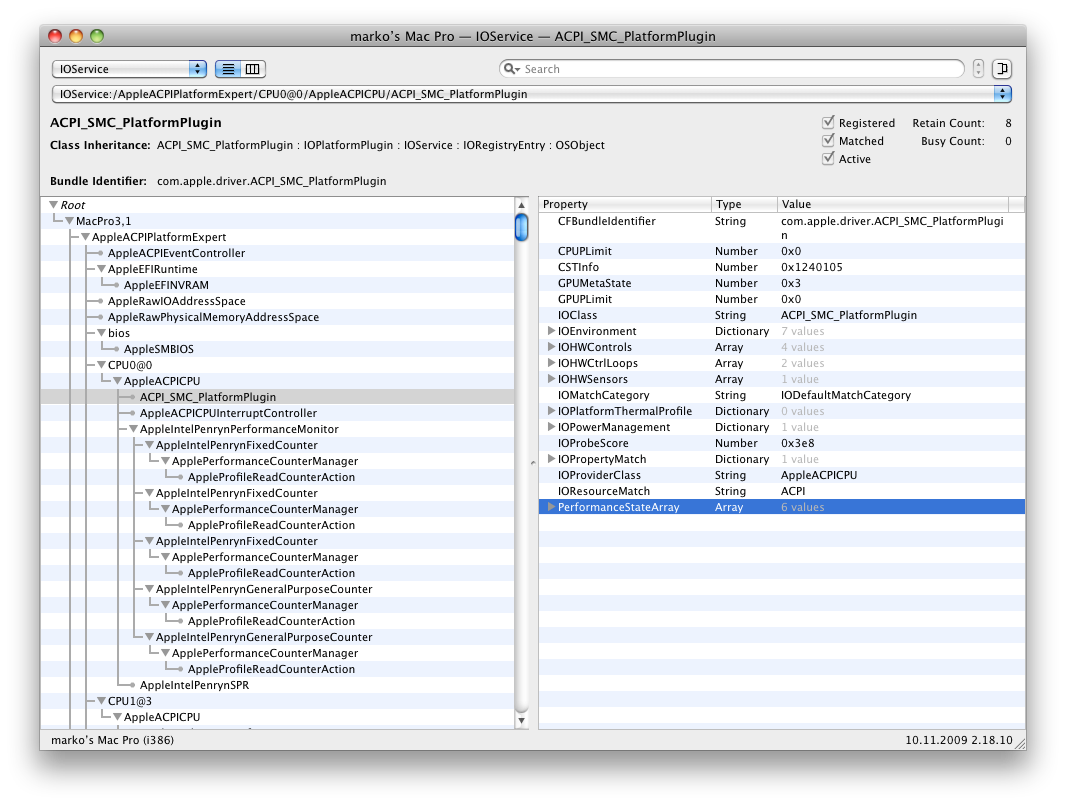

Master Chief Posted November 10, 2009 Share Posted November 10, 2009 Looks like something has changed with 10.6.2.... I was just about to post about this. But there's something urging to be addressed immediately first (I have only one CPU left in CPU-i)!!!! 1) IOPlatformThermalProfile is gone (empty). 2) Each model has it's own plist now under: /S*/L*/E*/IOPlatformPluginFamily.kext/Contents/PlugIns/ACPI_SMC_PlatformPlugin.kext/Contents/Resources/ 3) This is much easier to read, but requires some changes. 4) I copied MacPro3_1.plist to P5K PRO (my model identifier) and changed MacPro3,1 to P5K PRO and will do now a restart (report back later). Update: CPU-i still reports CPU Count: 1 whereas it first said 4 But MSR Tools still shows two cores, and _p_States appears to be working. Still no stepper data visible in IORegistryExplorer (but we might no longer need it there). So is this limited to the old CPU-i or are other people using its replacement VoodooMonitor also seeing this? Link to comment Share on other sites More sharing options...
mm67 Posted November 10, 2009 Share Posted November 10, 2009 I was just about to post about this. But there's something urging to be addressed immediately first (I have only one CPU left in CPU-i)!!!! 1) IOPlatformThermalProfile is gone (empty). 2) Each model has it's own plist now under: /S*/L*/E*/IOPlatformPluginFamily.kext/Contents/PlugIns/ACPI_SMC_PlatformPlugin.kext/Contents/Resources/ 3) This is much easier to read, but requires some changes. ACPI_SMC_PlatformPlugin is different now, looks like we have only C-states left. No problem with number of cpus Link to comment Share on other sites More sharing options...
