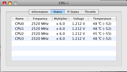

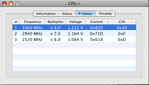

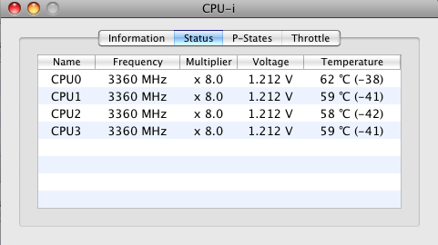

EDIT -- I'm not 100% sure this is working - CPUi shows 3 p-states, it clocks up to 8x running cpu test but doesn't show the CPU clock back down until quit and restarted. this wouldn't bother me too much as CPUi is sometimes slow to react with my PSS data in DSDT - However MSR usually shows correct info when CPUi hasn't yet 'caught up'.
With the above in my DSDT both CPUi and MSR tools show the CPU go from 6x to 8x under stress but both indicate it stays at x8.
Any body else add to this ??

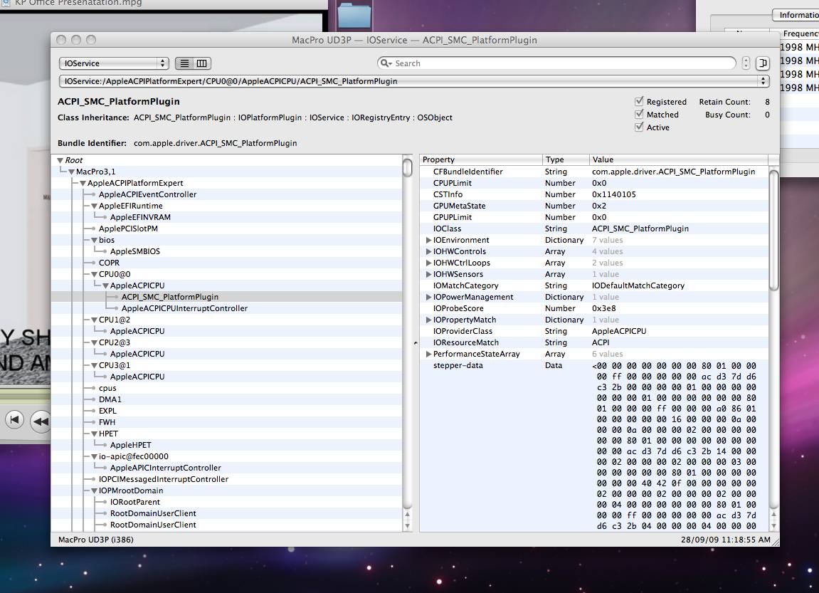

Basically I used parts from a MacPro3,1 dump and combined it with sections from my original dump.
Compiled it and to my surprise, no errors.
Dropped the resulting aml file into root, rebooted.
Voilla!
I was very surprised it worked actually as I was hesitant to use the MacPro dumps because I had all the dumps required and my mindset was that the dumps should come from the machine itself.
Temps seem to be nice and stable. Got up to 45 degrees whilst carbon copying but sitting at 34 degrees idle.

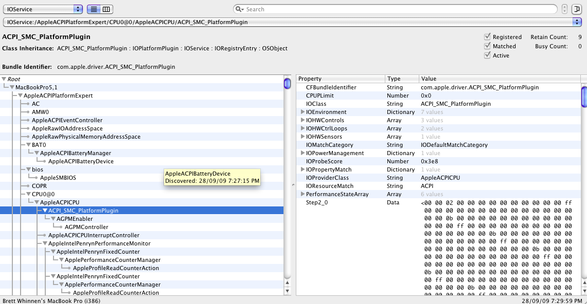

I've currently got pretty much my entire SSDT in there, but am still getting the following error:
ACPI_SMC_PlatformPlugin::registerLPCDriver - WARNING - LPC device initialization failed: C-state power management not initialized
Also no CSTInfo under IORegistryExplorer. However I am getting idle temps of around 37 - 38*C with full speedstepping (both FID and VID change as per the _PSS values).

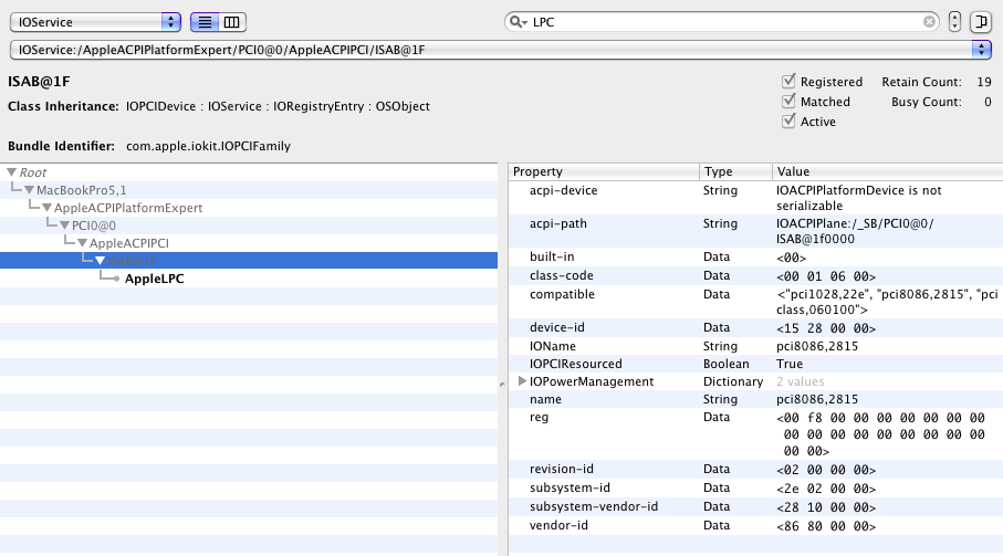

Have you identified your LPC device and made the changes to it according to Beerkexd previous post?
I was the same, everything appeared to work except cstates wouldn't load. I knew that because my idles were around 45 degrees.

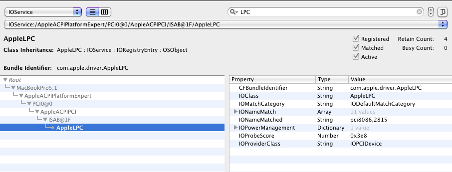

AppleLPC.kext is loading for me, you can see it below, and the deviceID of my vanilla LPC device is one that is obviously used in a MacBook of some desccription.
The PDCx and OSCx I use (similar to my BIOS) are from a MBP5,1 which is what I inject via SMBIOS.plist. The ACPI_SMC Info.plist has been modified and also left vanilla to no difference, I've even changed to a MP3,1 and left it vanilla and also modified to no avail.
I've used my _CST from my SSDT as well as the _CST from a MP3,1. I'm yet to find a SSDT containing the _CST values from a MBP5,1 which I would dearly love to find as it seems to look the closest from a DSDT / SSDT perspective.
Here is my ACPI_SMC_PlatformPlugin from IORegistry;
Plus:
bash-3.2# kextstat | grep LPC
78 0 0xffffff7f812ae000 0x3000 0x3000 com.apple.driver.AppleLPC (1.4.6) <9 5 4 3>

I've noticed that you aren't loading CST0 into HC0 but load the others (e.g. CST1 into HC1) in your DSDT.

I'm done patching. Now I'm running super stable with speed step fully working!!
Here's a simple summary of what I did for those who care:
+Add the _CST from a MacPro3,1 (Removes all errors at startup)
+Add an LPC device with a fake id to match Apple's LPC kext (allows me to remove the legacyLPC)
+Remove IRQs from from TMR and PIC (fixes sound stuttering)
