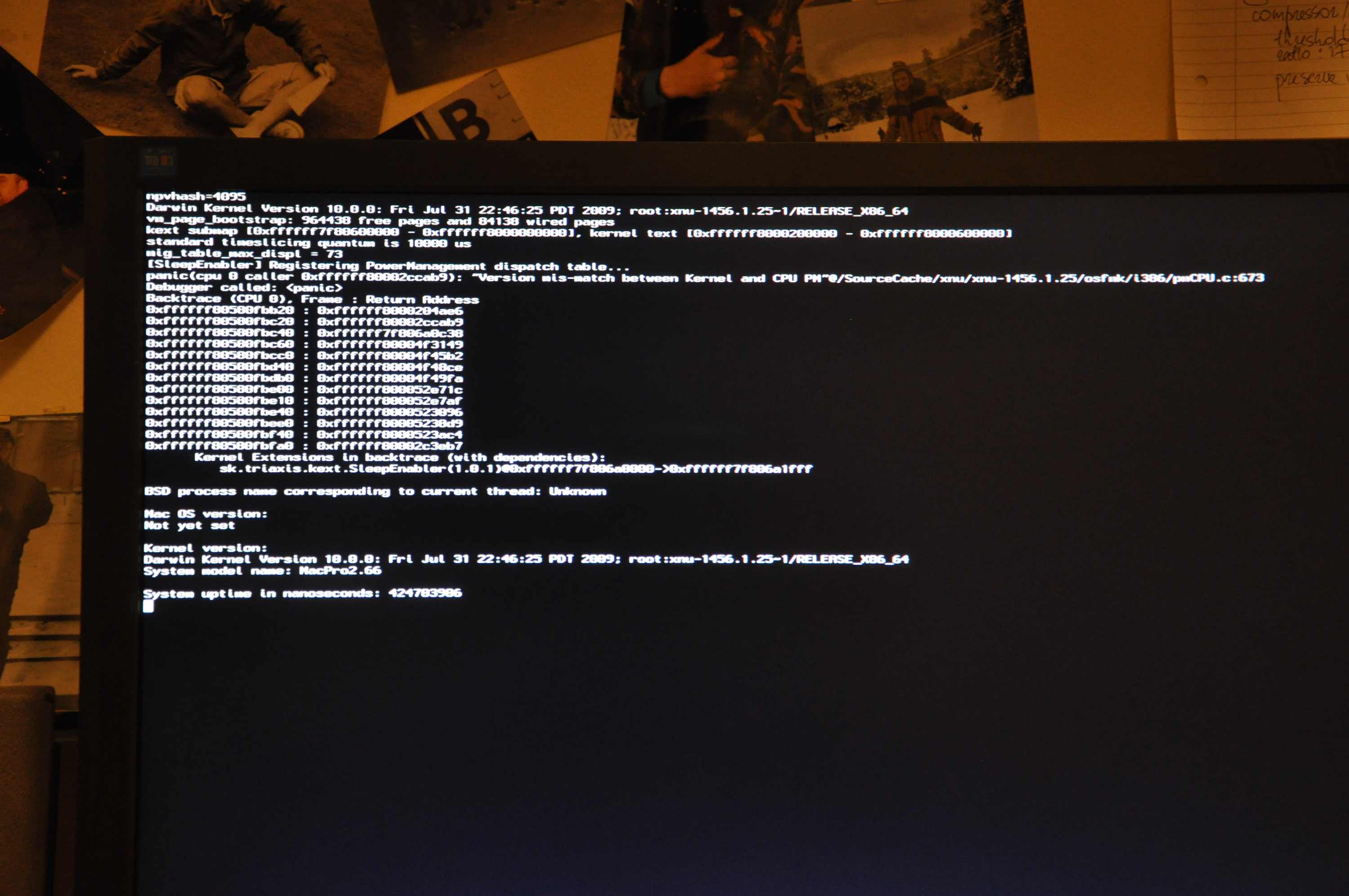

I think i got rid of kernel panics: I deleted the arch key from boot list file, cos the bios is set to beet in 64b, so it's working pretty smooth now. Is this correction good?

The Hack is working and havent had Kernel panics for a day now. What I did:
Deleted key arch from boot list so I think both kernel and cpu are 64bit now. I dont know if that was supposed to be a problem, but I dont have Kernel panics now. I have them in the other place now!!!
I wanted to boot from USB to make a disk image of my instalation and also to install another instaalation on backup disk... everytime i try to boot from USB i get Kernal panic. I tried changing Kernal to 32, 64.... tried booting ignoring cache.. verbose.. no luck... why is it?? here is what it says:
panic ()cpu 0 caller 0x2a76e6):Version mis-match betwwen kernel and cpu pm"@/source cache/xnu/xnu-1456.1.25/osfmk/i386/pmCPU.c:673

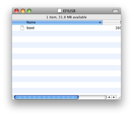

Having Chameleon on a USB stick is very useful in case you trash you own Cham partition, here's a crash course on building a bootable USB stick.
1. Boot up in to your running Snow Leopard install.
2. Insert a USB stick, load up Disk Utility and erase it in Mac OS Extended (journaled) format using a GPT.

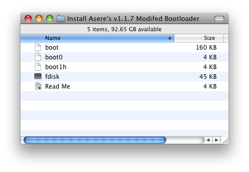

3. Download the latest bootloader available. In this case Asere's modified RC4 bootloader v1.1.7 from the front page of this thread.
4. Follow the step outlined in Section A of 'Part 3 - Install Chameleon' PDF, so that would be to use the diskutil list command in Terminal to identify which disk and partition number you want to work on, cd to the Asere bootloader directory and install the boot0, boot1h and boot files to the USB stick.
You will then have a folder looking like this in the Finder:

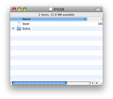

As you have already built your /Extra folder to boot your Snow Leopard system then all you need to do is copy that /Extra folder from the Cham partition on to the USB Stick.
Your folder in the Finder will now look like this:
You can boot with the USB stick inserted in a USB port on your case, press 12 for selecting boot drive option in BIOS, choose hard disk then select the USB stick. Chameleon will then load from the USB stick from where you can boot your existing system on the HDD.
If you want to go one step further and create a bootable installer USB, then the USB stick needs to a minimum capacity of 8GB and after doing the above steps you just need to restore the retail Snow Leopard DVD on to the same stick. See the last two paragraphs starting with 'Next we need to....' on page 2, section 1B in 'Part 2 - Install Snow Leopard' PDF.

Hi Janis_A
Yes, your problem lies with the error message that you previously posted about
panic ()cpu 0 caller 0x2a76e6):Version mis-match......
and also the error
Kernel Extensions in backtrace (with dependencies):
sk.triaxis.kext.SleepEnabler (1.0.1)......
You are using Darwin Kernel Version 10.0.0 (which is used in 10.6 and 10.6.1)
but you are using the version 1.0.1 of SleepEnabler.kext which is for 10.6.2 only.
You need to use the version 1.0.0 of SleepEnabler from my Support Files in the "For 10.6" folder.
Note: I have read there will be another version of SleepEnabler required for 10.6.3 when it's released

I cannot make any sense of your remark, tried also the RC3 boot file, the boot is in this partition:
"Questions that get posted time and time again....
Q. "I get a Kernel Panic directly after selecting to boot Snow Leopard from Chameleon"
A. from page 17 of the guide.....The most common Kernel Panic is the one immediately after boot which is normally caused by the lack of a Snow Leopard boot file. You need either the Chameleon RC3 boot file or Netkas' PC EFI v10 boot file.
This was from when people first started to install Snow Leopard, and the revised bootloaders were only just coming out. I found users were still using pre 10.6 compatible versions. As long as you are using Chameleon RC4 or PC EFI 10.5 then you have nothing to worry about there.

I have just gone through this for some tests I am doing.
When you install Windows7 on to one of your other partitions, I used the WIN7 partition, it will successfully install but also write it's boot code to the MBR of the disk. So when you boot your PC Windows7 will automatically boot and you won't get to see Chameleon.
You can then use fdisk to write boot0 back to the MBR as I described in section A of 'Part 3' for the PDF guide, but Windows will then complain it's damaged and you need to repair the MBR with the Windows repair option from the DVD. You can eventually get Chameleon working by using fdisk to make the Chameleon partition the active partition, then boot windows 7 from it. However, you will encounter a problem with Windows7 not entering sleep as it's fussy about being on the active partition.
The way round this is to use a modified boot0 file which is currently being worked on and might see the light of day in Chameleon v2 RC5? so if you can wait then great, but if you want it now then the simplest option is to install Windows7 on to it's own HDD and Chameleon will find it and boot it just fine.
