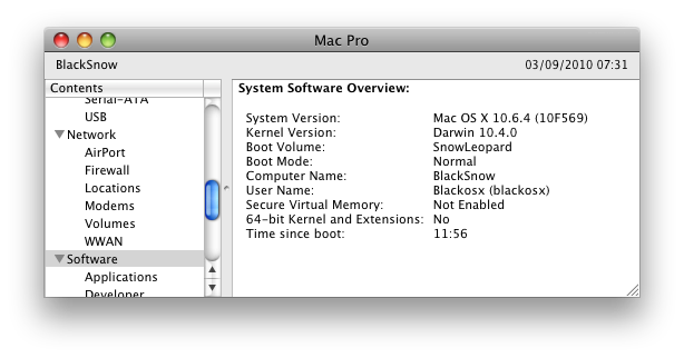

blackosx Posted September 3, 2010 Author Share Posted September 3, 2010 Hi geithals Wow.. I see your video quest has sent you an a journey... But well done with your research and thanks for posting the update for the problem here. The link you posted for the 8800GT ROM shows two available options, EFI32 and EFI64. Which one did you select? and also, your system profiler readout reads 1024MB though both ROMS on the link state 512MB. I take it this hasn't caused you any issue? I have played with loading an alternative VBIOS with Chameleon in the past, but never had a real need to change anything on my setup so it never went past playing. But it's good to know it works and thanks for sharing Though some of us with external sound cards can still claim to be 'Pure Vanilla'.. Lol.. good point.. Maybe I could look at that option? I remember reading some previous posts in the past about different USB solutions etc. but back then I had no issue with enabling audio through DSDT and LegacyHDA in /Extra/Extensions. But since Apple have dropped support for ALC888 maybe it's time for me to reconsider?. I only use stereo sound out to my cheap speakers.. Which option do you recommend and which option did you go with ? But now i have strange problem, system Was always working in 64bit mode, but now i need to run it in 32bit mode, and i cant. I changed boot.plist (both just for sure) to i386, delete all keys about 64bit. And its always boot up in 64bit kernel and kexts mode. Any idea how to force him to 32bit? Use the following boot option in the /Extra/com.apple.Boot.plist <key>arch</key> <string>i386</string> Then after reboot you will see the 64-bit kernel and extensions reads 'No' in the software selection on System Profiler as in the attached screenshot. Link to comment Share on other sites More sharing options...
geithals Posted September 3, 2010 Share Posted September 3, 2010 The link you posted for the 8800GT ROM shows two available options, EFI32 and EFI64. Which one did you select? Hi Blackosx, I saw 2 choices, rev1 and rev2. I only used rev 1, this exact download link and also, your system profiler readout reads 1024MB though both ROMS on the link state 512MB. I take it this hasn't caused you any issue? It was "upgraded" from 512mb to 1024gb by syst profile before this, from the time I installed OS10.6.0. No issues with that, not that I notice. I have played with loading an alternative VBIOS with Chameleon in the past, but never had a real need to change anything on my setup so it never went past playing. But it's good to know it works and thanks for sharing It is a big enough issue but may well be resolved in the next OS update, so keep holding your horses on making changes. The elegance of this Vanilla install, is that changes I made for me, are easy to control and reverse. Lol.. good point.. Maybe I could look at that option? I remember reading some previous posts in the past about different USB solutions etc. but back then I had no issue with enabling audio through DSDT and LegacyHDA in /Extra/Extensions. But since Apple have dropped support for ALC888 maybe it's time for me to reconsider?. I only use stereo sound out to my cheap speakers.. Which option do you recommend and which option did you go with ? Cheap speakers? we can tolerate the odd cheap beer, sometimes even a cheap woman but cheap speakers?? For some of my needs - recording lectures with clarity on a MBP - meant that a Focusrite saffire, firewire powered external box was emminently suitable. One of the most sensible devices I have ever bought. At home it is the pre amp hub for clear digital and clear analogue sound out of the computer. For basic USB powered, clear, uncluttered analogue sound, probably I would go German, this one by Behringer sells for USD33. When it comes to sound, re speakers/amps/headphones/construction quality etc, Germans do it good and Behringer are in the 'sound' zone. Link to comment Share on other sites More sharing options...

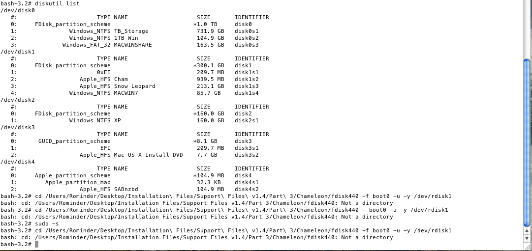

rimmi2002 Posted September 4, 2010 Share Posted September 4, 2010 My GUID Paritition converted into a Fdisk parition. I had a perfect working retail install of Snow Leopard and Win7. I have reinstalled Win 7 multiple times and had to do it one more time. I did it and used by USB stick to boot into OSX to restore chameleon as boot loader. In the past it has never been a problem. Now however the chameleon instructions were not working. I noticed that my MAC DISK is no longer GUID Parition. It is now Fdisk? How did it loose it's GUID TABLE? Attached below is a screen shot from diskutility with my attempt at using fdisk440 and it failing. OSX disk is Disk 1.Please advise if there is any way to reverse this. THanks. About the only thing I did different this time compared to last time was that I installed Acronisc true image back up home plus on win7 and made a copy of the my win7 parition. I am not sure if that messed things up or something else, but I am not sure how a GUID parition changed to a Fdisk. Makes no sense to me. Any help will be appreciated. tHanks. Link to comment Share on other sites More sharing options...
blackosx Posted September 4, 2010 Author Share Posted September 4, 2010 Hi Blackosx,I saw 2 choices, rev1 and rev2. I only used rev 1, this exact download link Hi geithals Thanks for confirming your choice of VBIOS. As you said previously, it could help somebody with the same issue. It is a big enough issue but may well be resolved in the next OS update, so keep holding your horses on making changes.The elegance of this Vanilla install, is that changes I made for me, are easy to control and reverse. Lol. I am going away for a week in a couple of days time so no worries with me making any changes here. And yes, the OS X install for our boards is so easy now that we only need a handful of files to go from PC to Mac Cheap speakers? we can tolerate the odd cheap beer, sometimes even a cheap woman but cheap speakers??For some of my needs - recording lectures with clarity on a MBP - meant that a Focusrite saffire, firewire powered external box was emminently suitable. One of the most sensible devices I have ever bought. ../snip/.. For basic USB powered, clear, uncluttered analogue sound, probably I would go German, this one by Behringer sells for USD33. Lol.. Thanks for the advice. I have my main audio kit downstairs so am therefore happy with simple cheap sound on my hack - and the quality I get from the motherboards' on-board audio is perfect for me. So I can use it as food for thought over the next few weeks and see what I decide to do. +1 for external sound cards. Moves from system to system and is plug and play =). You can get usb sound cards under $5, that just work. In terms of quality, I'd say they're about equal to onboard sound. I use them for cheaper builds =P. Thanks Enzo - that might be more in line with what I'm thinking. Success with GA-P35-DS3L and retail 10.6.3 USB install...Thanks a bunch! Good news jabaman - well done and thanks for reporting back My GUID Paritition converted into a Fdisk parition. I had a perfect working retail install of Snow Leopard and Win7. I have reinstalled Win 7 multiple times and had to do it one more time. I did it and used by USB stick to boot into OSX to restore chameleon as boot loader. In the past it has never been a problem. Now however the chameleon instructions were not working. I noticed that my MAC DISK is no longer GUID Parition. It is now Fdisk? How did it loose it's GUID TABLE? Attached below is a screen shot from diskutility with my attempt at using fdisk440 and it failing. OSX disk is Disk 1.Please advise if there is any way to reverse this. THanks. About the only thing I did different this time compared to last time was that I installed Acronisc true image back up home plus on win7 and made a copy of the my win7 parition. I am not sure if that messed things up or something else, but I am not sure how a GUID parition changed to a Fdisk. Makes no sense to me. Hi rimmi2002 I've never come across that issue and I guess it must be something that occured when using Acronis. As for reversing the process, well if it can be done that's for somebody more knowledgable than me to answer. Sorry. But I think you can still run your system from an MBR formatted drive, and you should still be able to install Chameleon to it. I just haven't done it so I can't talk from experience. Looking at your screenshot, try CD'ing to the 'Chameleon' directory in the support files and not to fdisk440, as fdisk440 is not a directory. Link to comment Share on other sites More sharing options...

rimmi2002 Posted September 8, 2010 Share Posted September 8, 2010 My GUID Paritition converted into a Fdisk parition. I had a perfect working retail install of Snow Leopard and Win7. I have reinstalled Win 7 multiple times and had to do it one more time. I did it and used by USB stick to boot into OSX to restore chameleon as boot loader. In the past it has never been a problem. Now however the chameleon instructions were not working. I noticed that my MAC DISK is no longer GUID Parition. It is now Fdisk? How did it loose it's GUID TABLE? Attached below is a screen shot from diskutility with my attempt at using fdisk440 and it failing. OSX disk is Disk 1.Please advise if there is any way to reverse this. THanks. About the only thing I did different this time compared to last time was that I installed Acronisc true image back up home plus on win7 and made a copy of the my win7 parition. I am not sure if that messed things up or something else, but I am not sure how a GUID parition changed to a Fdisk. Makes no sense to me. Any help will be appreciated. tHanks. Alrite got my solution using these two posts. Thought I'd post it incase anyone else has the same problem. A real odd-ball problem. I'd say avoid acronis backup software of GPT disks. http://forum.voodooprojects.org/index.php/topic,1593.0.html http://www.insanelymac.com/forum/index.php?showtopic=231025 Link to comment Share on other sites More sharing options...
