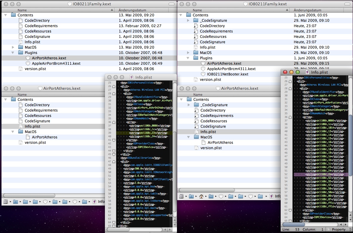

The Mac Ace Posted October 13, 2009 Share Posted October 13, 2009 Hey all, is there any update on the gobi wwan drivers for us american vaio p users with the VZ card? Alex Atheros 928x (AR928x) driver in Snow Leopard 104380?Look what I've found with a friend of mine <string>pci168c,2a</string> = 168C 002A leopard 10.5.7 kext on the left side - snow leopard kext 10a380 on the right UPDATE: WEEEEE 3g's working now - at least for european vaio p users! just download "GlobeTrotter� Connect For Mac" from http://www.option.com/en/support/software-...modems/icon225/ install the software and that's it Link to comment Share on other sites More sharing options...
