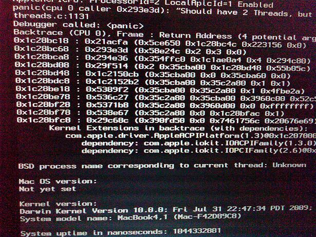

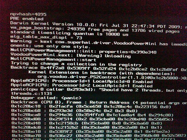

thangbinh Posted November 22, 2009 Share Posted November 22, 2009 Hello. I was try this on my Asus 1101ha it same chipset and cpu with Vaio P, but it not works. Here the log while i use -v. I was success install SL on my PC (Core i7, X58 chipset), and my Laptop G50-a2 so i really want it work on my Netbook. Hope you can help me. Thanks. Sorry about my bad english. Link to comment Share on other sites More sharing options...
beermacht Posted November 22, 2009 Share Posted November 22, 2009 i'm not the ultimate freak - but as far as i can see is there aproblem with the cpu - the vaio has one core and the setup searches 2 Link to comment Share on other sites More sharing options...
macpsp Posted November 22, 2009 Share Posted November 22, 2009 @thangbinh Try to use the following boot option for the installation: -v cpus=1 Link to comment Share on other sites More sharing options...
mickeyboy Posted November 23, 2009 Share Posted November 23, 2009 i was try : -v -f cpus=1 -v cpus=1 but still not work. Thanks about your reply. Link to comment Share on other sites More sharing options...
ryuu123 Posted November 23, 2009 Author Share Posted November 23, 2009 i was try : -v -f cpus=1 -v cpus=1 but still not work. Thanks about your reply. Change BIOS setting to enable HyperThreading. or remove /DSDT.aml and create your own. To get raw DSDT, you can use linux/windows. Link to comment Share on other sites More sharing options...

thangbinh Posted November 24, 2009 Share Posted November 24, 2009 I was make my own dsdt.aml and it work perfectly in Asus 1101HA, sound, bluetooth, wifi(replace one),time machine, Battery show percent but still said need replace. but native resolution 1366x768. hope anyone can help, need any info pls tell me. Thanks. Link to comment Share on other sites More sharing options...
