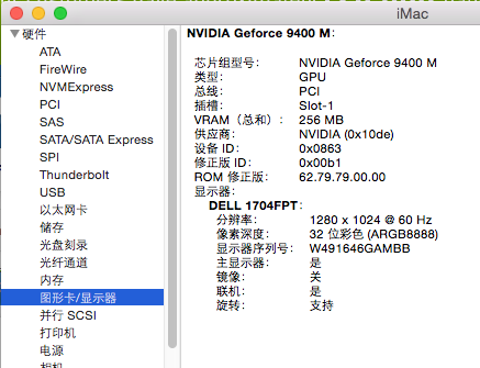

I finally have built-in graphics working using the kexts from post 795 (linked off first post), here's what I've copied
cd /System/Library/Extensions/AppleGraphicsPowerManagement.kext/Contents/
cp Info.plist Info.plist.org
cp /Users/yozik/Downloads/10.8.2SLEEP/System/Library/Extensions/AppleGraphicsPowerManagement.kext/Contents/Info.plist .
cd /Library/Extensions/
cp -R /Users/yozik/Downloads/10.8.2SLEEP/System/Library/Extensions/_OverrideNVDA* .
cp -R /Users/yozik/Downloads/10.8.2SLEEP/System/Library/Extensions/Natit.kext .
I also installed the nvidia web driver from nvidia's website - 346.03.04f02

Soo, I managed to install 10.12 on this board with the onboard graphics card. I screwed up my sound a while ago (physically), probably by using a wrong voodoo patch on 10.6.8 for years. I now have sound through airplay, bluetooth and a usb sound card ordered for less than €1. Everything else seems to work just fine. Here's what I did:
  • I installed mac os sierra on a hard drive with an other working computer (old 2,5inch drive with a legit macbook in my case)
  • I ran m*litib*ast on that drive, selecting legacy boot, inject Nvidia
  • I copied the files from mail_hxm (thanks for sharing) in post #843 to the efi drive EFI/CLOVER, except the config.plist file. System wouldn't boot with his config.plist. Probably because no nvidia injection. Someone could try to add that but I choose the easiest way
  • Put the hard drive in the zotac machine, boot from that drive, everything works for me (except the build in wifi, but that never worked for me)
Edit: my dad updated this machine by accident. I get a screen with a mouse cursor only and it blinks when pressing some keys. I don't know why but it's supposed to show the login screen but it doesn't show. So after updating and rebooting you get a weird screen with cursor only. Just type your password and press enter and you have your screen back. So it even updates sort of fine.
Edit 2: after weeks of trial and error (and waiting for sata to usb cable) I finally figured something out. I was unable to start from my terabyte drive although I exactly duplicated the steps from the drive that I can boot from. Finally found the solution for al this misserie. I had to switch the sata ports...
So if anyone ecounters weird booting problems. Try a different sata port
