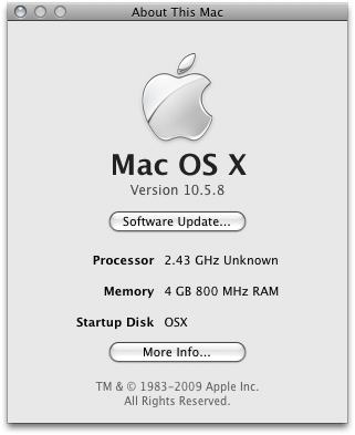

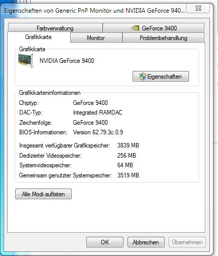

 After several tries, I found my missing 256m, about 0xb0000000 ~ 0xc0000000.  I uploaded another version of Chameleon which open that area in memory map.
In 512m mode, BIOS will reserve mems 0xa0000000 ~ 0xc0000000.  That will make us lose 512m !!! mems.  I haven't find a way to do both of 2 modes by one code.  Help me, any idea is welcome.
The "missing" mems is reserved for "TurboCache", probably, which only works with nvidia driver in win.  We won't be able to us them in osx (or linux, i think) if we don't open then explicitly.  I really come to hate TurboCache: Does using twice of main memory for an on-board gfx have any sense?  It's much easier to me to have more value options in gmem VRAM setting in BIOS.

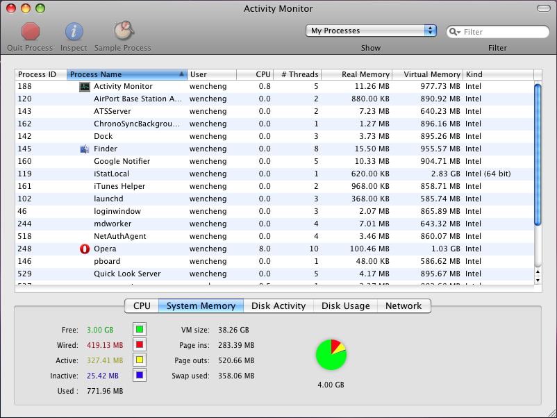

Right now I am using 8 gigs of ram and all seems well.
