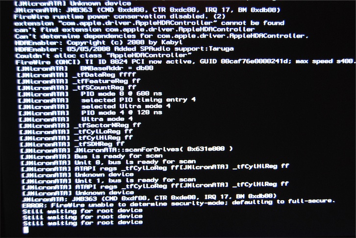

Hi guys,
First thanks to DD for his labour. ;)
I finally got my rig working.
Gigabyte x58 UD5
i7 920 2.66
Sapphire HD 4890 Vapor-X
OCZ 1333 CL7 3x2GB
Does not mean OSX is at all.
At the moment I have done all steps and everything boots but gets stuck at Apple logo screen then a forbidden sign appears...
Does anyone know what that is? DD?
Thanks in advance.
Hey guys I have attached of what in verbose mode says. Still waiting for root device!.
There are some other errors above that.
Any ideas?
Looks like the installed kexts have loaded from the Extra folder, but the BIOS cannot find the rest of the system/partition. Is this a EFI install?
Do you have AHCI enabled in the BIOS?
MAJ
EDIT: Make sure the partition you want to boot is made "active."
