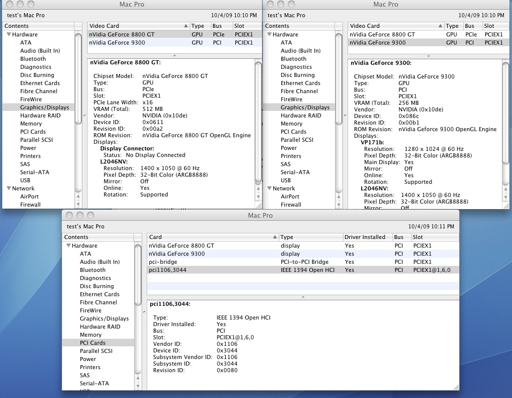

ok, even MORE progress
I successfully have 2 Video cards running via DSDT injection! Quad monitor baby! Too bad I only have 2 at the moment...
Still getting KP with AppleHDA after editing some DSDT, will have to probably edit my AppleHDA
And kind of a work around with the KB thing, I've got it attached to a powered hub, which works fine. Not ideal, but fine for now. I think I'll get a small non-powered hub in the near future.

@mumford - YES! Both VGA and HDMI work together
Anywho, I'm going to post my DSDT and modified vanilla AppleHDA
Regarding the DSDT and audio injection - Pin configurations are NOT needed, not much at all is. You'll see from the DSDT. It's based off of the one in post 819 (I think...)
Video was a bit more tricky to figure out, but wasn't too hard. Under XVR0 (zero), there was another entry, XVS0 (zero). So what you need to do is change XVS0 (zero) to GFX0 (zero) and add the rest of the info as needed (see DSDTSE.app if you're not sure what to inject).
If you don't want to inject an additional video card, the only thing that's changed is how audio is injected (No pin configs or other not needed info). If you want to only use this for the audio, then change GFX0 to XVS0 (zero) and delete down to Device (XVR1)
Forgot to add that all PCI cards will be seen under System profiler, including the 9300.
Also forgot to mention that I specified 256MB of Video Ram for the 9300 in the DSDT.

With this DSDT, you can also use just the PCIe video card, deactivating the 9300, just make sure that it's specified in the Bios to have 256 MB of RAM (whilst being disabled). I got 2 random freeze ups that haven't happened again after I set it to 256, despite being disabled. The RAM is freed appropriately though, as you can see during BIOS initialization.
