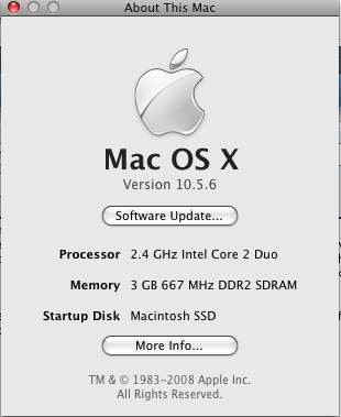

cairb21 Posted April 14, 2009 Share Posted April 14, 2009 So I got the T5550 I was waiting for, and made some tests. It works perfectly on the laptop and is of course better than the one core celeron I had before. Unfortunately it didn't solve my memory issue, 4gb still doesn't work for me, so I guess it has nothing to do with the type of processor. While dismantling the cooling system, I noticed that the thermal paste which was on the chipset seemed kind of weird, as it was solid, whereas the one on the processor which I had to renew was normal (white grease). Maybe that is causing the issue ? I'm not sure if the chipset is correctly cooled, but as I wasn't sure I prefered to let it the way it was. I'm going to try Windows 7 x64, certainly more reliable than ubuntu, on the laptop to check if 4 gigs of memory work in it or if it's an issue I only get in os X. By the way I was wondering, are you people who are using 4 gigs of memory on the laptop using normal Leopard, or Snow Leopard ? Because I'm a bit surprised a 32 bit os is able to handle such an amount of memory ? Link to comment https://www.insanelymac.com/forum/topic/146032-s20s20ii-laptops-hasee-advent-haier/page/2/#findComment-1132350 Share on other sites More sharing options...
cairb21 Posted April 14, 2009 Share Posted April 14, 2009 No it has nothing to do with how you install mac osx. Mayby we need mac memories? I have tried with 2 different processors of the core2duo merom family, still the same issue with 4 gigs of ram. I know nothing about dos and dont understand how to install the 1.04 bios?? No, one of the memory types I tried was designed for macs (g-skill brand), and it didn't solve the issue. I'm beginning to wonder if there isn't a difference in the way the memory system is built on some of these laptops ... There are certainly other ways to install the bios, but here is what you can do : - download a windows millenium boot disk here and burn it on a blank cd (you can do it with disk utility for example). - Burn the three files given for the 1.04 bios update on the root of another cd (autoexec.bat, bios.wph, plash16.exe). - Insert the windows millenium boot disk in your dvd drive and restart the laptop. - You should be prompted to boot from cd or hard disk, chose boot from cd - Then you should be prompted to enable cd drive or not, chose to enable it - Once Dos is fully loaded (it should display A:\ or C:\, I'm not sure) remove windows millenium boot disk and insert the cd on which you burned the bios files. - Type d: and press ENTER, this should get you to your cd drive. - Type autoexec and press ENTER, this should launch the bios update utility. Note: If you had a bios.bat file and not an autoexec.bat one, type bios, or anything the .bat file is called, and press ENTER. If you are not sure of the file names you can type dir and press ENTER to list the files of the directory you are in. This method enables you only to update your bios, it doesn't allow it to be backed up as the sata hard drive is not recognized. Link to comment https://www.insanelymac.com/forum/topic/146032-s20s20ii-laptops-hasee-advent-haier/page/2/#findComment-1132376 Share on other sites More sharing options...
Daniel Gustavsson Posted April 14, 2009 Share Posted April 14, 2009 So I got the T5550 I was waiting for, and made some tests. It works perfectly on the laptop and is of course better than the one core celeron I had before. Unfortunately it didn't solve my memory issue, 4gb still doesn't work for me, so I guess it has nothing to do with the type of processor. While dismantling the cooling system, I noticed that the thermal paste which was on the chipset seemed kind of weird, as it was solid, whereas the one on the processor which I had to renew was normal (white grease). Maybe that is causing the issue ? I'm not sure if the chipset is correctly cooled, but as I wasn't sure I prefered to let it the way it was.I'm going to try Windows 7 x64, certainly more reliable than ubuntu, on the laptop to check if 4 gigs of memory work in it or if it's an issue I only get in os X. By the way I was wondering, are you people who are using 4 gigs of memory on the laptop using normal Leopard, or Snow Leopard ? Because I'm a bit surprised a 32 bit os is able to handle such an amount of memory ? Ok! I got the same solid paste on my chipset, im gonna try the white stuff for the gpu as well and see if it runs cooler. No, one of the memory types I tried was designed for macs (g-skill brand), and it didn't solve the issue.I'm beginning to wonder if there isn't a difference in the way the memory system is built on some of these laptops ... There are certainly other ways to install the bios, but here is what you can do : - download a windows millenium boot disk here and burn it on a blank cd (you can do it with disk utility for example). - Burn the three files given for the 1.04 bios update on the root of another cd (autoexec.bat, bios.wph, plash16.exe). - Insert the windows millenium boot disk in your dvd drive and restart the laptop. - You should be prompted to boot from cd or hard disk, chose boot from cd - Then you should be prompted to enable cd drive or not, chose to enable it - Once Dos is fully loaded (it should display A:\ or C:\, I'm not sure) remove windows millenium boot disk and insert the cd on which you burned the bios files. - Type d: and press ENTER, this should get you to your cd drive. - Type autoexec and press ENTER, this should launch the bios update utility. Note: If you had a bios.bat file and not an autoexec.bat one, type bios, or anything the .bat file is called, and press ENTER. If you are not sure of the file names you can type dir and press ENTER to list the files of the directory you are in. This method enables you only to update your bios, it doesn't allow it to be backed up as the sata hard drive is not recognized. Thank you i try the bios update right now!! Link to comment https://www.insanelymac.com/forum/topic/146032-s20s20ii-laptops-hasee-advent-haier/page/2/#findComment-1132409 Share on other sites More sharing options...
