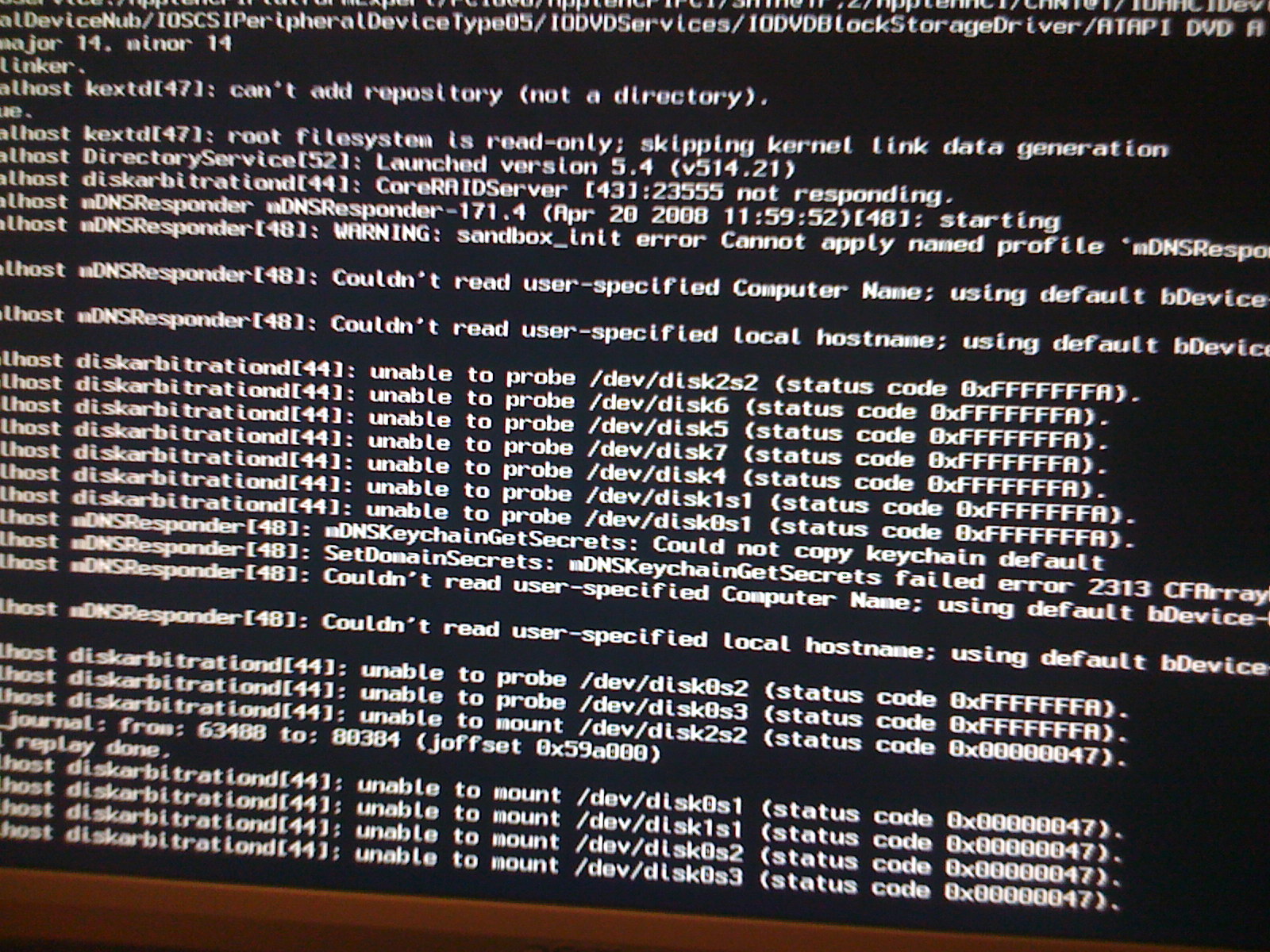

Thank you ... That really really resolved my shut down issues ...
Now i have the problem with the one 8gb hdd that i don't know where appeared ...
Is there, i can't do nothing to it, no delete, erase or unmount ...
I will attach a picture to see what i mean ...
If only somebody could help me ...
Please ;)

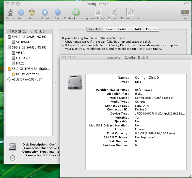

Hello dear Robert ...
Your guide as i sayd earlier, worked perfect for me...
One issue though ...
Even though i have 2 x 650 Gb hdd Samsung and 1 x external HDD 60 GB toshiba, in the disk utilities it shows another 8 gb hdd, and every time mac boots it shows me this annoing error that it can't mount the 8GB hadd ... And i have to press ignore every time ...
What to do please ?
I am attaching a picture to this post, so you will better understand what i mean ...
Please help me with this issue !

Boot using Gparted and see if that Partition is showing up... in Gparted...
I booted up with gparted, and yes it shows up, but i repeat, not as a partition but as a hole other disk ...
It shows up as a 8 gb HDD ...
What to do ?
You can delete the partition in which you have restored your image now after the installation............
Look's like now it works ...
The problem was not with my hdd or with the OSx ... but in my BIOS ...
I had Drive Xpert Control option Enabled ... Now i disabled that, and all my problems are off :hysterical:
