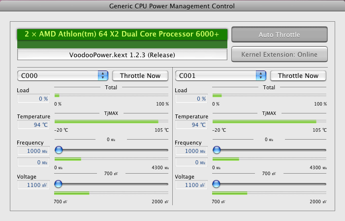

Yes, but how do I solve this so that my CPU would stay cool and quiet :) fan runs ±2600rpm cpu temp - 50 degrees. What do you use? Or maybe you just put up with the noise?
I've installed this version http://www.insanelymac.com/forum/index.php...898&st=150# but the system it's running very slow.
Only when i run more program's the frequency of processor it's going up.
I can not adjust the frequency from GenericCPUPMControl. They stay at 1000Mhz.
Sorry for my bad english.

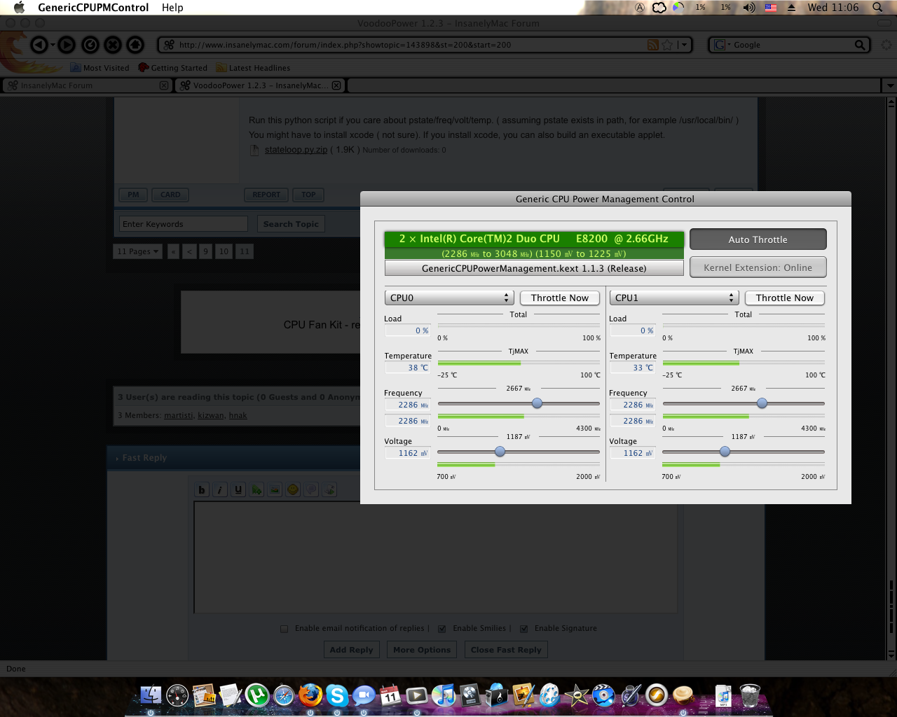

How to make GenericCPU... to work with voodoopower? By clicking in the window it changes only 5 times and there is no voodoo power
You use both GenericCPUPowerManagement and VoodooPower?
Remove GenericCPUPowerManagement.kext + Extensions cache...

Hey Hnak, Thanks again for the fixed. So; I've installed the AMD K8 (only) VoodoPower.kext (1.2.3 + patch) + mach_kernel (voodoo 9.5.0 + patch) on my AMD Turion Tl-64 . The only problem I've having right now is when I adjust the pstate to either 3,2,1,0 my fan starts to run constantly. But when I have it on 4 (the fan is somewhat quiet) or on auto the fan can auto throttle by itself (and adjust to how heavy I''m using the system). I don't want to burn out my fan (by always putting it on pstate 0 )but I also want to watch movie and I don't want to manually adjust the pstate to 0 everytime i want to watch a movie and change it back to auto in order to get good sound (without the jittering). So my final question is, is there anyway to get my fan quiet or autothrottle (or at least make my fan quiet down) when I set pstate to 0 in order to watch movies or any type of media without the jittering audio? I've tried to delete all the cputhermal.kext intelcpumanagement.kext and thermalcpu.kext but it doesn't see to work.
No way.
Fan is tied to MB hardware and we have no control on it. (At least, you need to write a driver for you own hardware )
Fan must work at pstate 0 to avoid burning CPU anyway.
As audio jittering is caused by TSC change, you need to fix it at some state in case of non constant TSC processor.
No way.
