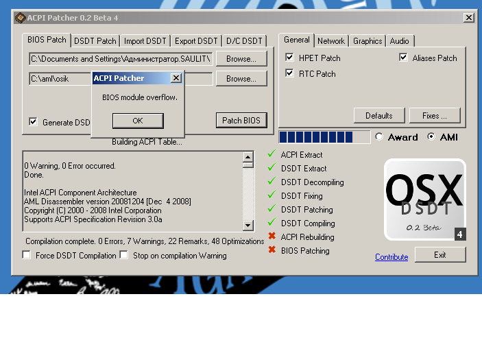

koalala Posted January 20, 2009 Author Share Posted January 20, 2009 AMI BIOS support is partial, you can only patcher HPET, RTC and Aliases. (You should be able to patch GIGE Network in 0.2RC1 but there isn't enough place in 1B module to patch more things.). That's why there is an overflow error. I think there is a way to put DSDT out of the 1B module but I don't know how. For MSI Wind, nobody has succeded in modifying BIOS, use DSDT.aml instead. Link to comment Share on other sites More sharing options...
