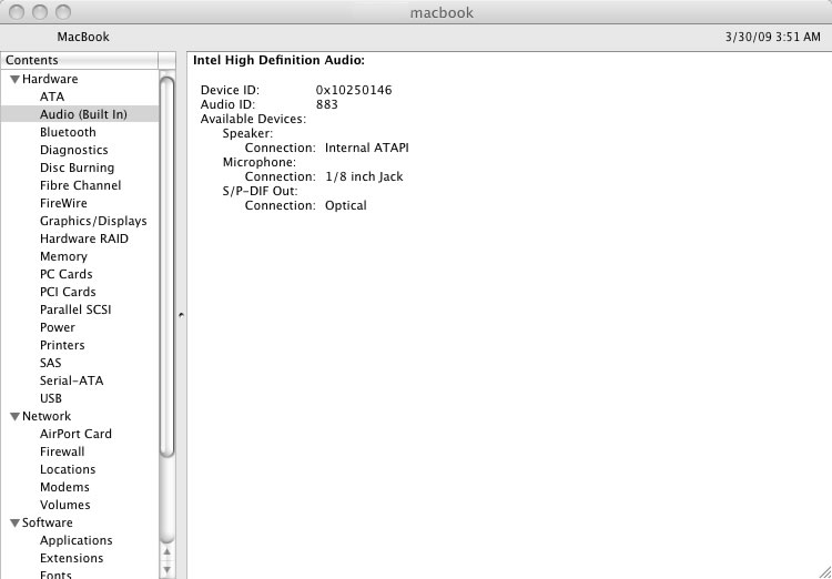

DPyro Posted April 1, 2009 Share Posted April 1, 2009 I already tried everything you posted. I came to the conclusion that we need to dev our own AppleHDA driver. With the help of Kizwan, I have gotten to the point where the only devices that don't work are the internal speaker and headphones. Everything else works: Internal Mic External Mic Line In Digital Out I will post the latest kext for you to try. Place Extensions.mkext (use mkext tool) in /Extra folder with the vanilla AppleHDA installed to s/l/e. You'll need PC_EFI9 installed to use the /Extras folder. You can install it using Universal OSx86 Installer. ALC889_04.01.2009.rar Link to comment Share on other sites More sharing options...

DPyro Posted April 1, 2009 Share Posted April 1, 2009 As far as I know, the verbs are fine. We need to find out if the pins for speakers and headphones are correct, and if changing the MuteGPIO values helps. EDIT: Indeed, the pins for speakers and headphones are not correct. I've managed to get both working, but not at the same time! More to come! Link to comment Share on other sites More sharing options...
DPyro Posted April 2, 2009 Share Posted April 2, 2009 Alright people, here it is! The long awaited ALC889 audio driver is here! Everything is working, including auto-detect with headphones. I will be looking into adding auto-detect for Spdif out. Note that there's a duplicate entry for Internal speakers, I haven't figured out how to remove that yet. Also, be aware you may need to boot into windows first to get the driver to work. However I'm not positive you will, I've just encountered problems where it works and then doesn't work while I was developing it. Thanks goes out to tmongkol for the windows dev tools, coconup for the original kext, and Kizwan who made this all happen. Let me know if you find any problems with the kext. Use the same instructions as in my previous post. ALC889_04.01.2009_R2.zip Link to comment Share on other sites More sharing options...
