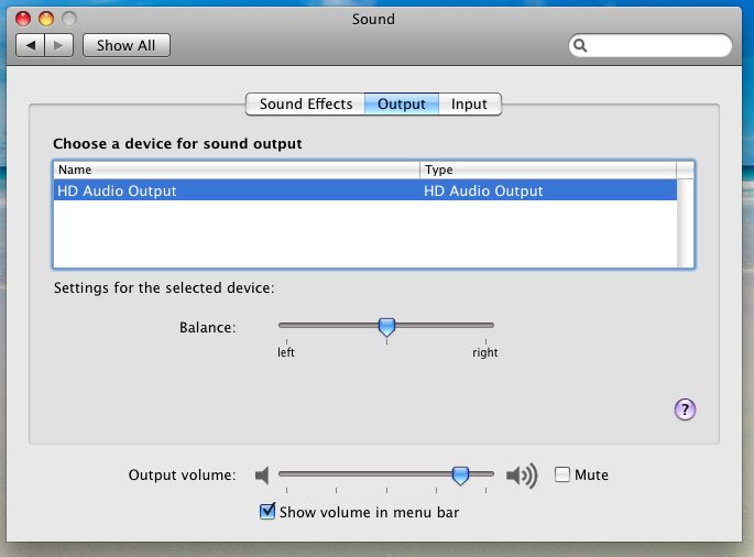

winktinkler Posted February 21, 2009 Share Posted February 21, 2009 tmongkol tried to attach this post 126 above in reply to you see attached KEXTs being used ... (ones you suggested yesterday or day before ) see screen grabs inside attached file also using Mac Grab utilty prog Now, when I check the devices and controls, I get POP's out of the Line Out in rear via my ext speakers, but the System Settings Audio which is selected is 'Internal Speaker' 'Built In Output' ... I get Pops when I empty Trash, or when I copy paste, or change the volume slider (sometimes...) .... I get no other sounds at all with other settings.. OK here is attached file(s) - Kexts_in_use___Screen_Grabs.zip 1. in the HDAEnabler.kext .... what determines the Pinconfig values ? pasted here from the kext in use (your suggestion 2 days ago) Pincofig field from hdenabler suggested by tmongkol in 1.6.xxxx post for alc888 1090A090 2090A102 80308101 90402102 30401101 40100101 50600101 60200101 70614B01 A001CB01 I have tried How To Pinconfig tutorial several times but not able to finish ... I am also attaching the Windows Vista registry fields, before conversion using Diabolik, and after conversion I am also including in same attachment my Linux Dump with working audio ... Archive.zip And the specific Windows Vista registry portion I used to generate the values using Diabolik HDA verb converter Archive1.zip I think I am close ... as per my explanation on prior post ... Thanks for help ... Link to comment https://www.insanelymac.com/forum/topic/140941-alc889a-gigabyte-intel-now-having-a-working-front-mic/page/6/#findComment-1086962 Share on other sites More sharing options...
VCH888 Posted February 21, 2009 Author Share Posted February 21, 2009 tmongkol tried to attach this post 126 above in reply to you see attached KEXTs being used ... (ones you suggested yesterday or day before ) see screen grabs inside attached file also using Mac Grab utilty prog Now, when I check the devices and controls, I get POP's out of the Line Out in rear via my ext speakers, but the System Settings Audio which is selected is 'Internal Speaker' 'Built In Output' ... I get Pops when I empty Trash, or when I copy paste, or change the volume slider (sometimes...) .... I get no other sounds at all with other settings.. OK here is attached file(s) - Kexts_in_use___Screen_Grabs.zip 1. in the HDAEnabler.kext .... what determines the Pinconfig values ? pasted here from the kext in use (your suggestion 2 days ago) Pincofig field from hdenabler suggested by tmongkol in 1.6.xxxx post for alc888 1090A090 2090A102 80308101 90402102 30401101 40100101 50600101 60200101 70614B01 A001CB01 I have tried How To Pinconfig tutorial several times but not able to finish ... I am also attaching the Windows Vista registry fields, before conversion using Diabolik, and after conversion I am also including in same attachment my Linux Dump with working audio ... Archive.zip And the specific Windows Vista registry portion I used to generate the values using Diabolik HDA verb converter Archive1.zip I think I am close ... as per my explanation on prior post ... Thanks for help ... @ winktinkler I will study your case and answer you tonight. (My local time now is 11.00 am.) Link to comment https://www.insanelymac.com/forum/topic/140941-alc889a-gigabyte-intel-now-having-a-working-front-mic/page/6/#findComment-1086969 Share on other sites More sharing options...

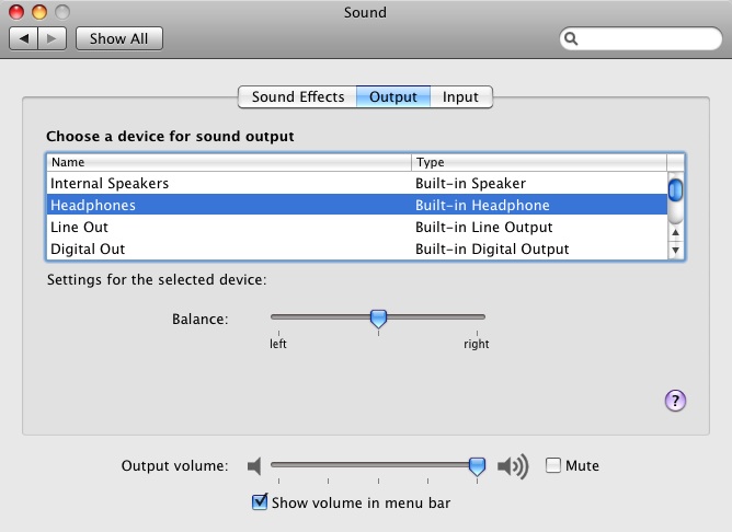

VCH888 Posted February 21, 2009 Author Share Posted February 21, 2009 @tmongkol Here is my ALC883 kexts. I hope you'll help me... @Whiplasher Can you get me your Codecdump and what your PC is? Can you use headphone if you are using Windows? Did you choose a device for sound output as a following picture? Can you listen to music when you are using such iTune? I have to ask you many questions. Link to comment https://www.insanelymac.com/forum/topic/140941-alc889a-gigabyte-intel-now-having-a-working-front-mic/page/6/#findComment-1087289 Share on other sites More sharing options...
VCH888 Posted February 21, 2009 Author Share Posted February 21, 2009 @winktinkler I looked at your pictures and it seemed to be working. I have questions. Can you hear any sound when you choose an alert sound? They are different sound. Do you know what Internal Codec and External Codec are? Like, Internal Codec is for Nvidia or Realtek. The manual didn't tell me anything. I tried Codecverbs that you edited as address 1 , and it could work on ALC889A (EP35-DS3P). Maybe you try to edit codecverbs as address 0. From your picture, your Device ID is 0x38421006. Your Subsystem ID is 0x10ec0000. My Device ID is 0x1458A002. Based on my ALC998A codecdump, Subsystem ID is 0x1458a002. --------------------------- Feb 20 09:50:27 erps-mac-pro kernel[0]: Sound assertion "0 != result" failed in "/SourceCache/AppleHDA/AppleHDA-162.1.37/AppleHDA/AppleHDACodecGeneric.cpp" at line 1128 goto handler Feb 20 09:50:27 erps-mac-pro kernel[0]: Sound assertion "0 != result" failed in "/SourceCache/AppleHDA/AppleHDA-162.1.37/AppleHDA/AppleHDADriver.cpp" at line 2791 goto Exit I have no idea and experience about these errors. So, I could not tell you what would be causes. -------------------------- Link to comment https://www.insanelymac.com/forum/topic/140941-alc889a-gigabyte-intel-now-having-a-working-front-mic/page/6/#findComment-1087348 Share on other sites More sharing options...

winktinkler Posted February 21, 2009 Share Posted February 21, 2009 @winktinkler I looked at your pictures and it seemed to be working. I have questions. Can you hear any sound when you choose an alert sound? They are different sound. NO 'real sounds' only POP's ...when alert happens or I move slider ... volume control Do you know what Internal Codec and External Codec are? Like, Internal Codec is for Nvidia or Realtek. The manual didn't tell me anything. I think External Codec must be 'Realtek' ( sound pops work with EXT codec chosen in BIOS via LIne Out on rear pc, but picture shows Internal Speaker chosen very few Suound assertion errors as per my last post showing those POP's do not work if INT codec chosen in BIOS with a lot of sound assertion errors showing, POP's work if BOTH INT and EXT codecs chosen in BIOS, with sum of both sound assertion error sets ... I tried Codecverbs that you edited as address 1 , and it could work on ALC889A (EP35-DS3P). Maybe you try to edit codecverbs as address 0. How do I do this? what edits ? where? From your picture, your Device ID is 0x38421006. Your Subsystem ID is 0x10ec0000. My Device ID is 0x1458A002. Based on my ALC998A codecdump, Subsystem ID is 0x1458a002. Should I edit my address into a plist file? which one? THANKS for this ... below pasted more 'concise' INFORMATION about my system, and Audio Codec files ... without you having to look thru the other files I sent before to find .... maybe will help you understand better ... PASTED SYSTEM INFORMATION ETC. BEGINS HERE ............ OR ATTACHED My_Hardware_Signature_Info.txt Motherboard Properties: Motherboard ID 10/03/2008-113-YW-E115-8A61QEV9C-00 Motherboard Name EVGA E115 Motherboard Properties: Motherboard ID 10/03/2008-113-YW-E115-8A61QEV9C-00 Motherboard Name EVGA E115 (3 PCI, 2 PCI-E x1, 1 PCI-E x16, 4 DDR2 DIMM, Audio, Video, Chipset Properties: Motherboard Chipset nVIDIA nForce 730 ------------------------------------------------------------------- Multimedia: SEE BELOW FOR MORE INFORMATION AUDIO PCI PnP at bottom Audio Adapter nVIDIA HDMI @ nVIDIA MCP79/7A - High Definition Audio Controller Audio Adapter Realtek ALC888/1200 @ nVIDIA MCP79/7A - High Definition Audio [ nVIDIA MCP79/7A - High Definition Audio Controller ] Hardware ID PCI\VEN_10DE&DEV_0AC0&SUBSYS_10063842&REV_B1 [ nVIDIA HDMI ] Hardware ID HDAUDIO\FUNC_01&VEN_10DE&DEV_0007&SUBSYS_10DE0101&REV_1001 [ Realtek ALC888/1200 ] Hardware ID HDAUDIO\FUNC_01&VEN_10EC&DEV_0888&SUBSYS_10EC0000&REV_1002 ----------------------------------------------------------------------------- CPU Type QuadCore Intel Core 2 Quad Q6700, 2666 MHz (10 x 267) Motherboard Name EVGA E115 (3 PCI, 2 PCI-E x1, 1 PCI-E x16, 4 DDR2 DIMM, Audio, Video, Gigabit LAN) Motherboard Chipset nVIDIA nForce 730i System Memory 3840 MB (DDR2-800 Video Adapter NVIDIA GeForce 8500 GT (1024 MB) Video Adapter NVIDIA GeForce 8500 GT (1024 MB) Video Adapter NVIDIA GeForce 9300 / nForce 730i (256 MB) Video Adapter NVIDIA GeForce 9300 / nForce 730i (256 MB) 3D Accelerator nVIDIA GeForce 8500 GT 3D Accelerator nVIDIA GeForce 9300 / nForce 730i -------------------------- Controller Storage: IDE Controller Standard Dual Channel PCI IDE Controller Storage Controller JMicron JMB36X --------------------------- BIOS Properties: System BIOS Date 10/03/08 Video BIOS Date 09/20/08 Award BIOS Type Phoenix - AwardBIOS v6.00PG Award BIOS Message Release Number IP7AUZ0W DMI BIOS Version 6.00 PG ---------------------------- Graphics Processor Properties: Video Adapter EVGA e-GeForce 8500 GT GPU Code Name G86GT (PCI Express 1.0 x16 10DE / 0421, Rev A2) GPU Clock (Geometric Domain) 513 MHz (original: 500 MHz, overclock: 3%) GPU Clock (Shader Domain) 1026 MHz (original: 1020 MHz) Memory Clock 399 MHz (original: 400 MHz) --------[ PCI / PnP Audio ]--------------------------------------------------------------------------------------------- nVIDIA HDMI @ nVIDIA MCP79/7A - High Definition Audio Controller PCI Realtek ALC888/1200 @ nVIDIA MCP79/7A - High Definition Audio Controller PCI --------[ HD Audio ]---------------------------------------------------------------------------------------------------- [ nVIDIA MCP79/7A - High Definition Audio Controller ] Device Properties: Device Description nVIDIA MCP79/7A - High Definition Audio Controller Device Description (Windows) High Definition Audio Controller Bus Type PCI Device ID 10DE-0AC0 Subsystem ID 3842-1006 Revision B1 Hardware ID PCI\VEN_10DE&DEV_0AC0&SUBSYS_10063842&REV_B1 [ nVIDIA HDMI ] Device Properties: Device Description nVIDIA HDMI Device Description (Windows) NVIDIA High Definition Audio Device Type Audio Bus Type HDAUDIO Device ID 10DE-0007 Subsystem ID 10DE-0101 Revision 1001 Hardware ID HDAUDIO\FUNC_01&VEN_10DE&DEV_0007&SUBSYS_10DE0101&REV_1001 [ Realtek ALC888/1200 ] Device Properties: Device Description Realtek ALC888/1200 Device Description (Windows) Realtek High Definition Audio Device Type Audio Bus Type HDAUDIO Device ID 10EC-0888 Subsystem ID 10EC-0000 Revision 1002 Hardware ID HDAUDIO\FUNC_01&VEN_10EC&DEV_0888&SUBSYS_10EC0000&REV_1002 Monitor Dell E152FP [15" LCD] (6418043B2KXH) --------------------------- Feb 20 09:50:27 erps-mac-pro kernel[0]: Sound assertion "0 != result" failed in "/SourceCache/AppleHDA/AppleHDA-162.1.37/AppleHDA/AppleHDACodecGeneric.cpp" at line 1128 goto handler Feb 20 09:50:27 erps-mac-pro kernel[0]: Sound assertion "0 != result" failed in "/SourceCache/AppleHDA/AppleHDA-162.1.37/AppleHDA/AppleHDADriver.cpp" at line 2791 goto Exit I have no idea and experience about these errors. So, I could not tell you what would be causes. -------------------------- Link to comment https://www.insanelymac.com/forum/topic/140941-alc889a-gigabyte-intel-now-having-a-working-front-mic/page/6/#findComment-1087403 Share on other sites More sharing options...

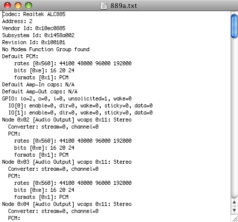

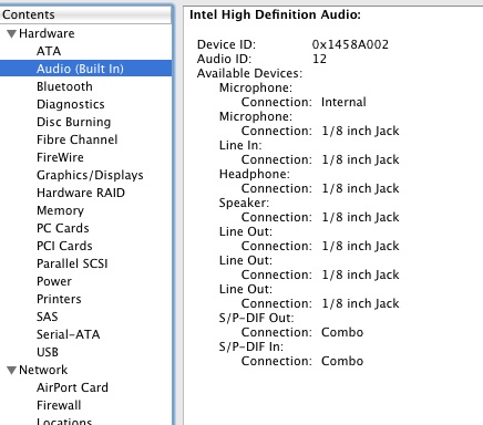

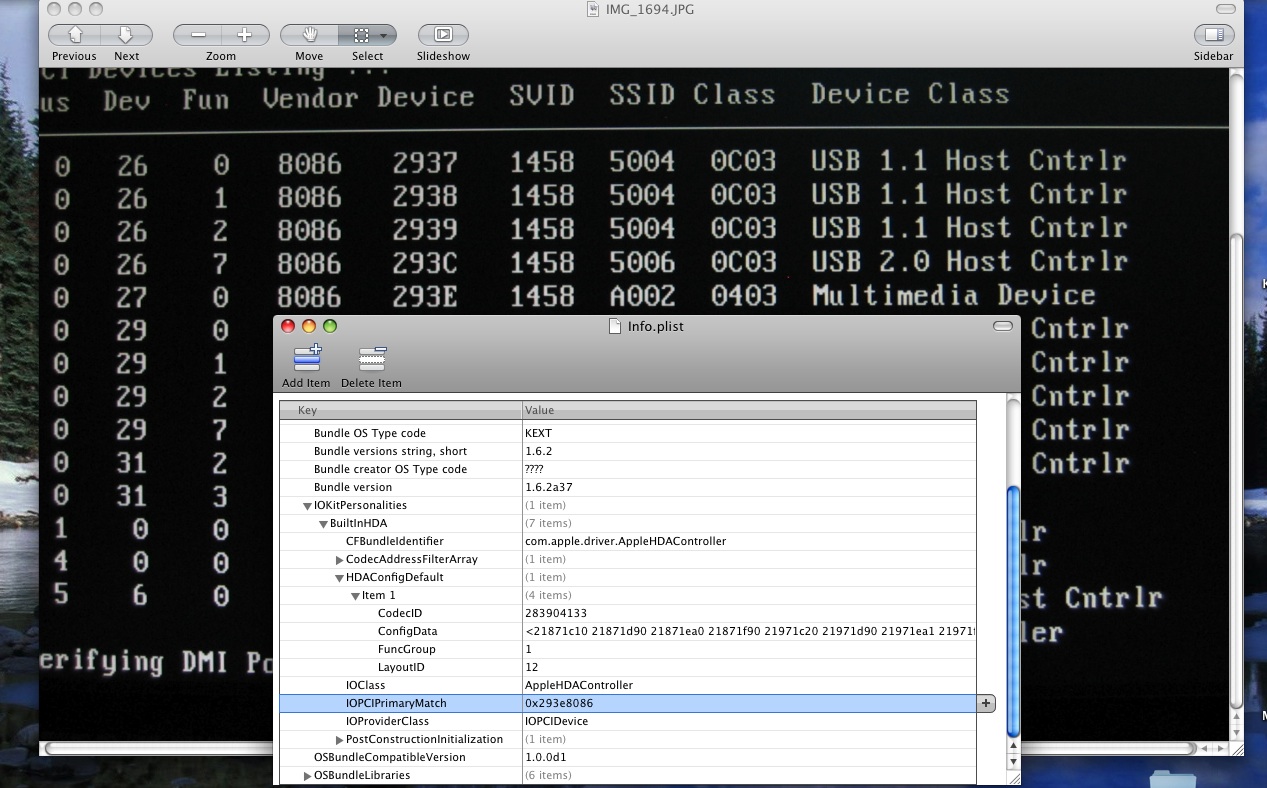

VCH888 Posted February 23, 2009 Author Share Posted February 23, 2009 @winktinkler When you're starting up your system, can you see like this picture? I would like to see if you can take a picture. As you see my EP35-DS3P, 8086 293E is HDA controller and 1458 A002 is Gigabyte audio id or device id in System Profiler. See a codecdump picture of 889A and sound profile. Link to comment https://www.insanelymac.com/forum/topic/140941-alc889a-gigabyte-intel-now-having-a-working-front-mic/page/6/#findComment-1089106 Share on other sites More sharing options...
Whiplasher Posted February 23, 2009 Share Posted February 23, 2009 @tmongkol No, i don't have anything like it in your first picture...Also in your third picture (System Profiler) i have this info in the "Audio (Built In)" section: No Built-in Audio. Actually, i have line out but it seems like he doesn't identify it at all... P.S- oh sorry, i thought you posted it to me Link to comment https://www.insanelymac.com/forum/topic/140941-alc889a-gigabyte-intel-now-having-a-working-front-mic/page/6/#findComment-1089114 Share on other sites More sharing options...

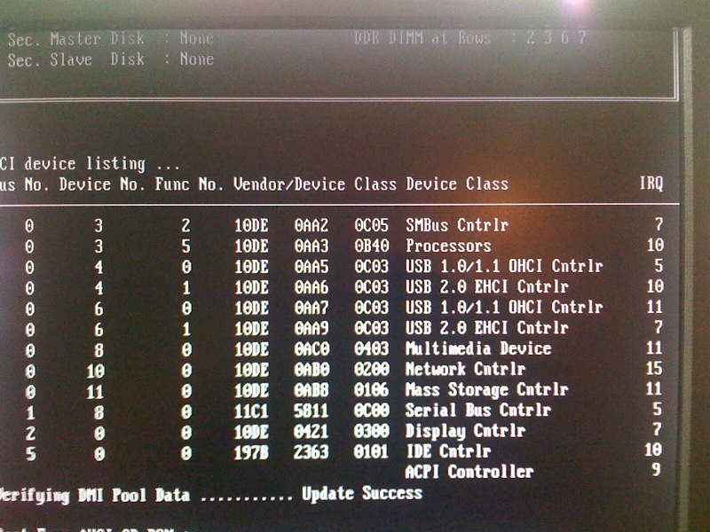

VCH888 Posted February 24, 2009 Author Share Posted February 24, 2009 @winktinkler Thank you posting your PCI Devices Listing. Your listing is different from Gigabyte. I also asked someone from the thread of Gigabyte's Nvidia 9400 ... to take a picture as shown below. 10DE 0AC0 is HDA controller id that is the same as you have. 1458 A102 is Gigabyte audio id that should be the same as Subsystem Id in Linux_Codec_Dump. But your system didn't show something like this. So, it's hard to get it done. I was thinking your system's going to be like this. Maybe I was wrong about this. 10DE 0AC0 ..........|__10063842 ..................|__10DE0101 ..................|__10EC0000 for Gigabyte 10DE 0AC0 ..........|__1458 A102 Link to comment https://www.insanelymac.com/forum/topic/140941-alc889a-gigabyte-intel-now-having-a-working-front-mic/page/6/#findComment-1089964 Share on other sites More sharing options...
